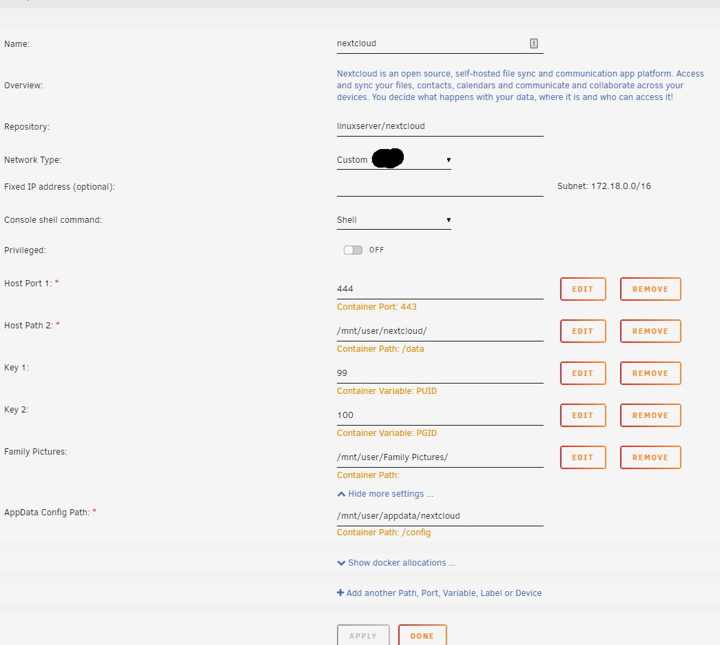

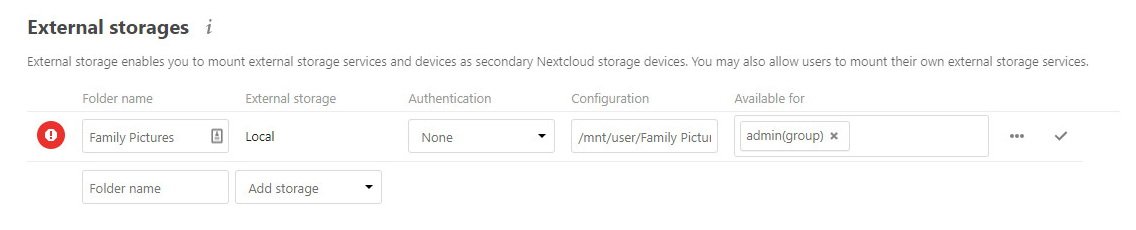

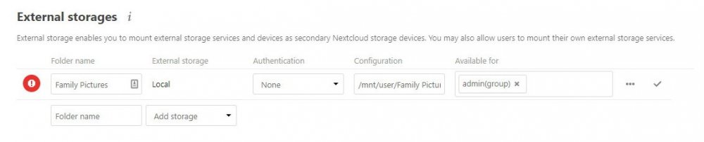

I tried to add a local unRaid share as an External Storage and keep getting stuck. Am I missing something? The Configuaration is: /mnt/user/Family Pictures
I think that I figured it out for both Local and SMB shares. Now, which should I use? Is there a difference how Nextcloud handles these?
Thanks.
Thanks.
I personally just add the SMB shares via external storages. This is so that the user permissions on each share gets respected.

So, I reinstalled the mariadb and nextcloud and cannot log into the dns unless I change the following line to include the port. Also, I do not see the SSL certificate anymore. No errors in the letsencrypt log, that I can see.
  'overwritehost' => 'mysite.duckdns.org:444',
