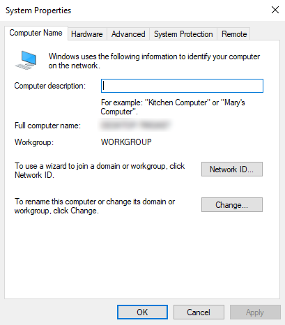

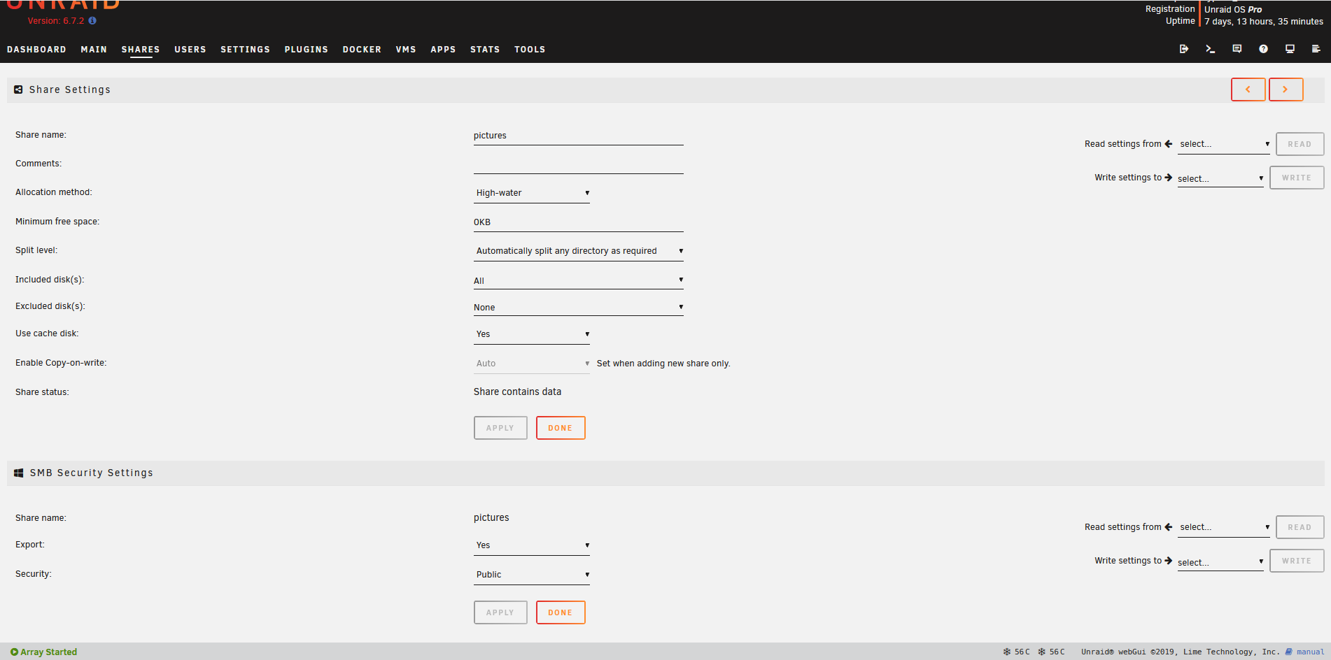

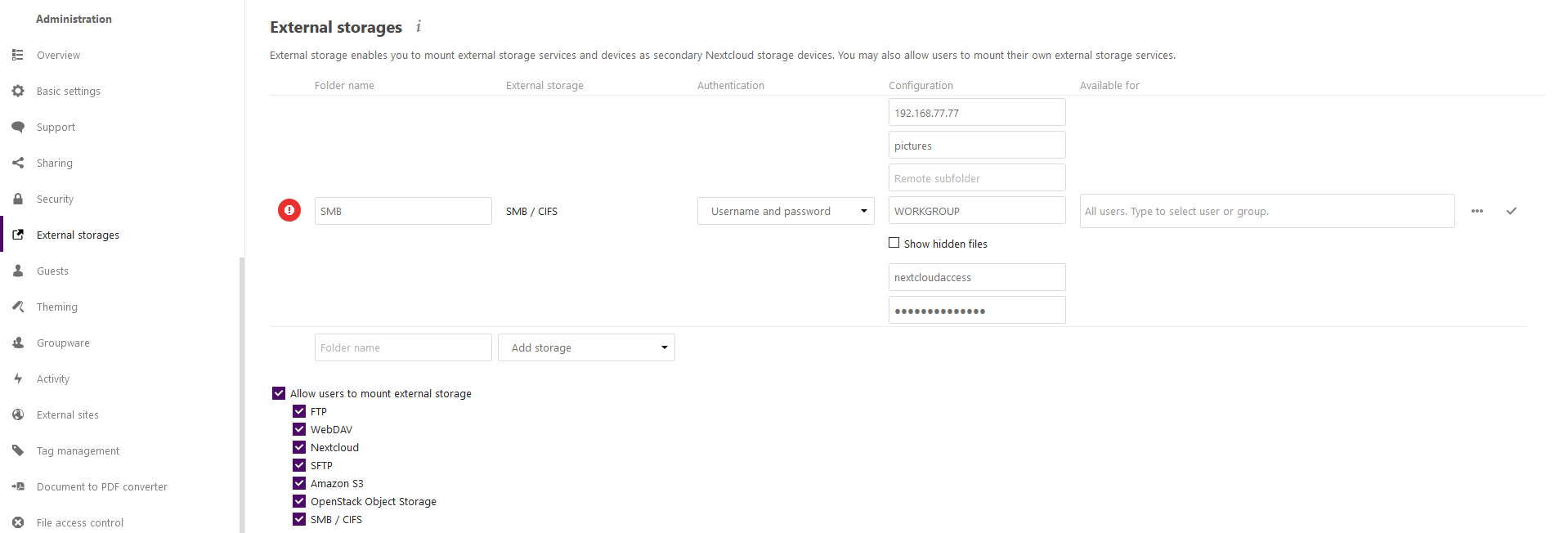

Hi All, it's time for yet another request for help with adding external storage. I saw this topic has come up several times before in this thread and others, but none of the prior solutions worked for me. Thanks in advance for any help you can provide!
So, I'm trying to add a share called 'pictures' as an external storage within the Nextcloud container.
  • I checked that the workgroup is indeed WORKGROUP, as that is the same used by my windows PC. I'm able to connect/browse/edit the SMB share from my windows PC without any issue. Also tried it with the 'domain' field in Nextcloud simply being empty.
  • Currently the share is set to public, but I've tried it with Secure/Private as well.
  • I searched around in various Nextcloud/smb log files, but I couldn't find any log that gets generated from actually trying to create the external storage in Nextcloud? Other than the angry red circle. Is there anywhere I can look to see *why* the attempt to create the external storage failed?
I should add that I'm aware that you can mount the share within the Nextcloud container and add it as a Local external storage instead, but that's my last resort. I'd much prefer to get it working as an SMB external storage.
I appreciate any help anyone might be able to give!
Share this post
Link to post

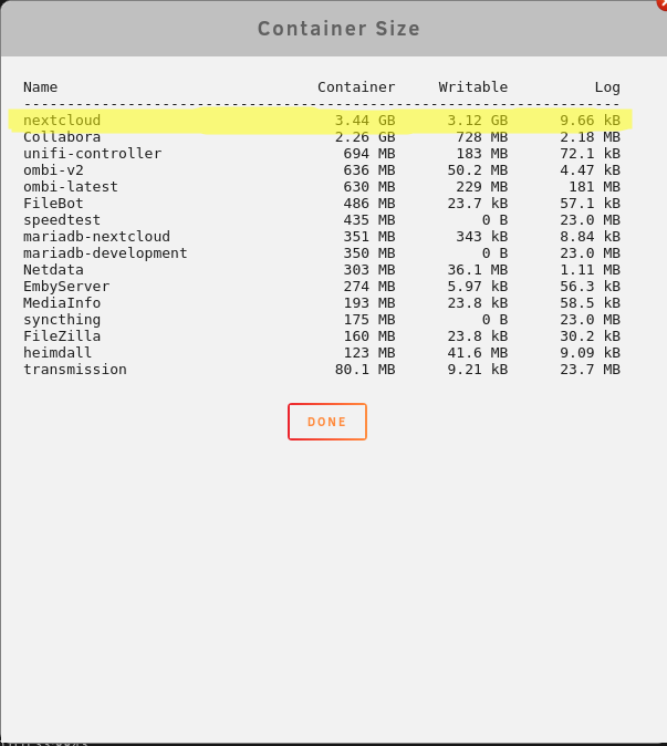

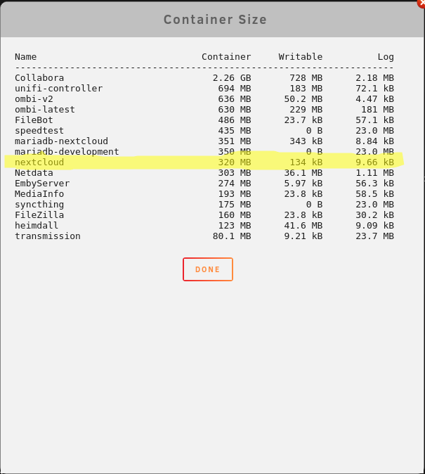

On 11/17/2019 at 10:38 PM, Vaseer said:
Today I was uploading some files to my Nextcloud and one of them was 6 GB of size.
When I was uploading this file, I got email notice from unRAID server "Docker image disk utilization of 72%". When the upload finished, I got new email notice: "Docker image disk utilization returned to normal level".
This made me curious of how does file transfer or rather file write to Nextcloud storage works?
I always thought that files are written directly to Nextcloud HDDs. But it seems that files are initially stored to Nextcloud Docker instance which is on cache SDD and then written to Nextcloud storage HDDs.
Is this proper way for file transfer to Nextcloud or did I do something wrong with my configuration?
I didn't get any information (searched unRAID forum and Googled it) to answer this question so I am asking again and adding some new test results.
Uploading ~5GB test file to Nextcloud over local network:
Before upload:
BeforeUpload1.png.01d8eca908d4ee4b14f6f6b617a912f9.png BeforeUpload2.png.1cc95a0e4b0092acdaae111fd343b913.png
Couple seconds after finished upload:
SecondsAfterFinnishedUpload1.png.2206851fd4a0240ebe21732723c58ccf.png SecondsAfterFinnishedUpload2.png.b51ff2834e678cedbfe5ef9885db9e58.png
Is this normal/correct way of uploading files to Nextcloud?
NC container mappings:
/data <--> /mnt/disks/nextcloud/nextcloud-data/
/config <--> /mnt/cache/docker/appdata/nextcloud
unRAID version: 6.6.6
Edit: Found it!
This only happens when I upload files from my Fedora PC via webdav/dav connection (davs://vaseer@nc.mydomain.com/remote.php/webdav).
If I upload file via browser, docker.img size doesn't change.
Is this bug or expected behavior?
Edited by Vaseer
Share this post
Link to post

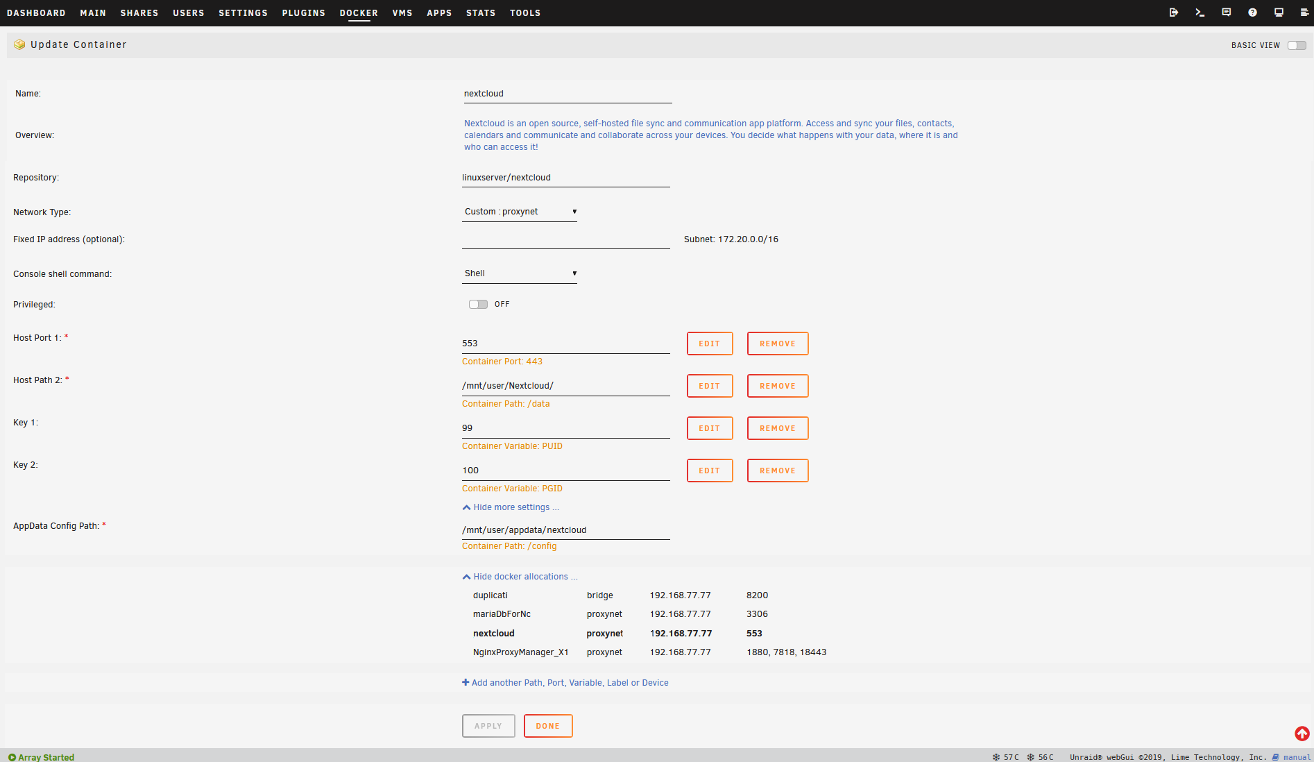

Before upload:
Edit: Found it!
That question is better asked to nextcloud. Nextcloud stores the file temporarily somewhere before writing it to disk and we have no control over where they choose to store it.
Might be stored in /tmp inside the container, so you could try to mount a folder to /tmp and see if it changes anything.
Do not mount unraid /tmp to /tmp inside the container as that might cause deleted files in tmp that shouldn't be deleted.
Share this post
Link to post
i also have the same problem. Can someone help here? There are several post about this problem but no answer to it.
I appreciate the awesome work that you are doing here. so i hope someone can help or make a how to video ^^
Thx
Share this post
