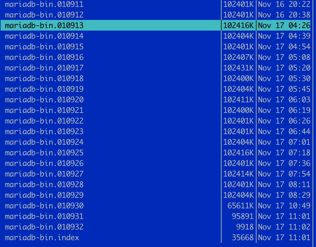

Hey guys - I hope you can help me. Nextcloud appears to be the culprit as the silent destoryer of my SSD cache pool. In less than one year I am at 482 TBW on my two 1TB SSDs. This is WAY over any normal usage. I did some tests last night and this morning and I can consistently stop the rogue disk writes by turning off Nextcloud. If I turn it back on its fine for a few hours then they start again.
This is big issue for me and I suspect this may be happening to others as well and is going unnoticed unless you check the stats page often or regularly check the wear level or lbas written in the smart reports.
Any help is appreciated!
(Thread linked for more info)
EDIT: Ok I think I'm getting closer... I noticed I have a TON of MariaDB logs starting around the time that the writes kicked in:
Here is a sample from the log at the time the disk writes went crazy. Any idea what the issue is? I have a fairly standard setup so I'm not really sure what is causing this.
BINLOG '
[Several lines here]
# Number of rows: 1
# at 97428701
# at 97429112
#191117  4:25:04 server id 1  end_log_pos 97429112 CRC32 0xe4325a48     Annotate_rows:
#Q> UPDATE `oc_filecache` SET `mtime` = '1573982704', `etag` = '05d7b84ff4619afc78fc0f4f087d3fd8', `storage_mtime` = '1573982704', `checksum`='' WHERE (`mtime` <> '1573982704' OR `etag` <> '05d7b84ff4619afc78fc0f4f087d3fd8' OR `storage_mtime` <> '1573982704' OR `checksum` <> '' OR `mtime` IS NULL OR `etag` IS NULL OR `storage_mtime` IS NULL OR `checksum` IS NULL) AND `fileid` = '163718282'
#191117  4:25:04 server id 1  end_log_pos 97429198 CRC32 0x5ae44186     Table_map: `nextcloud`.`oc_filecache` mapped to number 34
# at 97429198
#191117  4:25:04 server id 1  end_log_pos 97430666 CRC32 0x5b9683fd     Update_rows: table id 34 flags: STMT_END_F
Edited by johnsanc

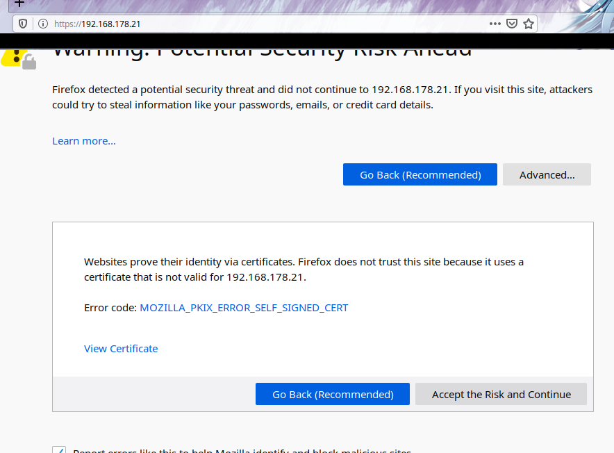

On 11/16/2019 at 3:00 PM, saarg said:
No issues here. Try following the guide to update using the command line in the link in the first post.
I have a similar problem. When clicking on the WebUI Button the attached screen appears. By clicking on "agree", I receive the following error after a while:
Internal Server Error
The server encountered an internal error and was unable to complete your request.
The nginx `access.log` contains the following while the `error.log` is empty:
192.168.178.25 - - [17/Nov/2019:19:54:27 +0100] "GET / HTTP/2.0" 500 289 "http://192.168.178.21/Docker" "Mozilla/5.0 (X11; Ubuntu; Linux x86_64; rv:70.0) Gecko/2010010
1 Firefox/70.0"
192.168.178.25 - - [17/Nov/2019:19:55:18 +0100] "GET / HTTP/2.0" 500 289 "-" "Mozilla/5.0 (X11; Ubuntu; Linux x86_64; rv:70.0) Gecko/20100101 Firefox/70.0"
192.168.178.25 - - [17/Nov/2019:19:55:55 +0100] "GET /favicon.ico HTTP/2.0" 500 289 "-" "Mozilla/5.0 (X11; Ubuntu; Linux x86_64; rv:70.0) Gecko/20100101 Firefox/70.0
Accessing the WebUI via `http://192.168.178.21:443/` as I did before the upgrade, causes the error "The plain HTTP request was sent to HTTPS port". I am sure that my nginx `default` file contains the latest changes from the commit  update nginx site conf due to CVE. Any help?
Share this post
Link to post
1 Firefox/70.0"
How did you upgrade and did you get any errors during the upgrade?
You use https if you are using port 443. Also no need to specify the port if it's the default 443.
The reason you get an error is that you are using http when using the ssl port.
As for the internal server error, you might be in maintenance mode still?

FYI - I figured out my issue above.... in short do not have Nextcloud index symlinks that would cause a loop.
