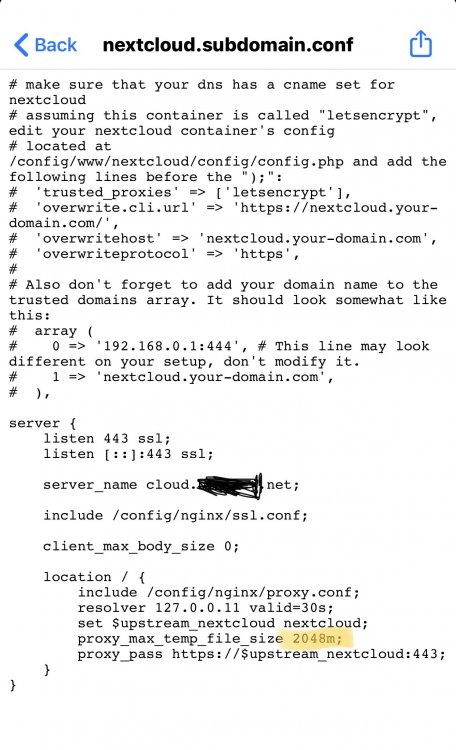

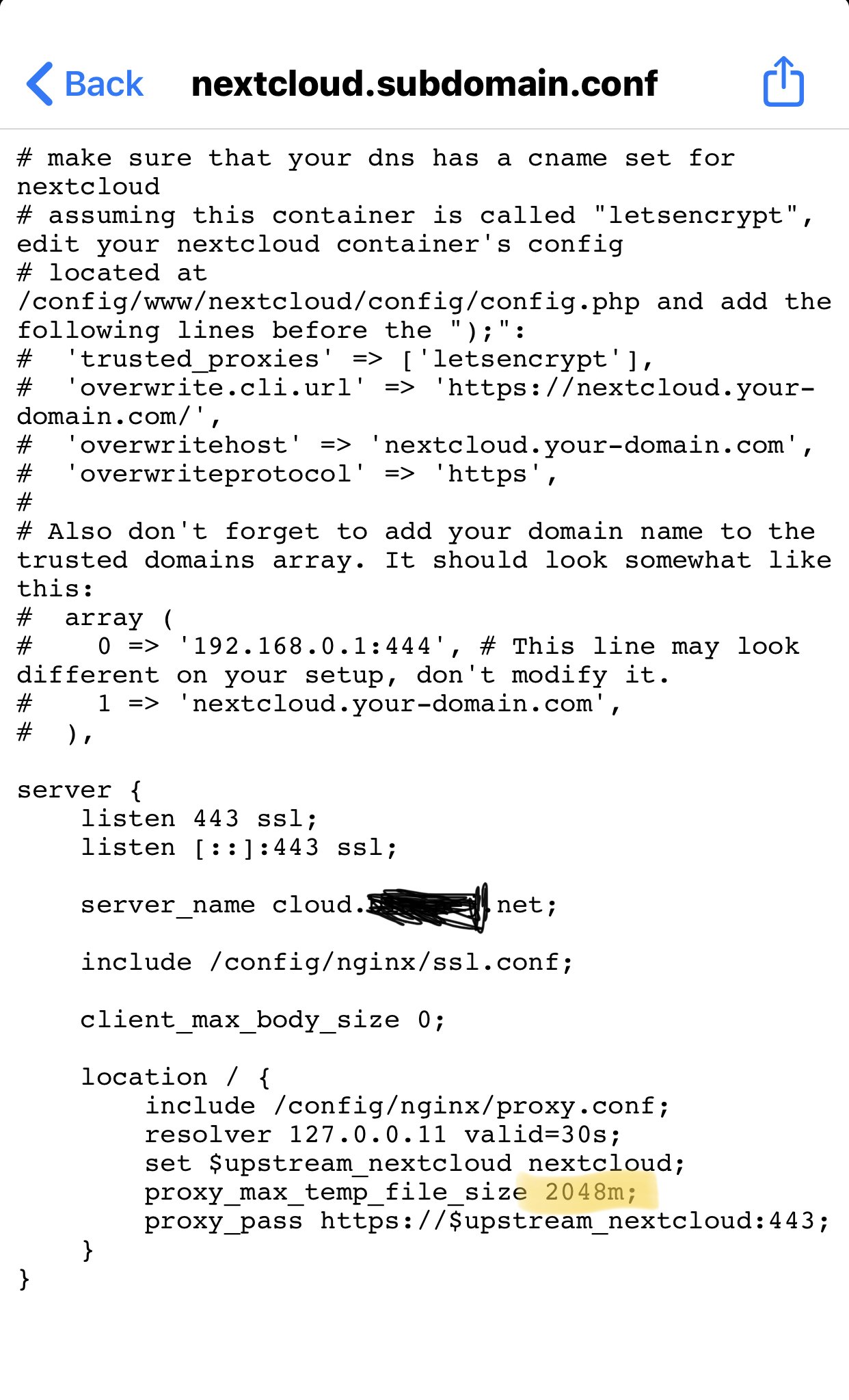

Alright, not trying to beat a dead horse here...apologies in advance.
Today I have been trying to upload a .mov file that is just a LITTLE larger than 2.5gb using the current Nextcloud iOS app. Every time it fails with a 413 error in Nextcloud app.
I’ve searched through thread and edited the few different files, that are usually responsible for this issue, max upload size to 0 as been mentioned in thread 200x. Still no dice.
In my Letsencrypt nextcloud.subdomain.conf would or could “proxy_max_temp_file_size 2048m” have anything to do with my issues? Not sure what else to do, as I said, I’ve changed max upload size everywhere else(mentioned in thread) to “0” on max size. Could it just be a defunct in most recent Nextcloud iOS client app ?
suggestions, thoughts, direction or help would be greatly appreciated.
Thanks!!
Thanks!!
Solved my problem, sometimes I’m a real... errrm “genius.”
Forgot I was proxying through Cloudflare... DNS only and such issue evidently doesn’t exist. I’ll flip proxy back on later. Facepalm.
So, for anyone in future... If your uploading large files and using Cloudflare as your CDN you *may* have to turn the CF Proxy off/on to accommodate occasional large file uploads. :-)
