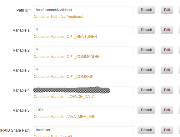

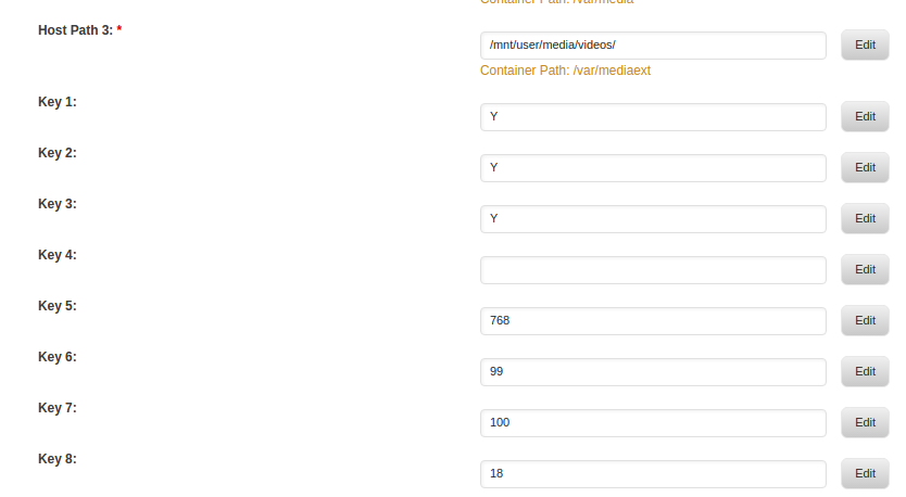

After upgrading to RC1, when I go to install a Docker container using a template that I have not used before, all the VARIABLE sections are missing the actual variable names?
Is this by design??
I've attached 2 images... one if from the RC1 and shows no variable names, just the default value... and the other shows what it used to look like.
When I edit existing docker configs I see the correct layout... so this is ONLY happening when I'm installing something new that has never been installed.
Is this by design??
Not the behavior I'm seeing which container are you adding?
