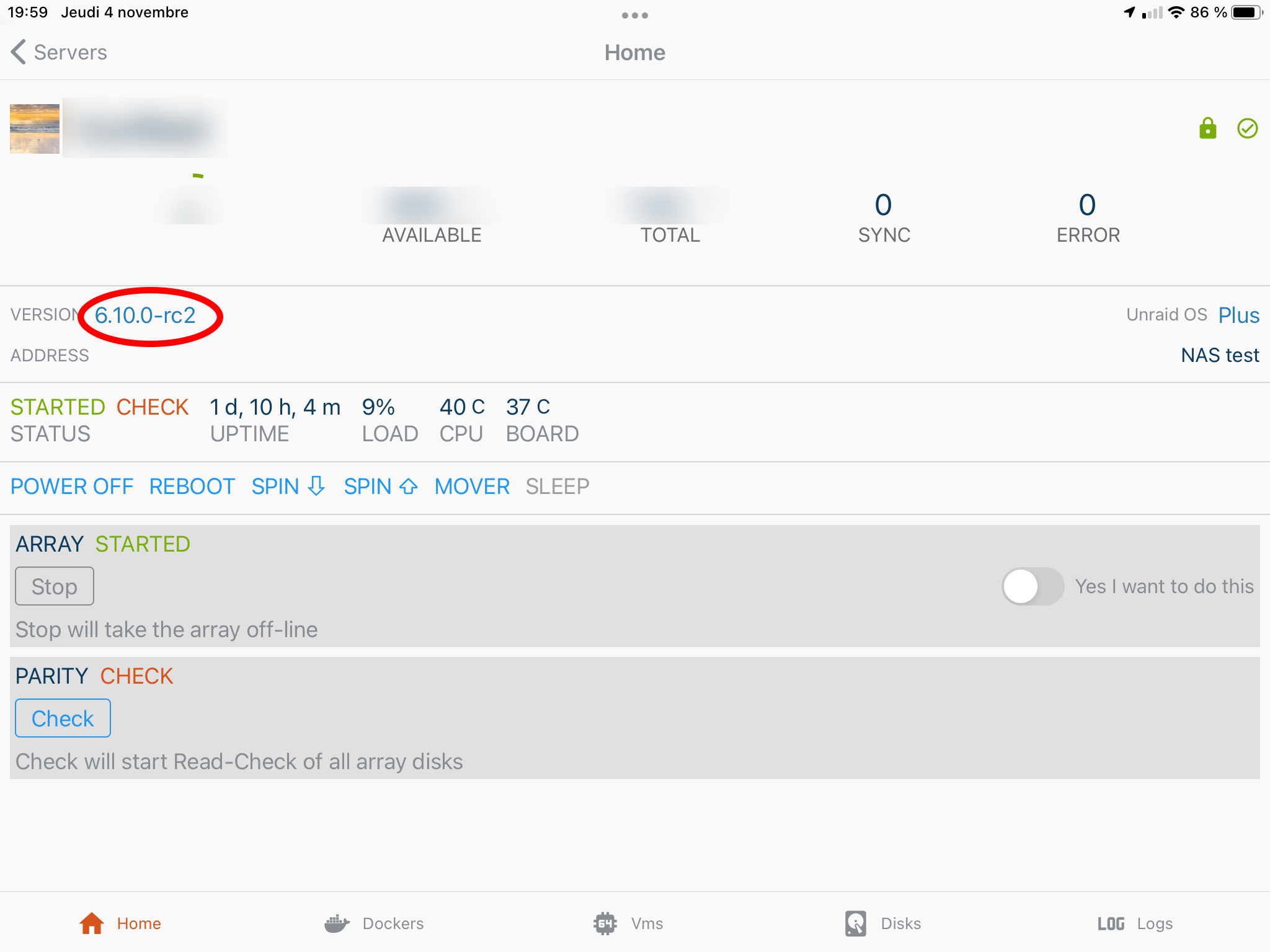

Chris Mot Posted November 4, 2021 Share Posted November 4, 2021 5 hours ago, Marcin said: 6.10.0 - rc2 is working? Yes, it does. Quote Link to comment
jbrodriguez Posted November 6, 2021 Author Share Posted November 6, 2021 On 11/4/2021 at 8:33 AM, Marcin said: 6.10.0 - rc2 is working? I migrated my test server to rc2 and the app (in the stores) is still working ! Quote Link to comment
jbrodriguez Posted November 6, 2021 Author Share Posted November 6, 2021 On 11/4/2021 at 2:09 PM, Chris Mot said: Yes, it does. I need to do something about that gray background on the array and parity sections. I don't like it 🤷♂️ 1 Quote Link to comment
