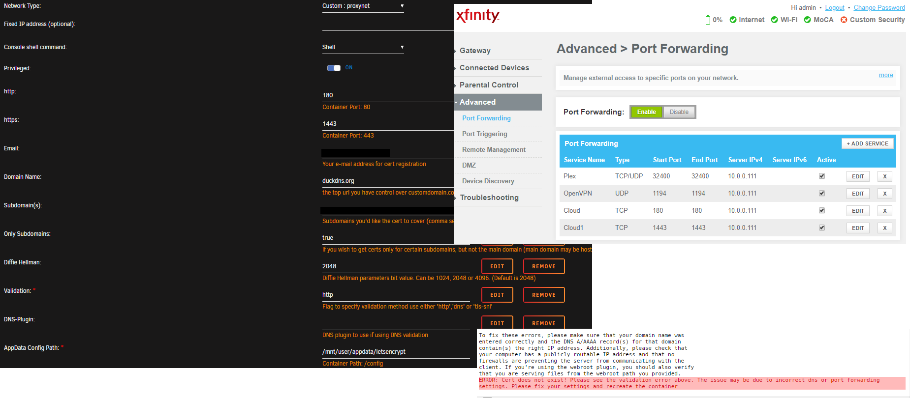

I'm getting "ERROR: Cert does not exist! Please see the validation error above. The issue may be due to incorrect dns or port forwarding settings. Please fix your settings and recreate the container" am i missing something?
You need to forward 443 to 1443 and 80 to 180

5 hours ago, CHBMB said:
Have you got your domain provider configured appropriately with a names and cnames etc and forwarding ports 80 to 180 and 443 to 1443 on your router.
Some screenshots might be helpful.
here's my routing. I have directed the a-records directly to my ip for now (my ip adress hasn't changed over a year), which I will set up further when I have this working.

21 hours ago, CHBMB said:
Struggling to get my head around why you have two routers and I can't visualise your setup at all.
NP, I added an extra image to show how the routing is done. The reason for 2 routers is that router 1 used to be a simple cable modem. It broke when I was not at home and a technician replaced it with a fancy all in one modem / router. When I got back, I left it like that (due to the fact that the two are two floors apart) and just routed the ports on router 1 to just pass them on 1 on 1.
routing.zip
Link to comment
I suspect, although, I'm not 100% sure as I'm not a networking guy that the dual router setup is causing some issues, essentially you have a double NAT
http://www.practicallynetworked.com/networking/fixing_double_nat.htm
Link to comment
5 hours ago, ijuarez said:
Ding ding ding ding double natting.
Can you ask your ISP to set the all in one to bridge mode?
Sent from my SM-N960U using Tapatalk
Well it's a good excuse to clean up the network and take the 2nd router out of the loop. Been meaning to do that for some time, and this is a good reason. Port forwarding worked till now so I didn't expect that to be the problem. Anyway, I'll be back ;)
