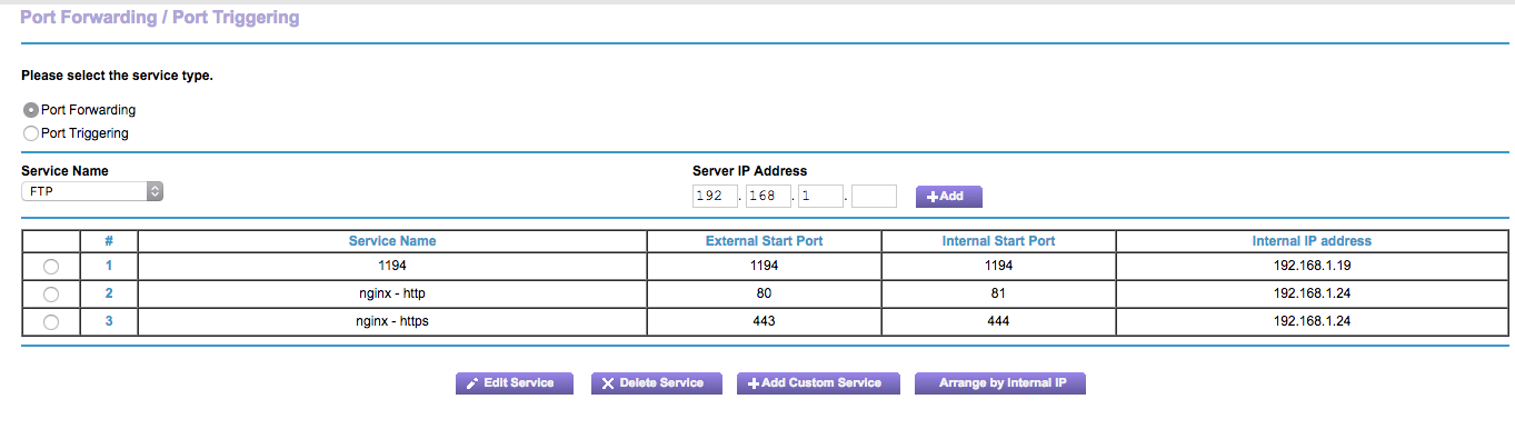

Help!
I have set this up, to use in conjunction with Nextcloud, Plex, Radarr, blah blah.... I followed this guide. Nextcloud is working-ish; and Letsencrypt is working, as long as I only set the subdomains covered to www.
1167059693_ScreenShot2018-05-01at5_02_55PM.thumb.png.651648341328fefd77ab8f6da9216b9a.png
If i make the subdomains www,nextcloud things don't work.
Here are the Letsencrypt logs, when it does not work.

ERROR: Cert does not exist! Please see the validation error above. The issue may be due to incorrect dns or port forwarding settings. Please fix your settings and recreate the container
Here is my router port forwarding...
1662968973_ScreenShot2018-05-01at5_03_52PM.thumb.png.28997c3a6f94f298924802091ecf8c64.png
Here is my '/config/nginx/site-confs/nextcloud' file.

2 hours ago, igreulich said:
Help!
[fix-attrs.d] done.
[cont-init.d] 10-adduser: executing...
_ ()
| | ___ _ __
| | / __| | | / \
| | \__ \ | | | () |
|_| |___/ |_| \__/
Brought to you by linuxserver.io
We gratefully accept donations at:
https://www.linuxserver.io/donations/
GID/UID
User uid: 99
User gid: 100
[cont-init.d] 10-adduser: exited 0.
[cont-init.d] 20-config: executing...
[cont-init.d] 20-config: exited 0.
[cont-init.d] 30-keygen: executing...
using keys found in /config/keys
[cont-init.d] 30-keygen: exited 0.
[cont-init.d] 50-config: executing...
Variables set:
PUID=99
PGID=100
TZ=America/Los_Angeles
URL=greulich.me
SUBDOMAINS=www,nextcloud
EXTRA_DOMAINS=
ONLY_SUBDOMAINS=false
DHLEVEL=2048
VALIDATION=http
DNSPLUGIN=
EMAIL=ian@greulich.me
STAGING=
Backwards compatibility check. . .
No compatibility action needed
2048 bit DH parameters present
SUBDOMAINS entered, processing
Sub-domains processed are: -d www.greulich.me -d nextcloud.greulich.me
E-mail address entered: ian@greulich.me
http validation is selected
Different validation parameters entered than what was used before. Revoking and deleting existing certificate, and an updated one will be created
Saving debug log to /var/log/letsencrypt/letsencrypt.log
You should register before running non-interactively, or provide --agree-tos and --email <email_address> flags.
Generating new certificate
Plugins selected: Authenticator standalone, Installer None
Obtaining a new certificate
Performing the following challenges:
http-01 challenge for greulich.me
http-01 challenge for nextcloud.greulich.me
http-01 challenge for www.greulich.me
Waiting for verification...
Cleaning up challenges
Failed authorization procedure. nextcloud.greulich.me (http-01): urn:ietf:params:acme:error:dns :: DNS problem: NXDOMAIN looking up A for nextcloud.greulich.me
IMPORTANT NOTES:
- The following errors were reported by the server:
Domain: nextcloud.greulich.me
Type: None
Detail: DNS problem: NXDOMAIN looking up A for
- Your account credentials have been saved in your Certbot
configuration directory at /etc/letsencrypt. You should make a
secure backup of this folder now. This configuration directory will
also contain certificates and private keys obtained by Certbot so
making regular backups of this folder is ideal.

Create a cname for nextcloud on your dns provider
Share this post
Link to post
Derp, totally correct. I completely forgot about that part.
Thanks!

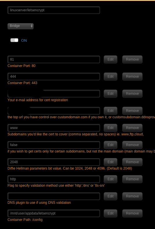

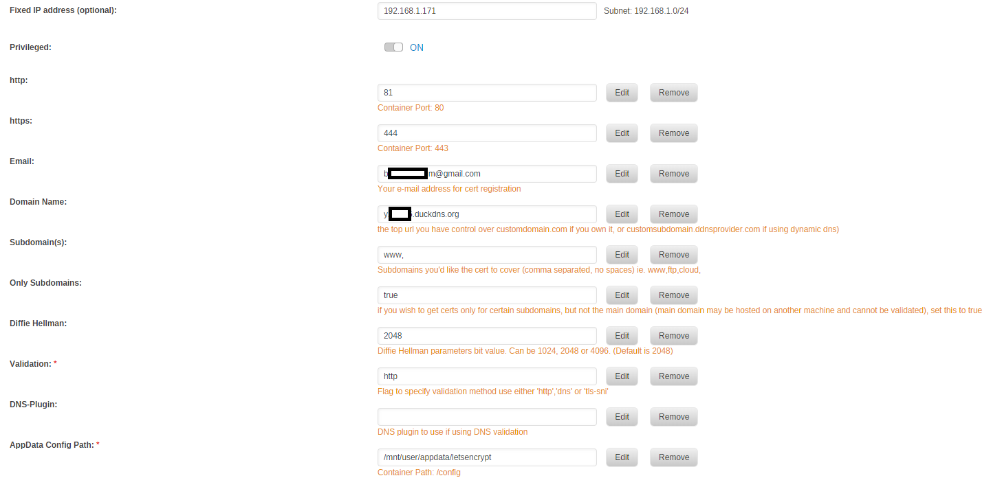

I was able to get LetsEncrypt to work with DuckDNS but it only works when I enter www.[myduckdnsdomain].duckdns.org, or https://www.[myduckdnsdomain].duckdns.org. If I enter just [myduckdnsdomain].duckdns.org it loads but says Your Connection is not valid. If I try https://[myduckdnsdomain].duckdns.org it loads a page that says my connection is not private.
I've searched but can't find any answers. If I'm honest I'm not even sure what I should be searching for.
Share this post
Link to post
Post your docker run command (or a screenshot of your settings)
Share this post
Link to post
10 hours ago, endiz said:
Anyone have any guides to get fail2ban working with nzbget, radarr and sonarr? I use the built in http auth of each app, but i'm OK with disabling the built-in mechanisms and utilizing nginx for all authentication so it integrates nicely with fail2ban.
Thanks
If you use nginx auth via htpasswd, the fail2ban filter for that is already active
Share this post
Link to post
18 hours ago, Nomar1245 said:
You set only_subdomains to true
Share this post
Link to post
Thanks for the help.I was under the impression that only_subdomains was needed because I was using duckdns.org. However, after I removed my existing container, recreated it with the same settings, except for changing only_subdomains to false, I am having the same problem.
Update: It's working
So, I setup my docker using a guide that took me 90% of the way, but the last 10% is what I needed. After replying to aptalca, I stepped back and looked at everything I was doing and decided to work through on my own, one step at a time, and the culprit ended up being a bad default file. I should have known better. Thank you for the help.
Edited by Nomar1245
Humility
Share this post
Link to post

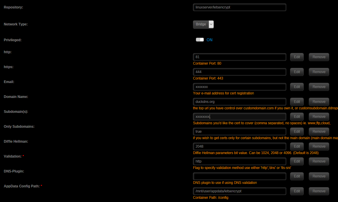

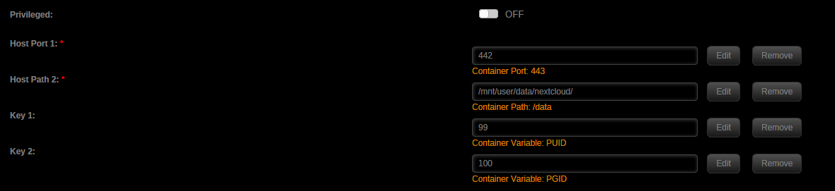

Hi all,
Like many others I am struggling with Letsencrypt and NextCloud.
I spent a lot of time following numerous tutorials but none of them could make it work.
What is installed:
  • duckdns
  • nextcloud
  • letsencrypt
What does work:
  • Local access to nextcloud through an unsecured connection by using my unraid local address: 192.168.1.206:442 (I have to add an exception in my browser so it will connect)
  • Remote access to nextcloud through an unsecured connection by using my duckdns address XXXXX.duckdns.org:442 (I have to add an exception in my browser so it will connect)
  • Looks like duckdns works as well as port forwarding on port 442
  • Letsencrypt works I guess, here is the log:
    Processing /etc/letsencrypt/renewal/XXXX.duckdns.org.conf
    Cert not yet due for renewal
    The following certs are not due for renewal yet:
    /etc/letsencrypt/live/XXXX.duckdns.org/fullchain.pem expires on 2018-08-13 (skipped)
    No renewals were attempted.
    No hooks were run.
    [cont-init.d] 50-config: exited 0.
    [cont-init.d] done.
    [services.d] done.
    Server ready
What does not work:
  • Local secured access to next cloud
  • Remote secure acess to next cloud
What is my configuration:
  • letsencrypt\nginx\site-confs\default
upstream backend {
    server 192.168.1.206:19999;
    keepalive 64;
server {
    listen 443 ssl;
    listen 80 default_server;
    root /config/www;
    index index.html index.htm index.php;
    server_name XXXX.duckdns.org;
    ssl_certificate /config/keys/letsencrypt/fullchain.pem;
    ssl_certificate_key /config/keys/letsencrypt/privkey.pem;
    ssl_dhparam /config/nginx/dhparams.pem;
    ssl_ciphers 'ECDHE-RSA-AES128-GCM-SHA256:ECDHE-ECDSA-AES128-GCM-SHA256:ECDHE-RSA-AES256-GCM-SHA384:ECDHE-ECDSA-AES256-GCM-SHA384:DHE-RSA-AES128-GCM-SHA256:DHE-DSS-AES128-GCM-SHA256:kEDH+AESGCM:ECDHE-RSA-AES128-SHA256:ECDHE-ECDSA-AES128-SHA256:ECDHE-RSA-AES128-SHA:ECDHE-ECDSA-AES128-SHA:ECDHE-RSA-AES256-SHA384:ECDHE-ECDSA-AES256-SHA384:ECDHE-RSA-AES256-SHA:ECDHE-ECDSA-AES256-SHA:DHE-RSA-AES128-SHA256:DHE-RSA-AES128-SHA:DHE-DSS-AES128-SHA256:DHE-RSA-AES256-SHA256:DHE-DSS-AES256-SHA:DHE-RSA-AES256-SHA:AES128-GCM-SHA256:AES256-GCM-SHA384:AES128-SHA256:AES256-SHA256:AES128-SHA:AES256-SHA:AES:CAMELLIA:DES-CBC3-SHA:!aNULL:!eNULL:!EXPORT:!DES:!RC4:!MD5:!PSK:!aECDH:!EDH-DSS-DES-CBC3-SHA:!EDH-RSA-DES-CBC3-SHA:!KRB5-DES-CBC3-SHA';
    ssl_prefer_server_ciphers on;
    client_max_body_size 0;
    location = / {
        return 301 /htpc;
    location /sonarr {
        include /config/nginx/proxy.conf;
        proxy_pass http://192.168.1.206:8989/sonarr;
    location /radarr {
        proxy_pass http://192.168.1.206:7878/radarr;
    location /htpc {
        proxy_pass http://192.168.1.206:8085/htpc;
    location /downloads {
        proxy_pass  http://192.168.1.206:8112/;
        proxy_set_header  X-Deluge-Base "/downloads/";
    #PLEX
    location /web {
        # serve the CSS code
        proxy_pass http://192.168.1.206:32400;

  • nextcloud config.php
<?php
$CONFIG = array (
  'memcache.local' => '\\OC\\Memcache\\APCu',
  'datadirectory' => '/data',
  'instanceid' => 'oc4xjllsleky',
  'passwordsalt' => 'AePwbt7LYPhHr9QW/xhQEHG3Upk+XC',
  'secret' => 'eg8adPotUPdkAphDtJKC0abNfglncPMdGPYlx5ujkwWRhZBf',
  'trusted_domains' =>
  array (
    0 => '192.168.1.206:442',
	1 => 'XXXXX.duckdns.org',
  'overwrite.cli.url' => 'https://192.168.1.206:442',
  'dbtype' => 'mysql',
  'version' => '13.0.1.1',
  'dbname' => 'nextcloud',
  'dbhost' => '192.168.1.206:3305',
  'dbport' => '',
  'dbtableprefix' => 'oc_',
  'dbuser' => 'xXxXxXxX',
  'dbpassword' => 'xXxXxX',
  'installed' => true,
And attached, the docker configuration of both Letsencrypt and Nextcloud
There must be something stupid I did but I can't put my finger on it. Thanks a lot for your help!
