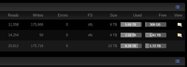

colors from disks are gone :(
Have you tried re-selecting it? Sometimes settings get accidentally changed or lost.
Settings -> Display Settings -> Used/Free Columns: Bar (color)
thx for tip, anything i try from that menu - no change look still the same.
You might want to check your USB flash device for corruption. Shut down, remove it and plug it into a Windows/Linux/Macintosh computer and run the appropriate disk check utility on it.
