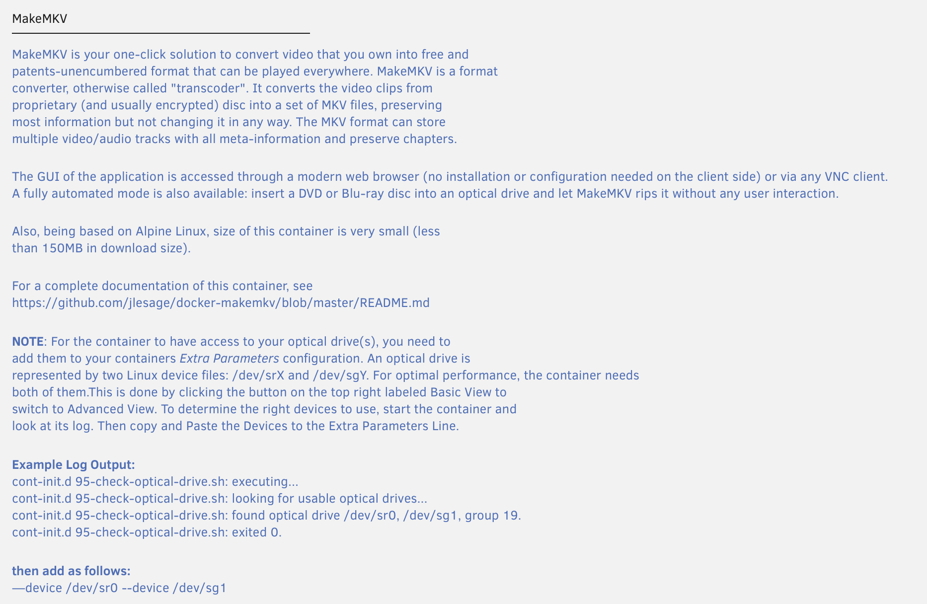

I totally agree. Perhaps a more detailed explanation in the container for device setup.
something like this perhaps:
NOTE: For the container to have access to your optical drive(s), you need to
add them to your containers *Extra Parameters* line. An optical drive is represented by two Linux device files: /dev/srX and /dev/sgY. For optimal performance, the container needs both of them. This is done by clicking the button on the top right labeled Basic View to switch to Advanced View, this will expose the *Extra Parameters* line. To determine the right devices to use, start the container and look at its log. Then add the Devices listed to the Extra Parameters Line.
Example Log Output:
[cont-init.d] 95-check-optical-drive.sh: executing...
[cont-init.d] 95-check-optical-drive.sh: looking for usable optical drives...
[cont-init.d] 95-check-optical-drive.sh: found optical drive [/dev/sr0, /dev/sg1], group 19.
[cont-init.d] 95-check-optical-drive.sh: exited 0.
then add as follows:
--device /dev/sr0 --device /dev/sg1
