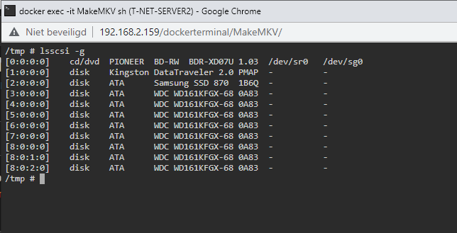

Hi all, I'm trying to install the optical drive but can't find the value for /dev/sg* . See attachment. How can I make this value visible?
Without it MakeMKV of course doesn't see the drive.
Edited by Teejoo
I don't understand the question. The attached picture shows /dev/sg0.
Oops, I feel so stupid. At first I didn't get the info.. Problem solved!

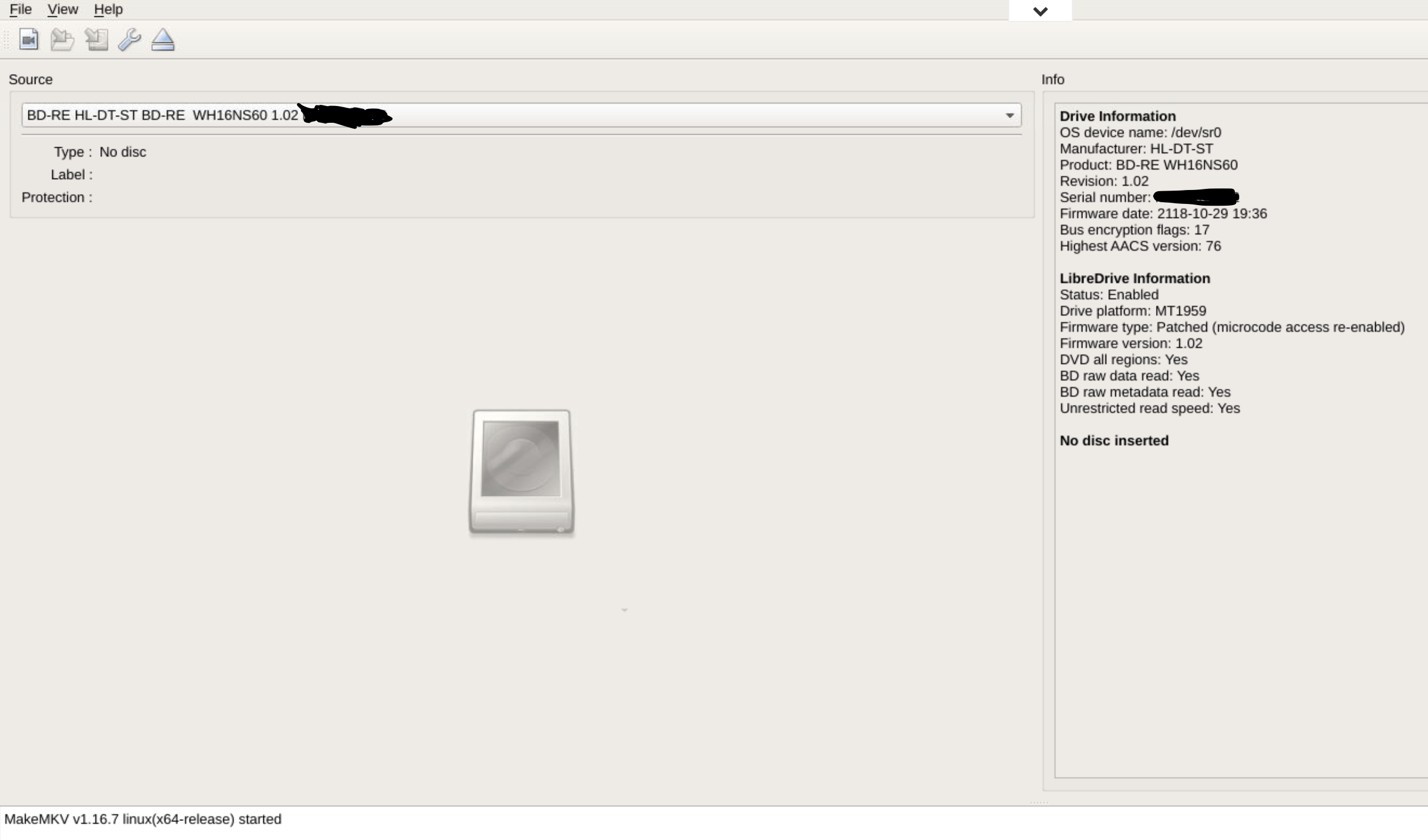

Running into an issue and haven't found anyone running into it on this forum
I've tried multiple blu-ray and DVDs but any disk I load, gives me a ton of errors that look like...
'Posix error - no such device' occurred while reading '[My bluray name and model #]' at offset '[some number]'
From what I'm seeing on the MakeMKV forums it's an issue with AACS host certificate. It's a usb drive. LiteOn BD-RE Slimtype EB1, and I don't have this problem when plugging into a usb port passed through to a VM with the latest version of MakeMKV installed.
The last release of MakeMKV was on 2/27, just 5 days after your last update. Is it possible that version has this fixed? Could you update it please?
Have you passed sr0 and sgx to the container?
I have. I also tried adding the ":latest" tag to the repository field to make sure it was grabbing latest since I noticed after posting that although last updated on CA is 2/22, on DockerHub it shows the last update as 2/28, but that didn't resolve the issue either
post a screenshot of the makemkv info widow that shows the drive info
have you flashed the drive with the MK firmware?
I’ve had lot’s of other errors before when I used a flashed UHD friendly drive. I used a Windows pc for ripping at that time. Those issues  even paused the whole ripping project.
All the problems are gone since I bought the Pioneer drives that are now compatible with MakeMKV. They work perfectly out of the box, using both USB or internal SATA. I have 3 pioneer drives now, one connected to my Unraid server and 2 for my PC and Laptop. Even ordered another internal drive for the Unraid server. They make less noise and rip even faster.
So it's suddenly working now. I believe it was a cable issue. To plug it in for my VM I just plug into the front ports. For Unraid host it's all the rear ports and I use an extension cable. I'm a dumb dumb and didn't think to rule that out til today when I reconnected it to grab that screenshot and it wouldn't mount at all. As soon as I plugged directly without the extension everything worked.
Thanks for the help, and sorry for the bother

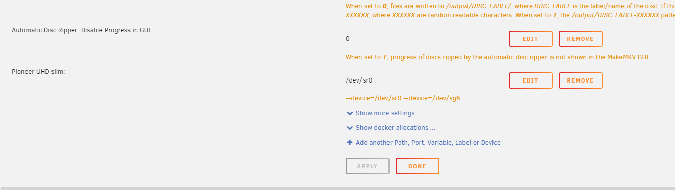

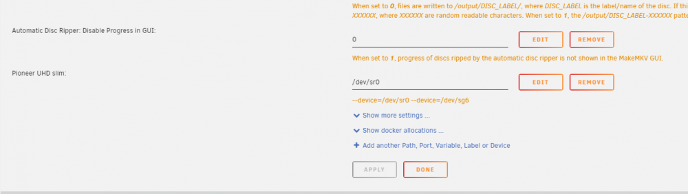

I bought an internal Pioneer drive and just like the first time with my external drive when I tried to retrieve the /dev/sgx info from the drive I don't see it.. The first time it fixed itself when I made the previous screenshot, no idea how.
So here is the current screenshot: No info in the second sg row, and the drive is not recognized by the docker.
Any ideas?
I found the correct value! It was displayed in the dockers settings under the drive I added before.
