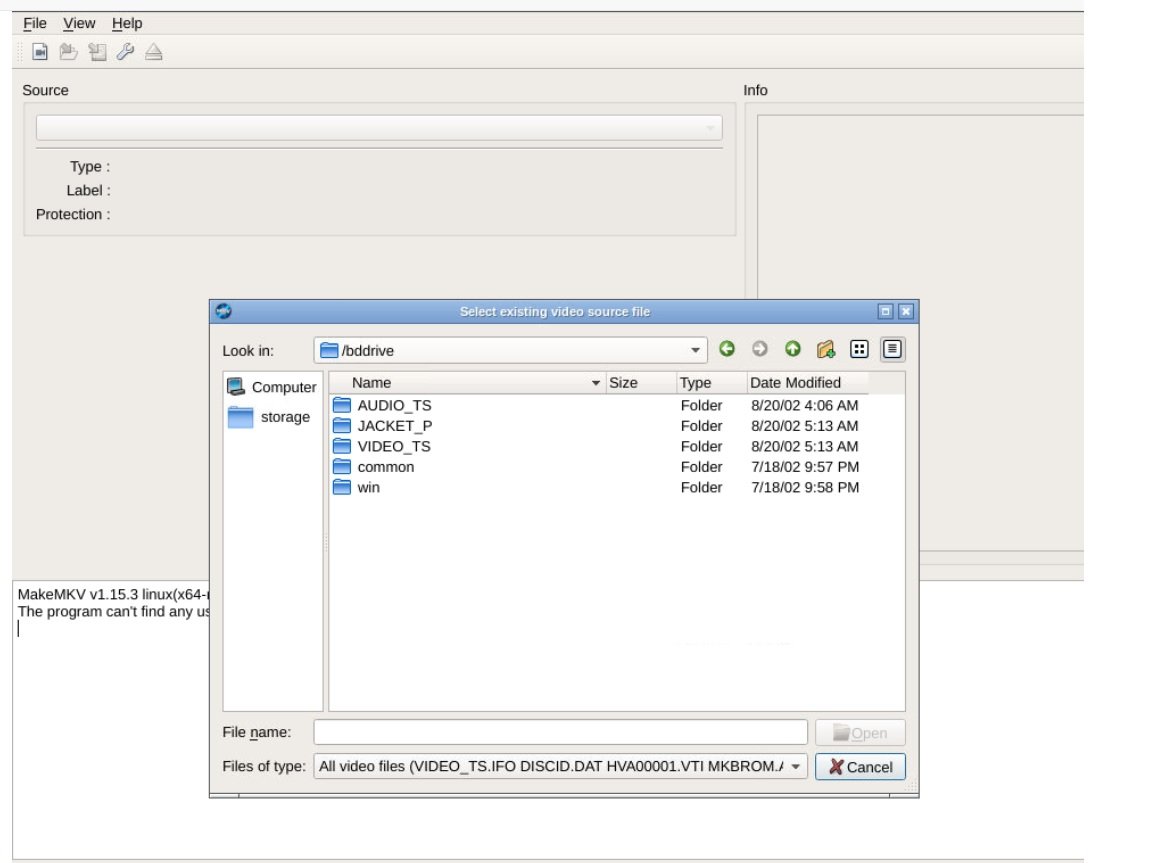

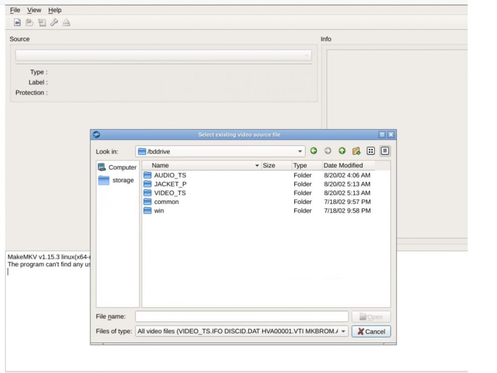

  Djoss, thanks for your work on this, it looks great.  I am a little outside my depth here.  I am trying to use a network share BD drive in the container and I don't know enough to put the correct info in the 'extra parameters' field.  I used the Unassigned Devices plugin to add the BD from my Windows machine to Unraid.  I can see the drive and access whatever is on it, but I don't know how to give the container access.  Thanks for your help.
You need to edit the container settings and add a new "Path".  This basically maps a path from the host (unRAID) to a path in the container.
  So it looks like that kinda works, while in MakeMKV web GUI I can now see the drive.  However it is basically just a folder.  MakeMKV does not recognize it as an optical drive.  Do I need to now add the path that I created as  --device?  I think I tried something like this yesterday and couldn't get it to work.  Thanks for any help.
Edit:Yeah, so I tried what I did yesterday and that doesn't work.  Not sure if it would be possible or not.  Here is what Unraid tells me:
