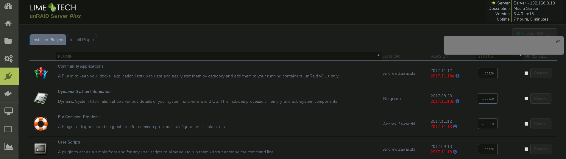

    This might be a plugin issue but I get this blank update notification when updating all plugins via the update all plugins button. To be fair this issue has been around for a while not just this RC.
    AFAIK this is related to a plugin, but honestly I can't remember which one.
