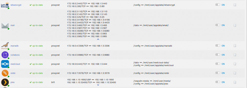

Starlord Posted January 11, 2019 Share Posted January 11, 2019 So I was able to get this working sending and receiving mail (static ip, ptr record set by my isp, all ports forwarded and working) but I'm having issues getting this working with my nginx reverse proxy.. keep getting a 502 error Here's my proxy conf server { listen 443 ssl; listen [::]:443 ssl; server_name mail.*; include /config/nginx/ssl.conf; client_max_body_size 0; # enable for ldap auth, fill in ldap details in ldap.conf #include /config/nginx/ldap.conf; location / { # enable the next two lines for http auth #auth_basic "Restricted"; #auth_basic_user_file /config/nginx/.htpasswd; # enable the next two lines for ldap auth #auth_request /auth; #error_page 401 =200 /login; include /config/nginx/proxy.conf; resolver 127.0.0.11 valid=30s; set $upstream_mail mail; proxy_pass http://$upstream_mail:4433; } } and here's the container setup Quote Link to comment

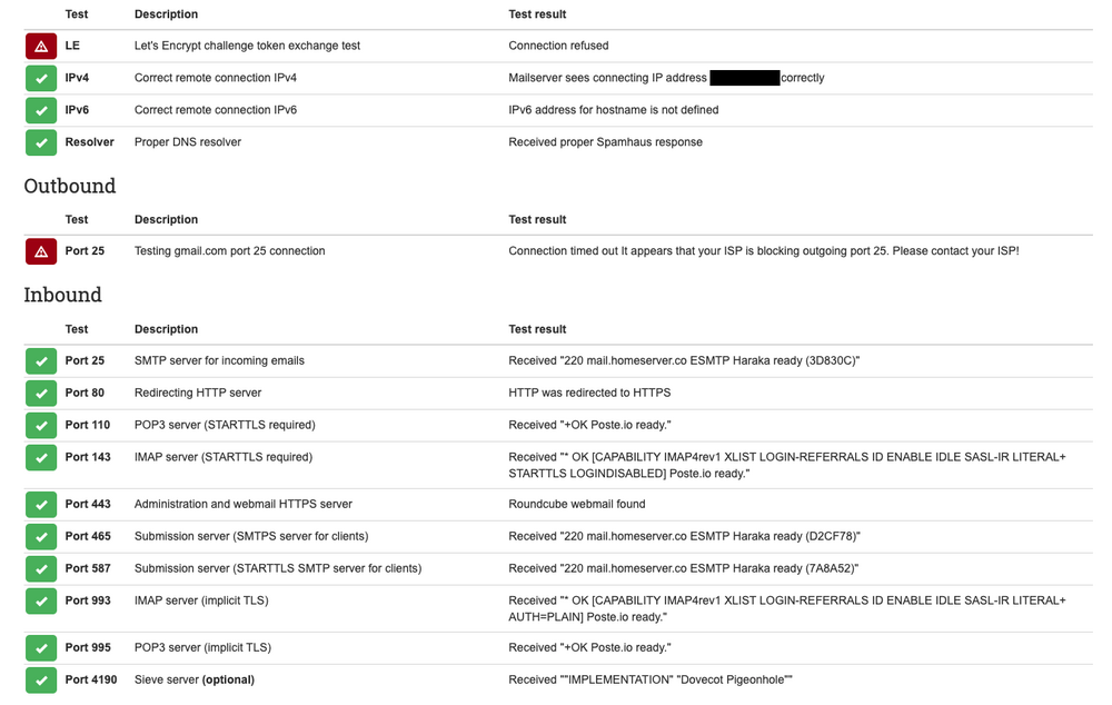

Dro Posted January 18, 2019 Share Posted January 18, 2019 Is there a way on the backend to default it to use port 587? If I wanted to use the web interface it seems by default it uses port 25 and I haven't found a way to change it.. Since my ISP blocks outbound port 25 this is an issue.. Emails get delivered if i setup an SMTP relay with port 587 but i cannot use that solution going forward it was for a test... I also cannot receive any emails which I am not sure why yet but am able to telnet to my server and can see a connection on the interface so i know inbound port 25/587 is open and working. Looks like most stuff is ending up in the "queue" and just stays there. Quote Link to comment

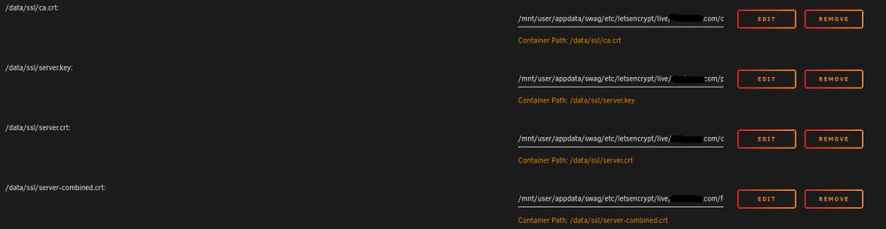

wierdbeard65 Posted June 14, 2019 Share Posted June 14, 2019 Hi, I have Poste.io set up on my Unraid server which is behind my firewall. I have a reverse proxy (NGINX) set up for web access. Mail ports are forwarded. All this is working. My problem is with using Let's Encrypt for certificates. I created a wildcard cert for my domain and, if I manually copy the certs, it "kind-of" works. Problem is that I have to manually renew this and then copy a bunch of certificates around. If I try to use Poste.io's internal certificate setup, then I hit a road-block. I don't know how this is working, but if I go to the URL for my Unraid box, then I get the Unraid interface. Same URL, but with /webmail or /admin gets me Poste.io. I have no idea where this redirect is being set up. I don't really care, however when I use the Cert setup, it tries to set up a challenge on http://<mydomain>/.well-known/acme-challenge/IyfGN5K7ZHtYnV198g5g-phW219wh73eMjddgVvhrmg and that is NOT redirected, so fails. Can anyone help? Quote Link to comment
wierdbeard65 Posted June 14, 2019 Share Posted June 14, 2019 Ok, after much digging as well as not a little hair-pulling, I now have it working. If anyone else stumbles across this post and has the same problem, it seems that when you access the web interface using port 8280, it redirects the browser to use https on port 443, changing the location to be /webmail. I hadn't noticed the switch.... The Let's Encrypt challenge works on http on port 80. So, what I did was to set my reverse proxy to forward all http requests to mail.<mydomain> port 80 to https on my Unraid box and it was able to verify everything.... Quote Link to comment

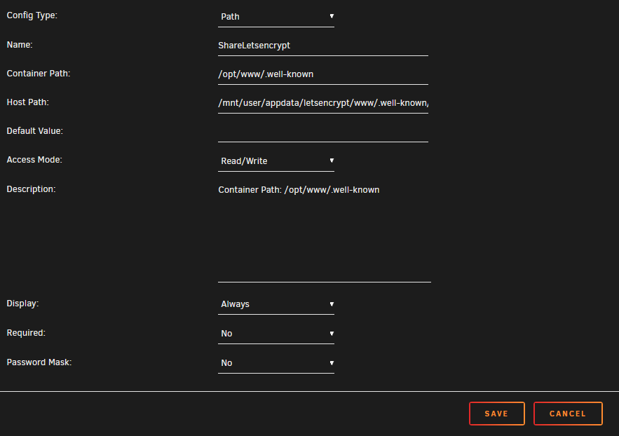

aterfax Posted October 22, 2019 Share Posted October 22, 2019 (edited) For users who want the letsencrypt in Poste IO working but are already using a letsencrypt docker, all you need to do is share the .well-known folders between your Poste IO and letsencrypt docker i.e. in the Poste IO docker config: This will not work if your domain has HSTS turned on with redirects to HTTPS (or this was the case with the version of letsencypt in the docker a while ago as it was reported here: https://bitbucket.org/analogic/mailserver/issues/749/lets-encrypt-errors-with-caprover ) You can instead mount the default certificate files in the docker directly to the certificates from the letsencrypt/SWAG docker. To be explicit with my volume mounts for SSL working: /data/ssl/server.crt → /mnt/user/appdata/letsencrypt/etc/letsencrypt/live/mailonlycert.DOMAIN.com/cert.pem /data/ssl/ca.crt → /mnt/user/appdata/letsencrypt/etc/letsencrypt/live/mailonlycert.DOMAIN.com/chain.pem /data/ssl/server.key → /mnt/user/appdata/letsencrypt/etc/letsencrypt/live/mailonlycert.DOMAIN.com/privkey.pem I do not recall the exact details of why the above is optimal but I suspect that Poste is handling making it's own full chain cert which results in some cert mangling if you do give it your fullchain cert rather than each separately (various internal services inside the docker need different formats) - I believe that without the mounts as above the administration portal will be unable to log you in. Edited May 18, 2021 by aterfax Updating info 2 1 Quote Link to comment
