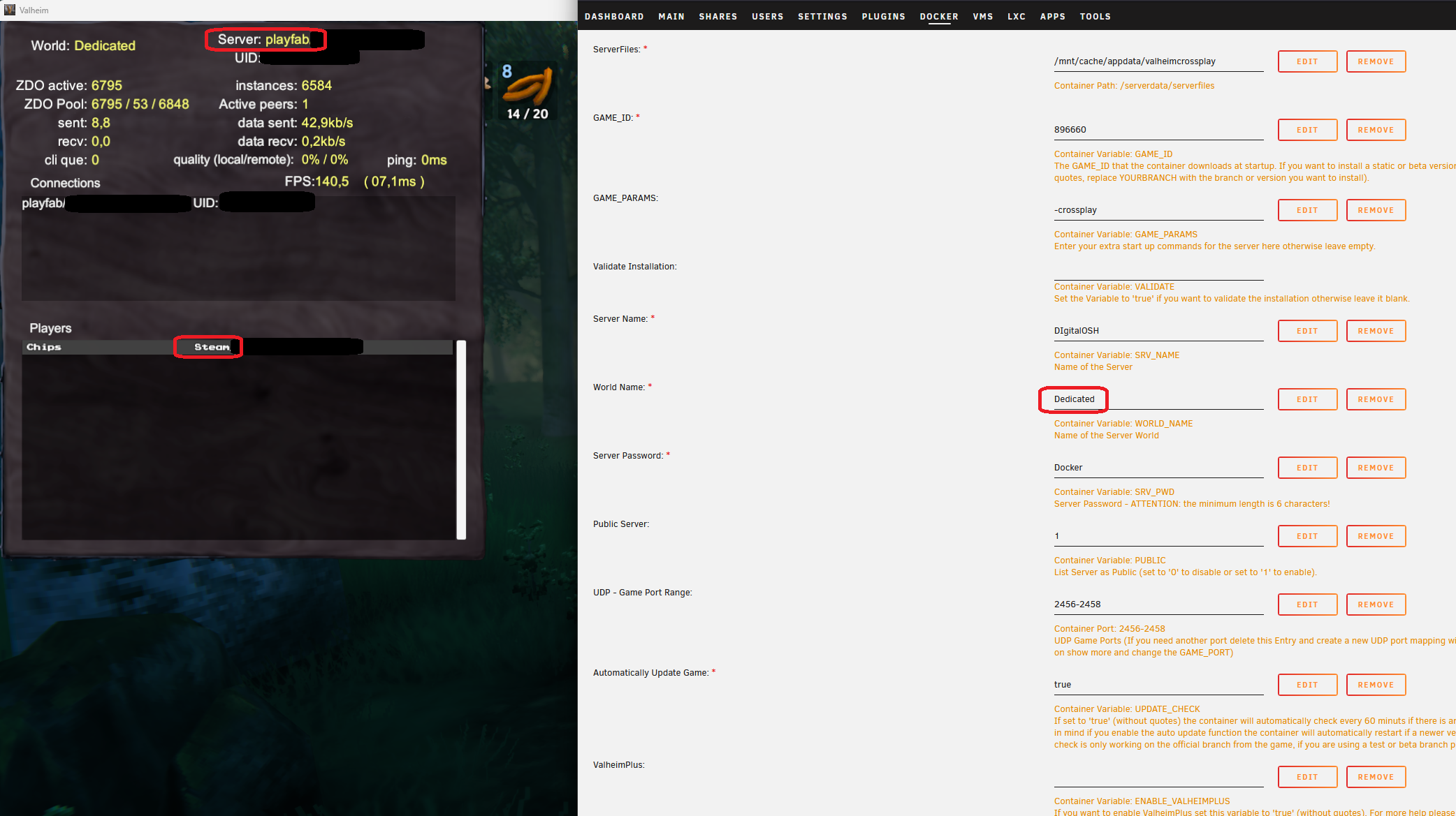

No issue over here:
Please try to connect the server is currently running, as you can see this is indeed a Dedicated Server and crossplay is enabled form the icons right next to the server.
The password is: Docker
EDIT: I've created another screenshot here where you can see that I can successful connect with my Steam Account through Playfab (crossplay), sorry I don't have any consoles:

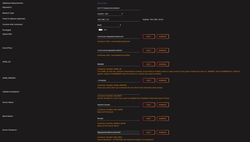

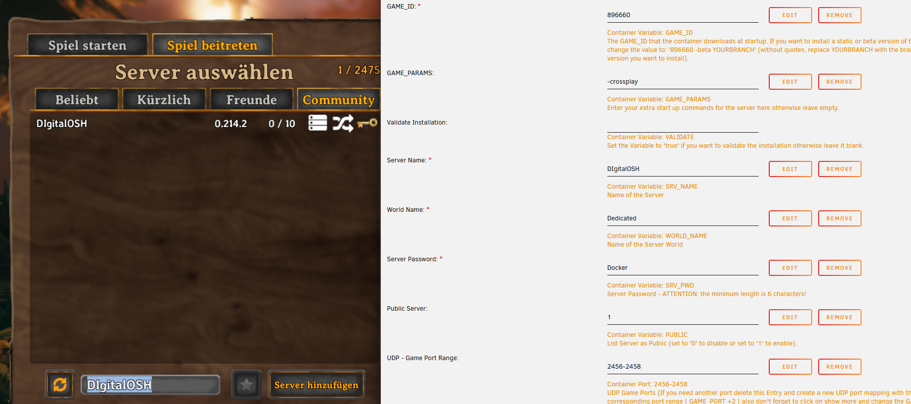

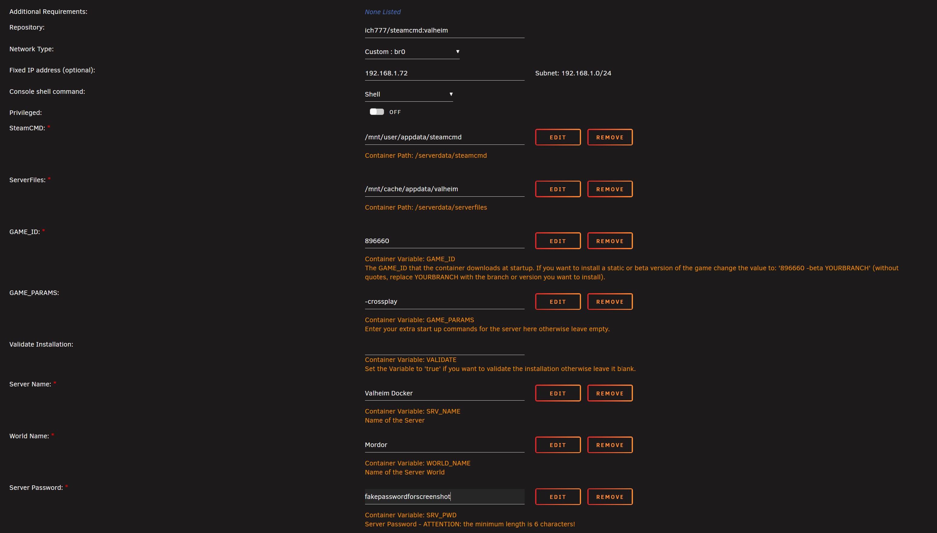

Interestingly, I was able to connect to your server with my xbox, but not my steam deck. I then tested with my server, using both the internal IP and the global IP, and neither steam deck nor xbox was able to connect. Attached is my config:
You have to search by name.
Are you sure that you password is at least 6 characters and you don't have any special characters in it?
I can't help what's wrong in your case, everything is looking fine as far as I can tell.

1 minute ago, DIgitalOSH said:
Sorry, I meant my own server.
Yes exactly, when you play over Playfab I have reports that it's not visible through the local network anymore, but that's not the case for me.

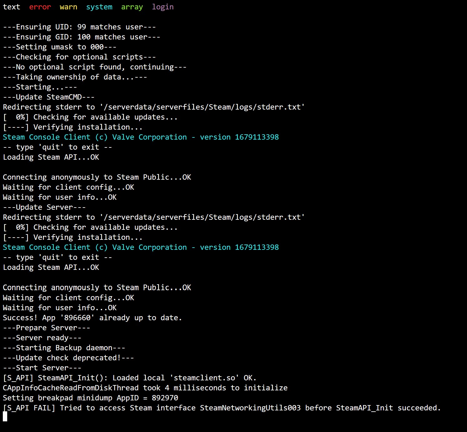

I think the server may be failing to start up when the -crossplay flag is enabled. How can I see the appropriate logs for that, to share?
Click on the container icon and select Logs.

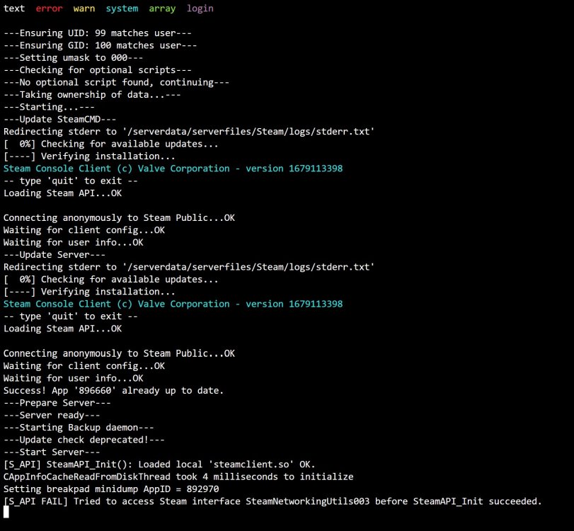

Attached. looks like something failed.
No, this is just the default startup message, it looks the same over here too.
The last line is only a warning and you see at the first line below the Start Server line that it initialized successfully.
OK. The only strand left I can tug on here is that I can't connect to it with anything if the -crossplay argument is issued. What changes when that happens, and how do I investigate that further?
