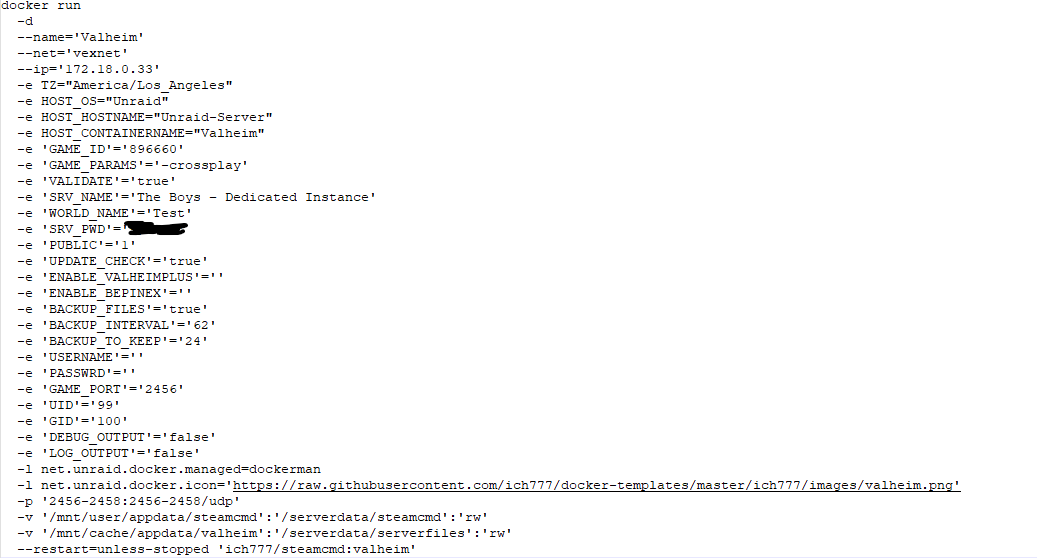

Hello, I am working on setting up a Dedicated Valheim server w/crossplay for my friends. I've hit a bit of a snafu, though, as it seems the '-crossplay' tag isn't forcing the PlayFab information to be downloaded when the server files are being downloaded? ValheimServerLog.thumb.png.2c3ac24f604fcedf7401097d52da5c30.png
My server seems to show up in the community tab and I can access it (running from it's separate Unraid box), but the specific tab does not appear showing Crossplay as working in the server list.
As well, here are my current docker settings as they are in the config menu, I'm running it on a custom Host network, though I saw a few posts within this thread mentioning they may be needing to switch to Host, but I'm not 100% sure. ValheimDocker.thumb.png.c0f35e7a9e68158f6eb9e401ff4a2717.png
Edited by ScottyYDG
Needed to redact a server password.
First of all, please disable validate!
Are you sure that you've updated the server list in your in game server browser? I've now tried it and have no issue and displays the double cross icon right next to the key icon like mentioned in this post here:
Are you sure that nothing is blocking the incoming connection to PlayFab itself?
This shouldn't be necessary at all because the users had issues that the server is even showing up.
Try it in default bridge mode instead.
What you can also try is to set another server name without any special characters.
Have you yet tried the default template (without changing anything) with the parameter -crossplay added?

What are the contents from this file? This is what my file looks like:
Do you know why the server.cfg isnt getting created on my end?
