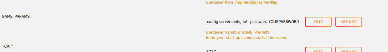

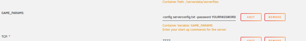

Have you yet tried to add the -password <YOURPASSWORD> parameter to the GAME_PARAMS like:
The container always asks me for the password, which is initially "Docker"
