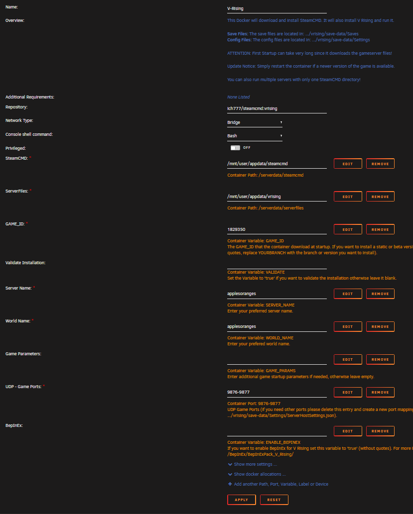

Hey all, feel like im losing my mind over this. Trying to setup Vrising and tried quite a few things.
1) Deleted appdata/vrising and started fresh
2) Changed both appdata\vrising\VRisingServer_Data\StreamingAssets\Settings and appdata\vrising\save-data\Settings Serverhostsettings.json files to reflect the name I put in the docker container, the password and set both "ListOnSteam": true, "ListOnEOS": true,
3) Portforwarded both 9877 and 9876 - I even used playit.gg to create a tunnel for this port just incase.
4) Saw someone recommend to place 'false' (without quotes) in ENABLE_BEPINEX in the docker container.
Here is what im getting in \appdata\vrising\logs\VRisingServer.log
Any help would be appreciated, fairly new to this and just got the game for my friends so hoping to see if i can host it.
Thanks in advance
edit: wanted to mention as well that everytime i try to direct connect it times out. When I try to connect to the tunnel provided by playit.gg it wont allow me since the address ends in port 3215
VRisingServer.log
Edited by tommoore3290
You only have to edit the settings file in this location: .../vrising/save-data/Settings (all other setting files will be ignored, the path is also mentioned in the description from the container)
The server name is set in the template no matter what you set in the config file.
Are you sure that you've forwarded the correct protocol too (in this case only UDP <- TCP is not needed!!!)
Would be the same if you set it to "please do not enable bepinex" or "i dont want bepiniex", just leave it empty.

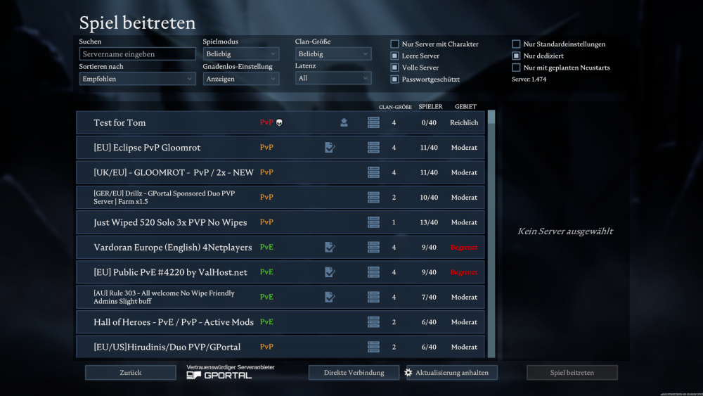

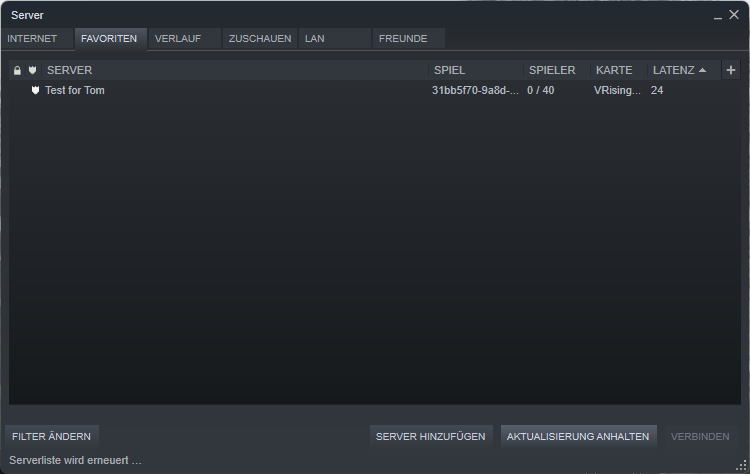

I set up a new instance on my server and I can see it fine in the Steam Server Browser:
If I forward the ports I can see it here too (and of course can connect to it, otherwise you won't see the indication that I have played on it like in the screenshot below):
I don't know playit.gg but the timeout usually means that somwthing with the port forwarding is wrong, if I close the ports then I get also a timeout error.

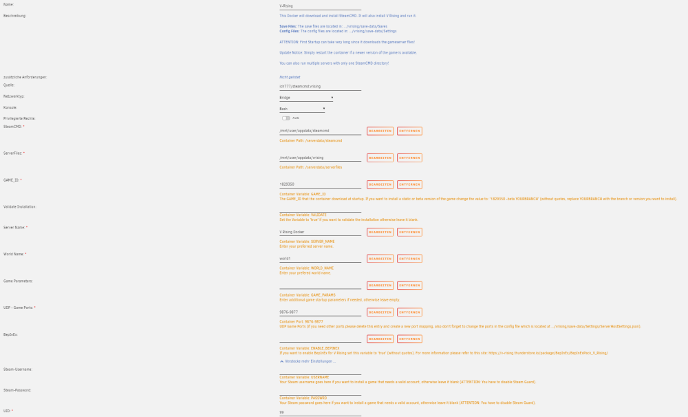

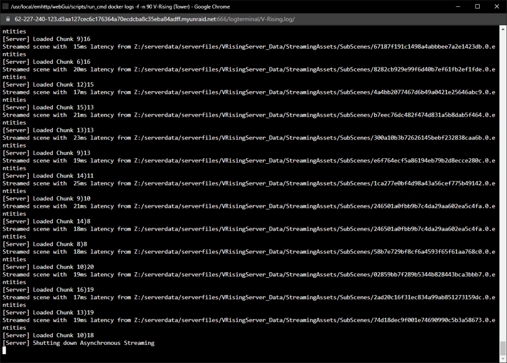

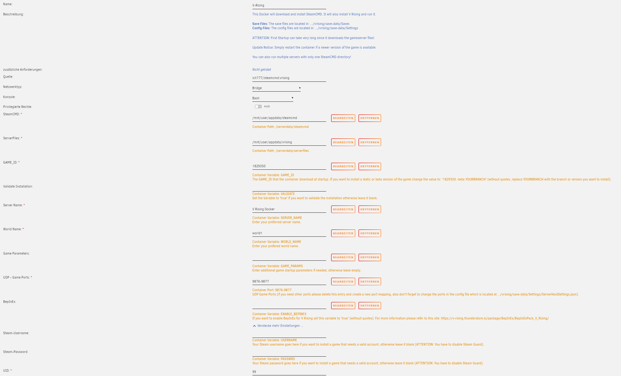

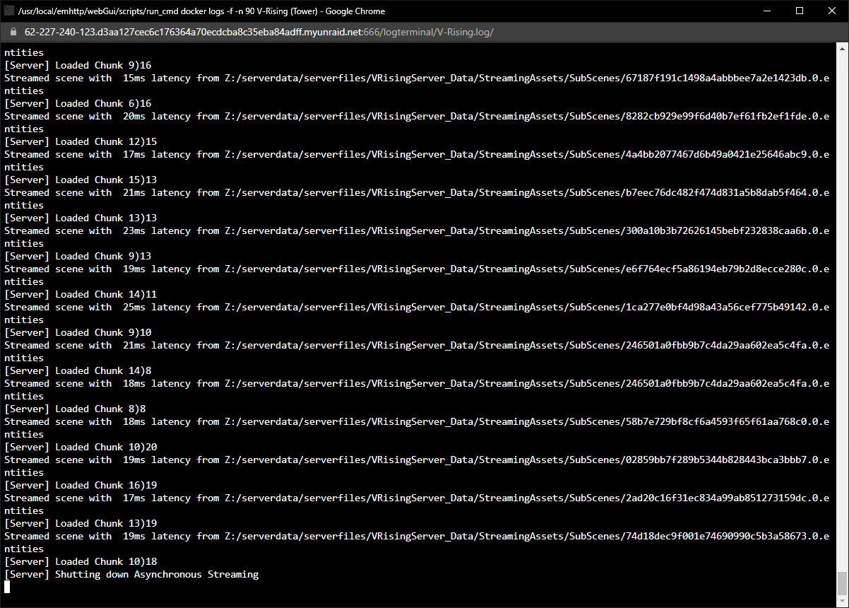

I cant get the V Rising Server to work. Not even localy. I can't see it in the Steam Server Browser under LAN.
And then the Autosaves start.  My config is this:
Do i need Steam Username and Password?
Edited by AdrianSch

14 hours ago, AdrianSch said:
My Logs End with this
This seems perfectly fine and also looks like this on my server.

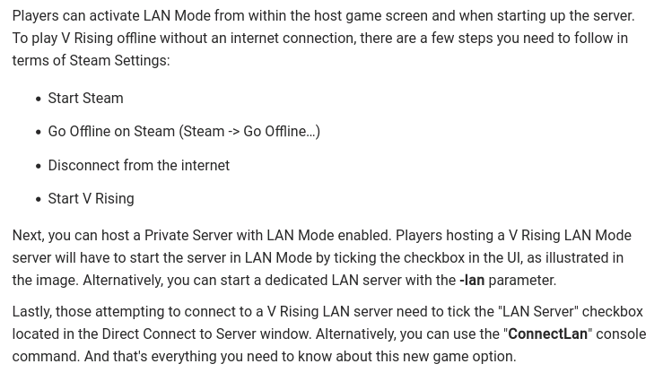

No, if you enter Steam credentials you will break it and it won't work.
If you want to play on LAN or better speaking if you want LAN only you have to append "-lan" to the GAME_PARAMS and also on your client on you local PC, I've made a post about this here:

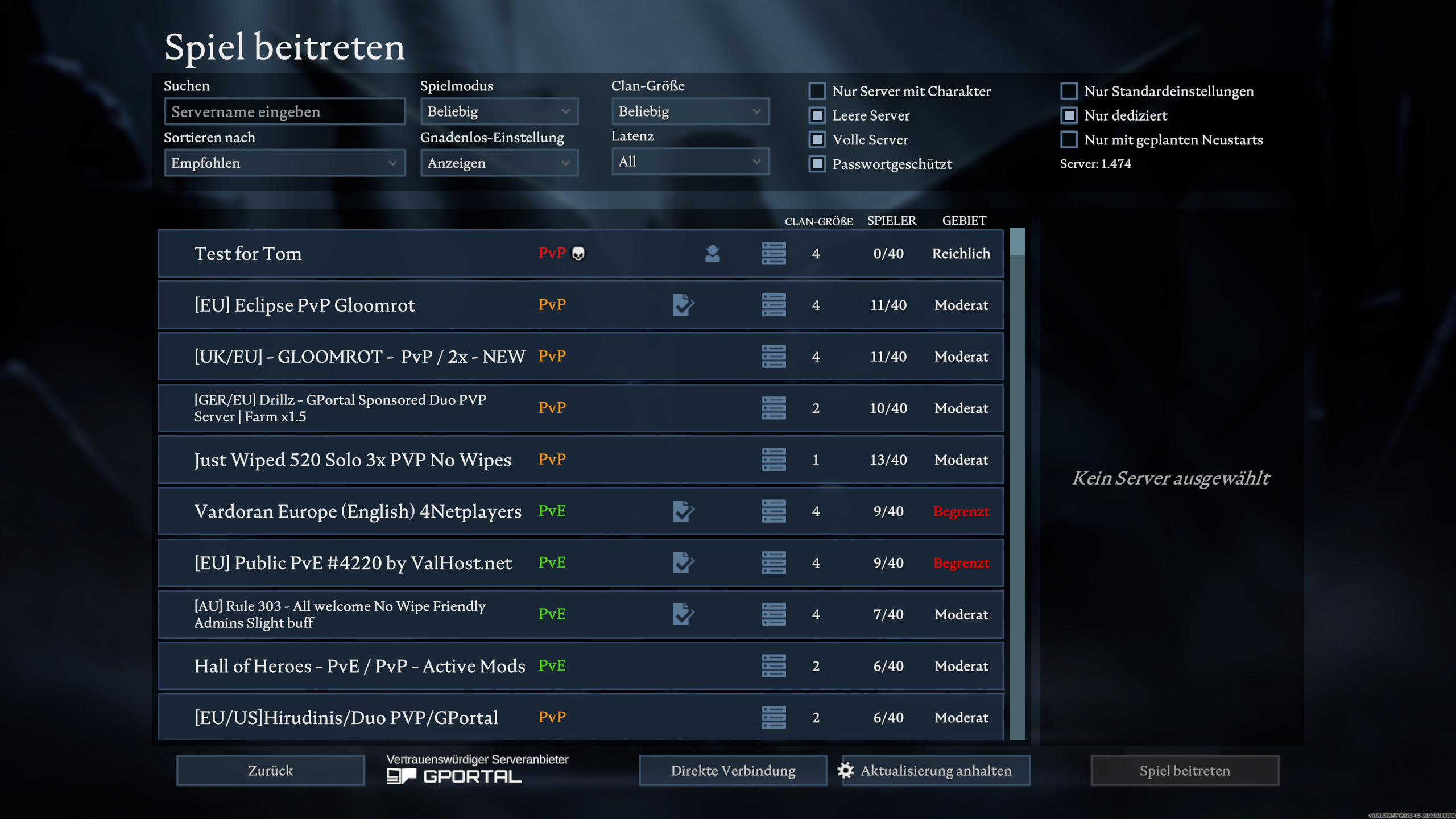

Did you click Refresh a few times, V-Rising is a bit special when it comes to the Steam Server Browser.
What error did you get when trying to connect to the server, please keep in mind that you have to forward the ports in your Router even if you are trying to connect with your local IP if you didn't append -lan to GAME_PARAMS, otherwise it won't work.
Please also double check your port forwarding and also check if you forwarded the correct protocol.

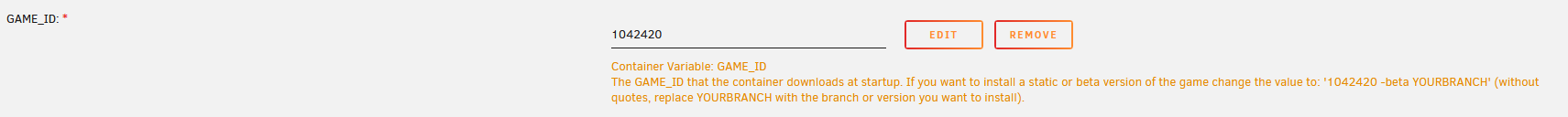

Like pointed out in the description from the template:
just change the GAME_ID from 1042420 to:
1042420 -beta experimental
you also have to set "Validate Installation" to:
true
when switching branches. After the container fully startetd please set "Validate Installation" to nothing or "false" since this is only required so that SteamCMD knows that it has to compre all files from the dedicated server to the ones which are stored on the Steam servers.
If you want to switch back to the default branch simply set it again to:
1042420
and enable "Validate Installation" so that it pulls the files and disable it after that.
