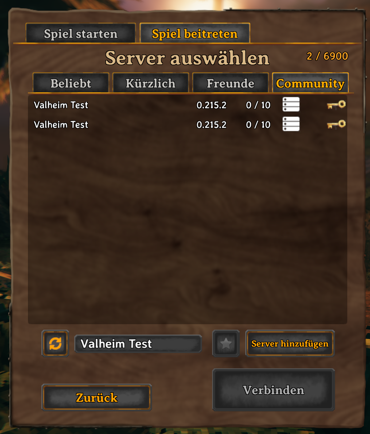

I think you are talking about the Steam Server Browser and not in game correct...? :
4 minutes ago, Ephoxia said:
It's not too big of a deal i just thought it was weird as i'm used to seeing 10 max players not 64. It displays externally with server query or steam server listing.
That's caused because Steam can't correctly interpret for how many players the server is made for but if you are search it in game you will get this:
(please ignore that it is listed twice, one time is over my public IP and one time is via LAN)
Oh okay, my bad then. I just heard from players the limit was 64 so they must have seen it in steam and not ingame.

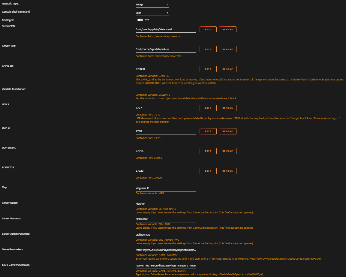

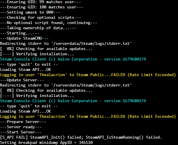

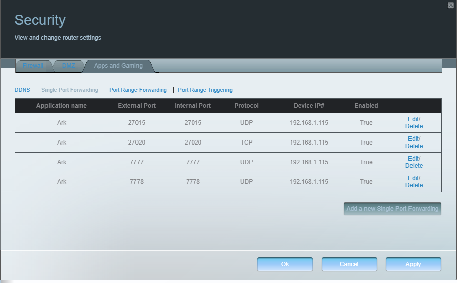

I am ABSOLUTELY lost. I am new to unraid. I primarily use it for a media server. I am trying to start an Ark server and no matter what I do I cannot connect to the server. I have read through Cyd's posts at least a hundred times by now. Ignore the server password haha. I feel like I am overlooking the simplest thing. At this point I'm starting to think it is my ISP. I have looked deep through this topic, steam forums, reddit, ark forums and nothing I try makes any difference. I have been at this for two days now, if I wasn't bald I would have pulled all my hair out by now. The steam login thing is also odd because its the correct password and i havent touched it in unraid, sometimes it logs in other times it doesnt, its like im reaching the limit for successful logins, but that isnt the main concern. The steam server not responding and my ark server not showing up is the main problem. Idk if my ports are wrong or what.
TLDR: Cannot get into Ark server.
Please remove the container from your server, including the arkse folder which lives usually in your appdata directory, then pull a fresh copy from the CA App, change absolutely nothing and let it finish pulling down the container.
From what I can see you've entered your Steam credentials, don't do that unless they are visible in the template (so to speak not hidden in the Show more... section) and marked with a red asterisk, this will most certainly lead to issues.
After the container pulled the game and you see the last two lines from your screenshot from the log from above it is fully started and waiting for new connections, go to Steam -> View -> Server -> Favourites -> Add -> enter: YOURUNRAIDIP:27015 -> Add -> and click Refresh twice
If it shows up you can definitely connect an it is running, please do that first and then we can troubleshoot further.
As said above, don't user your Steam credentials in a template where they are hidden away at Show more... and please don't touch any setting in the Show more... section.
It's almost the same as described for RUST here:
https://docs.ibracorp.io/rust/

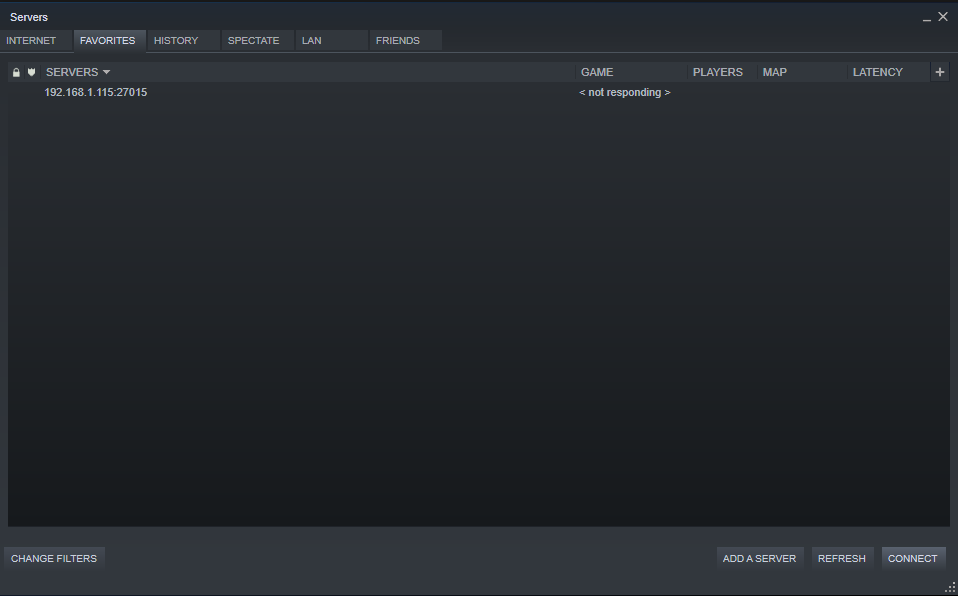

Do you have a static IP? Have you yet tried the way with the Steam Server Browser to add it to the Favorites with: SERVERIP:2457 or from outside with WANIP:2457 ?
There is a pretty high chance that your Firewall is blocking the traffic somewhere.
