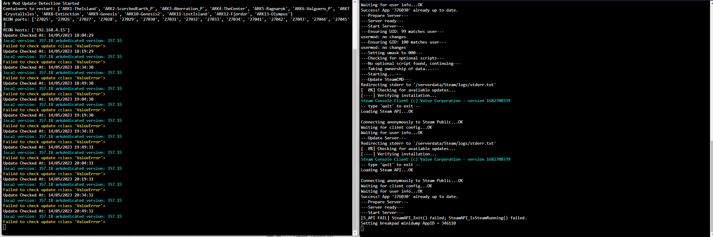

Having some issue with Ark Cluster Servers
Starrted to get this on all my ARK Cluster server but 3 of them have you seen this before
[S_API FAIL] SteamAPI_Init() failed; SteamAPI_IsSteamRunning() failed.
Setting breakpad minidump AppID = 346110
Island Scorched Earth and Abverration work fine
I also see this in my ARKO-A3C
Update Checked At: 14/05/2023 18:04:29
local version: 357.18 arkdedicated version: 357.15
Failed to check update <class 'ValueError'>
On the broken one it show ShooterEntry as the maps

53 minutes ago, edickinson24 said:
@Cyd
We haven’t had our cluster up for months, I do not know if wild card or steam changed anything. Seeing a local version higher than arkdedicated tells me that wildcard is not being exactly diligent in their release procedure. Failed to check update class is likely a change to the steamAPI.
