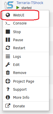

Running t-shock and I can't seem to figure out how to use the server console? The webui doesnt let me type any commands into it to control server stuff like give items and what not.

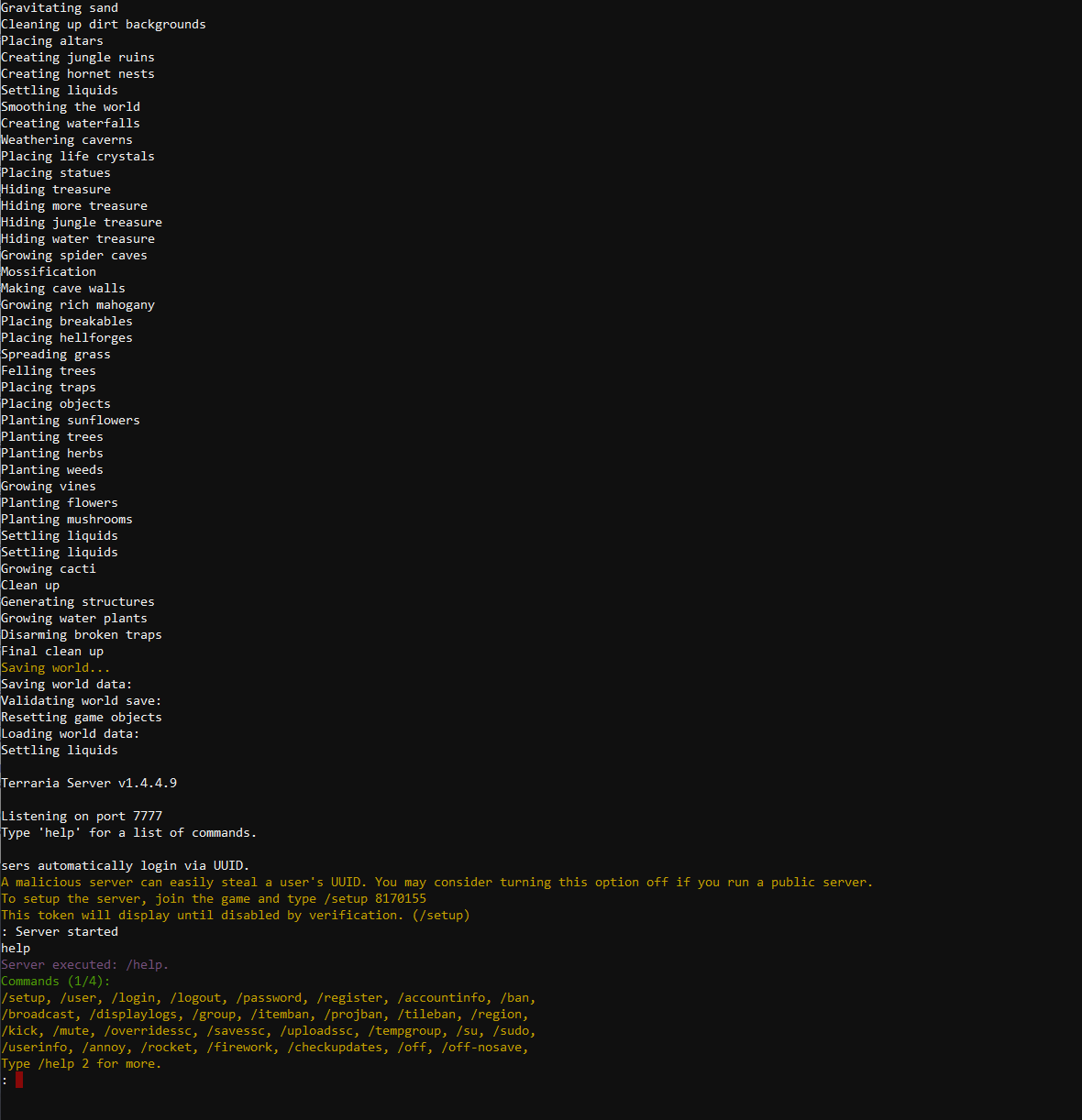

Do you talk about that:
No issue over here (I only typed in help because I don't know the commands but as you can see it is working) :
So weird, mine is all garbled and i cant type. Have tried multiple browsers too.
Edited by ToastedPirate
Can you please try to not start the terminal in a maximized window? Maybe this will help...
Does the container look also look like that?
Another way to connect to the console is to open up a console window from Unraid and type in: 'docker exec -u terraria -ti [Name of your Container] screen -xS Terraria' (without quotes) to exit the screen session press CTRL+A and then CTRL+D or simply close the terminal window in the first place.
This will basically do the same as my WebUI implementation.
