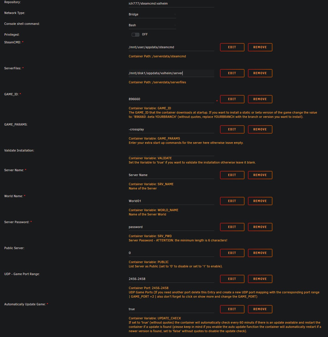

I've attached a screenshot of my container config, in case you want to take a look, but I'm pretty confident that there isn't anything wrong with it. As, like I said, it works fine until you add the '-crossplay' paramater to the GAME_PARAMS field.
I'm completely stumped at this point, so if there's anything you can think of that would help I would be extremely grateful!

I had already tried shifting the Docker container to the host network, which you'd think would eliminated all potential issues, but, for me at least, the problem still persisted. Not sure why.
Out of curiosity, last night I tried moving it instead to the MacVLAN network that UNRAID provides, and that I already use for PiHole. And after an initial hiccup where it managed to connect but then kept repeatedly disconnecting and reconnecting, it managed to stay connected and has remained connected over night.
I was able to successfully connect to the server, both with the Direct IP/Steam networking and the Join Code/PlayFab networking systems.
Not sure why other solutions didn't work for me, or why the default Bridge network has been giving me issues, but if this is the solution to finally have it working then honestly at this point I don't care. I just want to play Valheim with my friends who have Xbox!
Thanks for your time in trying to help me, it is very much appreciated! :)

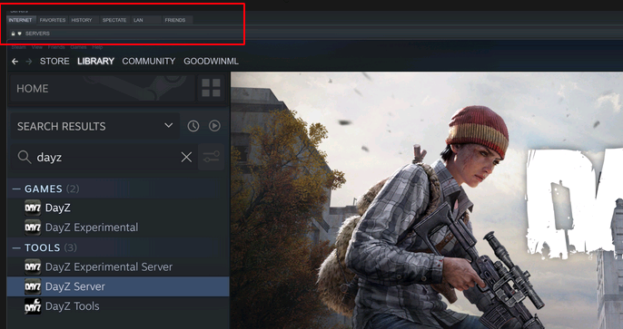

6, Where in steam? I click on view, only option with server in name is "Servers". No "Server Browser.

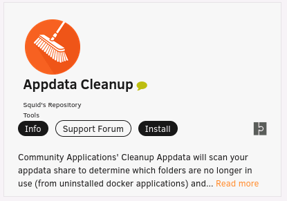

2, delete dayz folder. I am a windows person. How to delete 1 folder like that?
You can do that in the Windows Explorer if you connect to your appdata share or you use Appdata Cleanup from the CA App:
I can see it open in the Background here (it is actually "Servers", I couldn't remember how it's called in English from the top of my head because I run Steam in my native language which is German):

7.  Enter your SERVERIP:27016 (of course replace SERVERIP with the IP from your server) and click on Add
So I use the internal LAN ip and have port forwarding on my router?
********Also don't understand this comment from docker. "Keep in mind that you have to connect with the experimental branch Client to this Docker container!"********
Got it working. Now have to figure out how to modify cfg file for server name and password. Also have to figure out how to add mods to server.
Edited by GOODWINML

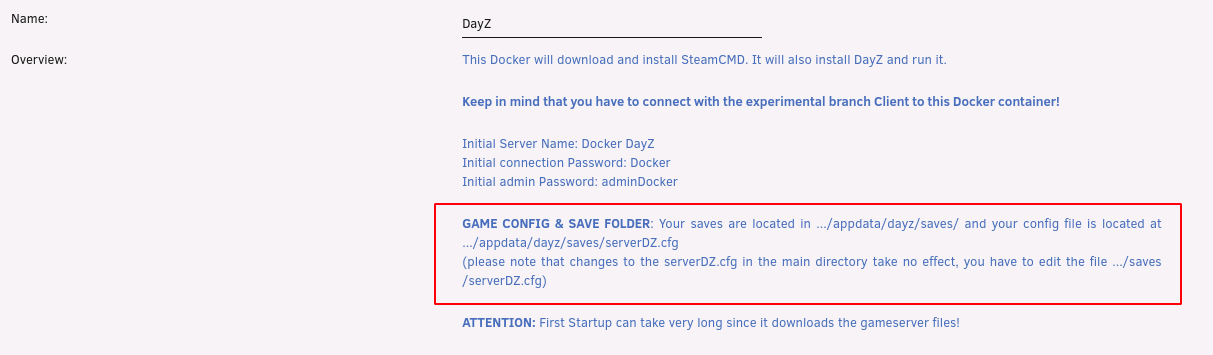

I would recommend that you read the description from the container again:
