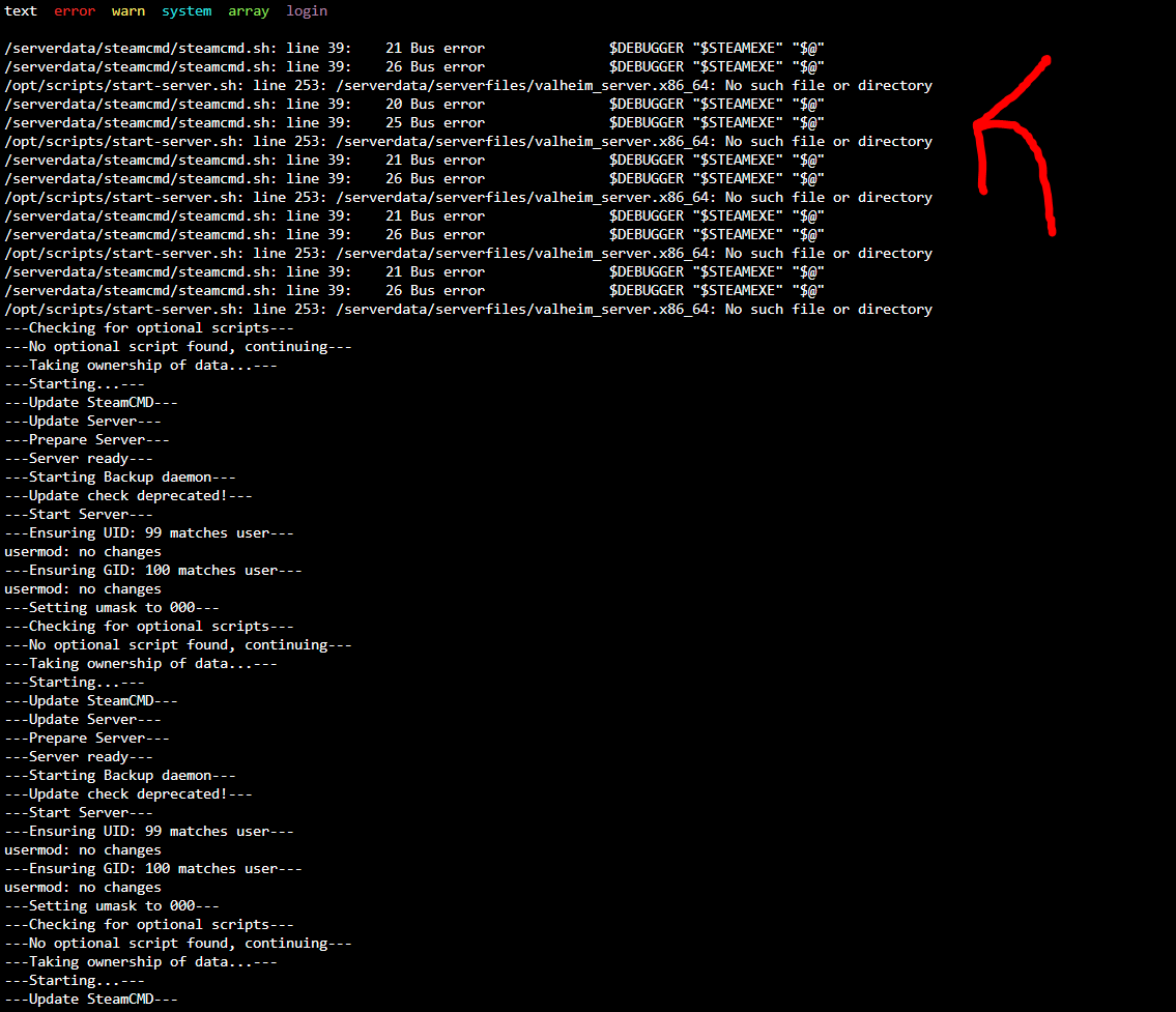

1 hour ago, Zee-Unraid said:
In addition to the above, I also found another user (@Turb0x3r) who had a similar issue, but he was simply doing an update @ich777:
This is a old thread that you've linked and was solved by doing the exact thing that I've recommended to you another user has had also that issue and it was also resolved doing that.
Have you yet tried to
51 minutes ago, Zee-Unraid said:
I also have an additional screenshot from the Docker log saying it cannot locate the valheim_server.x86_64: No such file or directory.
I think there is going something else on with your server, have you yet tried to reboot your server?
Is the valheim_server.x86_64 binary in the valheim directory on your server?
A user reported already a similar issue and the ultimate cause was that his Docker image was corrupt.
EDIT: Sure thing here is the log, I even downloaded a fresh copy from the game and left everything in the template at default: valheim.log

On 3/9/2023 at 3:03 PM, Zee-Unraid said:
Hi @Turb0x3r
Did you manage to solve your issue please?
Thank you!
For some really weird reason it never did pull an update. The newest patch that rolled out a few months back seems to work with the container even when I never saw an update rolled out. I run vanilla with no mods whatsoever.

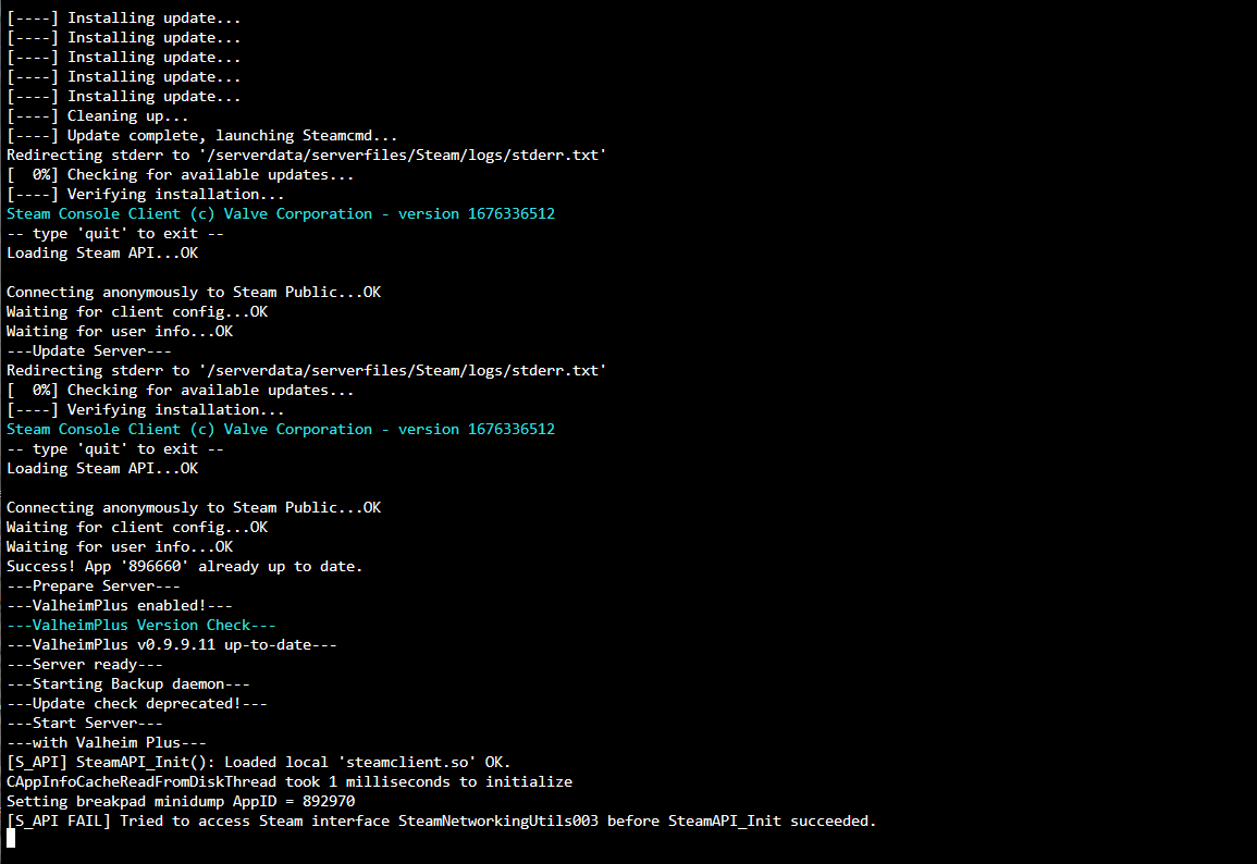

Hello,
So I have been running a valheim server with the docer image for a while now and just found out about valheim plus and wanted to use it. In the logs I do get confirmation that the server started with valheim plus but the issue I am running into is when I connect after I made changes in the config it doesn't appear to apply in game. I can also connect with a vanilla client without having the version check kick me out.
I have cleared my valheim docker folder and have done a fresh install but just cannot get valheim plus to work. Is there a step that I am missing or something I need to enable in order to get this to work?
Thanks
Edit****
Found issue with today's valheim patch that causes valheim plus to stop working and have no effect on the game.
Edited by Nspringer
Can you please share a screenshot form your template?
Are you also stopping the container first, edit the files and then finally start the container again?
Do you have a cache drive installed? To what is your appdata share set in terms of Use Cache?
So basically ValheimPlus needs to be updated to support Valheim again, correct?
Hi @ich777,
Apologies for only just getting back to you on this topic. I wanted to let you know that deleting my steamcmd folder in my AppData and forcing a fresh download of SteamCMD seems to have solved it. No directories or files were being downloaded in the Valheim folder other than "Backup" and coupled with the error in the Docker log saying "cannot locate the valheim_server.x86_64: No such file or directory.", I suspected something could have gone wrong here/ corrupt steamcmd files and it appears to have fixed it.
At least this might be another option for you to recommend to other users having a similar issue and is a viable option to try for the future.
Thanks for all your help as always!
Zee
Yes, it appears that is the case.

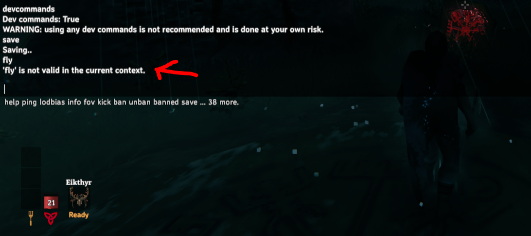

Hi @ich777,
I am trying to also add the -console GAME_PARAMS to my -crossplay server to allow me to use cheats such as "fly", but I cannot get it to work.
I saw a YouTube video recently posted where a user was able to get these commands to work, assumingly in single player - but the important thing is that they work on Xbox console. He was unable to solve the debug command though.
Do you know how I can activate cheats such as "fly" in my crossplay server, am I adding it correctly to GAME_PARAMS? See screenshot. I am logged into my Steam version of the game, on my crossplay server, and cannot get the commands to execute? See final screenshot "'fly is not valid in the current context'".
Are you able to get this to work if you create a crossplay server with no mods please? Perhaps I missed something.
Thank you
Zee
Edited by Zee-Unraid
The console command is only meant for the client, not the server.
AFAIK, cheat's don't work on dedicated servers (I think this is actually a good decision to not allow cheats on a dedicated server).
EDIT: Please also look here.
