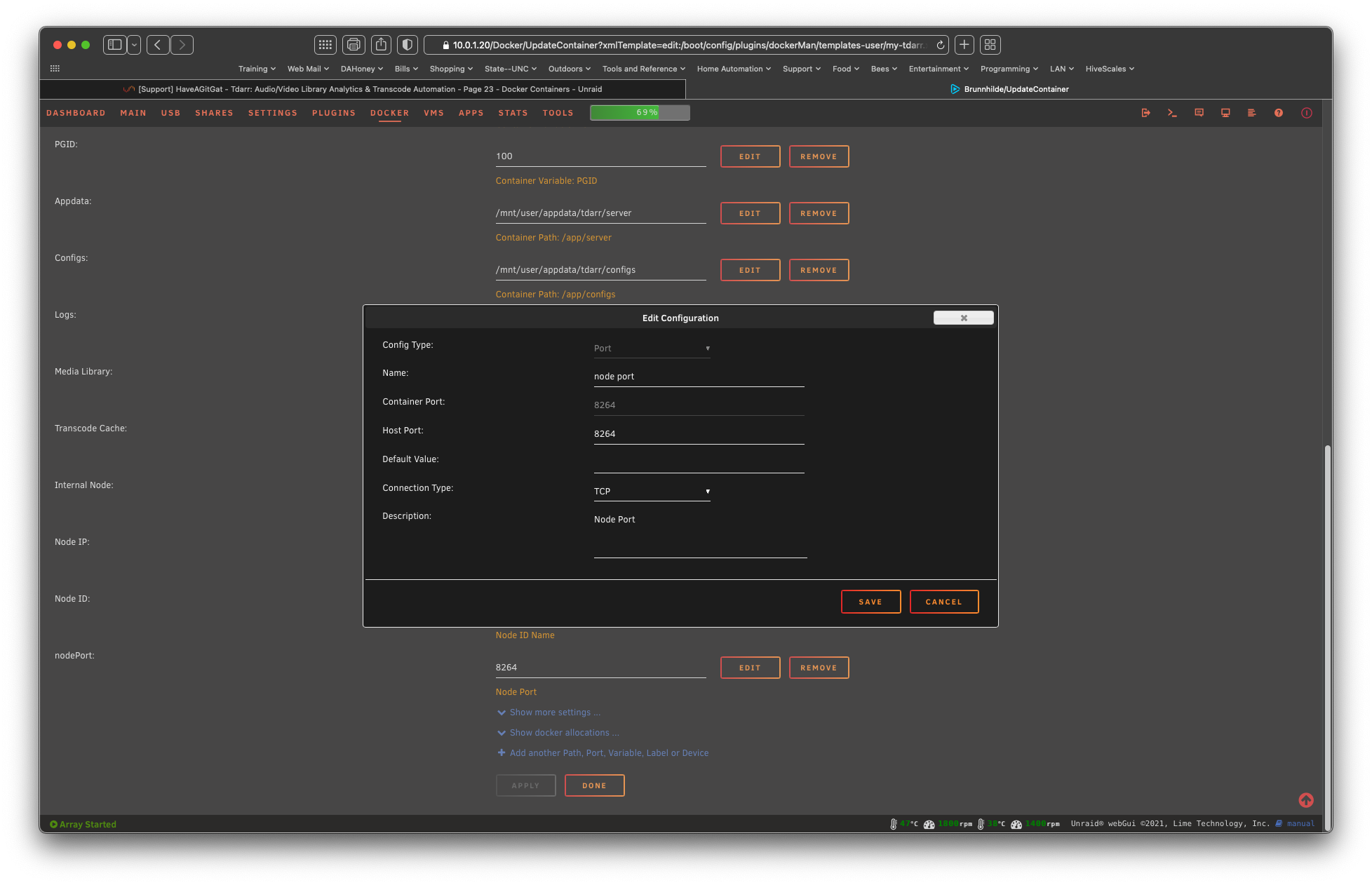

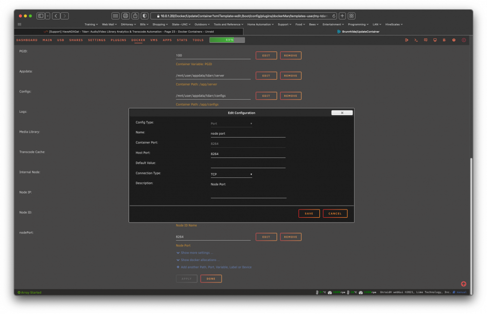

Hey, my install failed, is this variable correct? it says there is an invalid entry in docker pull down. What is the proper variable or is it port, should It be port or variable here, this is on the template so mabye there is a mistake, it fails unless i put it as a variable and when it does install it wont load web ui from the node nor node show up in tdarr. help me please, why is this installation failing?
Mine did the same thing. I have an issue open on GitHub.
The only way Ive found to get a successful install is to delete the path for node port. This will allow the TDARR docker to run but you won't be able to use the internal node. You'll need to also run the TDARR_NODE docker. Or you can wait until the bugs are worked out in the template.
I installed it by deleting the entry for node port completely and by creating a variable sort of like the one for server port but its not a port its a variable and it still doesn't work after the install. I wonder how long this will take before it gets addressed. months?...... I think its worth searching for an older version of the app where i can install it with a docker command line and mabye get it funtional that way but knowing that the version needs to match for all components I don't know if I can find the correct versions for all my windows nodes too.
Edited by RYZEN5000
The new templaplate has already been merged and should be installed in the next few hours but if you want you can delete the node port and add a new port-
678069216_ScreenShot2022-02-24at3_11_25PM.thumb.png.f0d2170bb976297b0466584da9f59cb3.png
Tdarr is working now! Docker template is fixed now, I was playing around with docker compose scripts for a few hours trying to install it that way but I went back and tried it again and its been updated to beta version with node installation included. It installed the node automatically.
But what a pain in my arse it was soo difficult to install it by docker compose, it installed alright but the port mappings were not working at all, I'm glad somone fixed the docker template and included the node this time, thats a better way to do it, and here I was thinking it wouldn't get fixed for a very long time but it was faster than expected and I'm just getting ready to map for my other windows PCs to make them nodes now that all my programing from before is probably not going to work but we will see about that soon! Im Transcoding now, hope it doesn't take long to catch up I'm mostly converted to HEVC but each week I do another run and shrink my new downloads and keep on downloading, keep torrenting, I'll never stop, not till I cant fit anymore 16TB drives in my case, I've been torrenting on this new server since October 8th it was AGKSERVERS birthday and hes a real beast but I haven't fully added all the drives yet just 48TB plus 5.5TB cache. 4 more bays left them I'm adding more drive racks inside because the case is huge its packed but theres room if I move some fans and wires I think I can fit 20 drives and I want to buy more 16TB or 20TB drives. Tdarr is working! Health checks are intensive on my ryzen 7 5800X but when they finish my cpu will run around 5% transcoding with GPU. I hope my build inspires others to build a nice new Unraid server. It is my favorite thing to play with.AGKSERVER1.thumb.png.cbbd203594b028bf31ec0e052ab08257.png
Edited by RYZEN5000

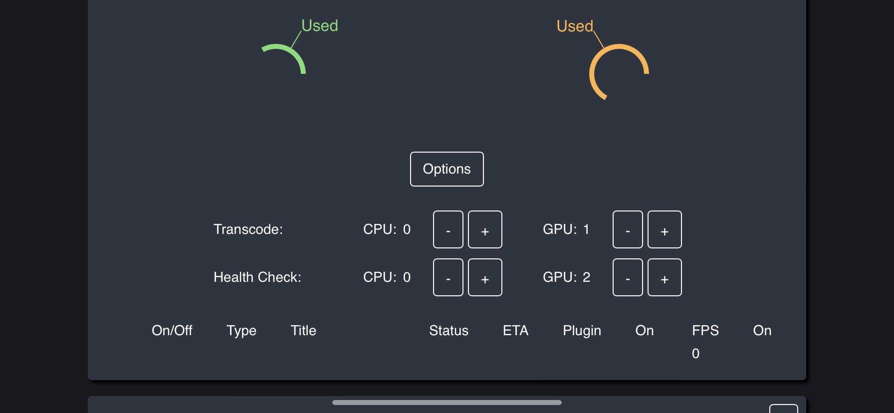

i found something strange.
I have only one node. Server and node are dockers on my unraid server with default parameters except for ip of course.
If i change the node name which is defaulted at "node name", the queue is stuck.
As soon as i set it to "node name" back the workers start.
What are the transcode options set at for the new node?
it's not a new node. All was working until i changed node name.
and the other options
