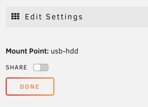

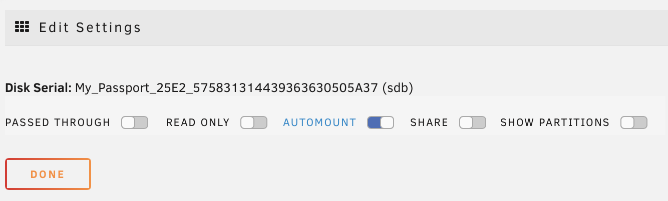

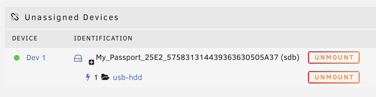

  1. Strange problem where after every reboot (or maybe array stop/start) my attached USB's partition is visible as an SMB share despite having sharing disabled at the disk and partition level. Enabling then disabling sharing in the partition's settings fixes it. Anyone else seeing this?
