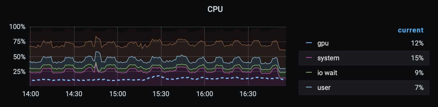

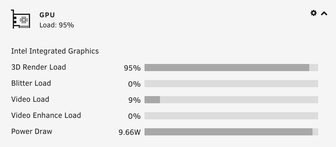

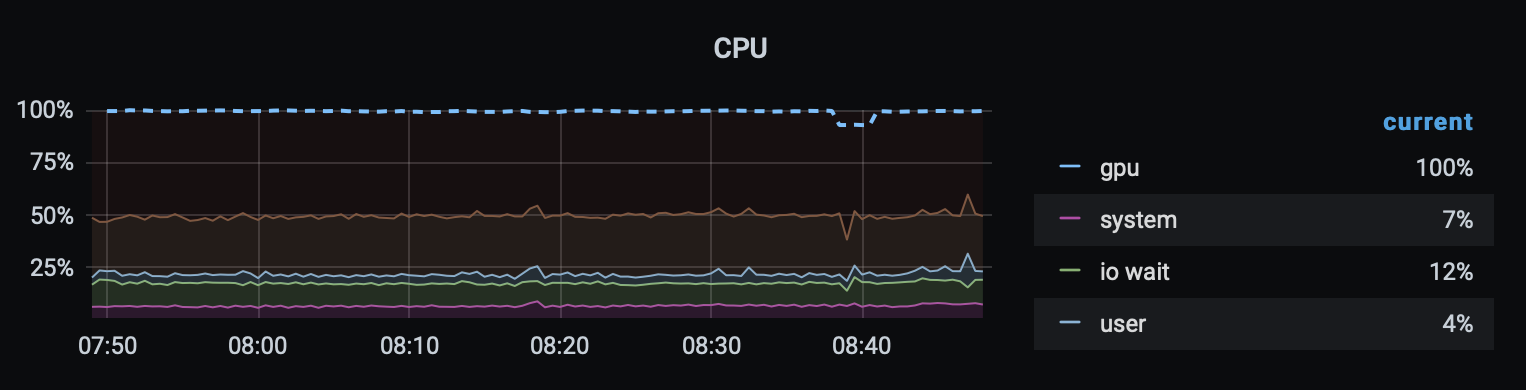

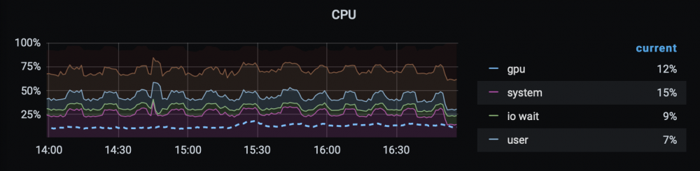

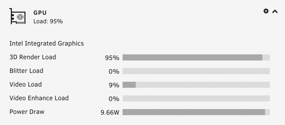

First thanks for this container, very handy. One suggestion: I was running batch conversions in HandBrake and couldn't figure out why my iGPU wasn't fully utilized: It turns out it was but it was maxing out 3D render load (95%) and the reporting script (get_intel_gpu_status.sh) grabs video load (9%): So I tweaked the script to grab whatever's highest: #!/bin/bash #This is so messy... #Beat intel_gpu_top into submission JSON=$(/usr/bin/timeout -k 3 3 /usr/bin/intel_gpu_top -J) VIDEO_UTIL=$(echo "$JSON"|grep "busy"|sort|tail -1|cut -d ":" -f2|cut -d "," -f1|cut -d " " -f2) #Spit out something telegraf can work with echo "[{\"time\": `date +%s`, \"intel_gpu_util\": "$VIDEO_UTIL"}]" #Exit cleanly exit 0 I overwrite the container's version with the following Post Argument, where utils is a new mapped path to the folder containing my tweaked version: && docker exec intel-gpu-telegraf sh -c '/usr/bin/cp -f /utils/get_intel_gpu_status.sh /opt/intel-gpu-telegraf/; chmod a+x /opt/intel-gpu-telegraf/get_intel_gpu_status.sh' (Full path to cp is necessary because cp is aliased to cp -i) Now the display reflects full utilization:
