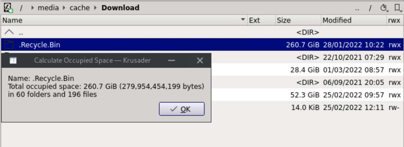

  7. I wish I'd investigated more before "fixing" it but I noticed my cache was much fuller than it should be. Recycle Bin reported 11GB used on my (cache-enabled) Download share but according Krusader it was actually 260GB: Emptying the share's Recycle Bin from the settings page got it down to 0. Anyone else seen that? (I have mover tuning setup to exclude .Recycle.Bin dirs but I don't think that would affect it.)

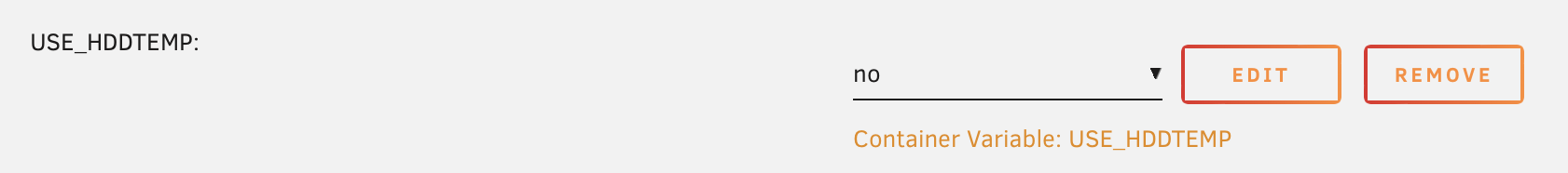

  22. And you're sure they sleep with the container stopped? Maybe you have USE_HDDTEMP set to yes? If not I don't know what could be causing it.
