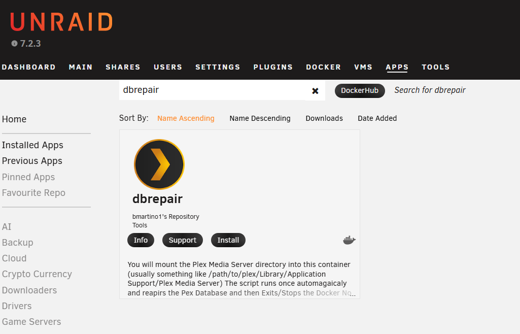

1st post picture your too far deep you need to mount /mnt/user/appdata/Plex-Media-Server As the Libray folder need shown... this should be the same as your appdata folder... https://forums.unraid.net/topic/196453-support-plex-db-repair-docker/#findComment-1601211 This is the only thing that needs set to run... the continer will then see /config/Library and things will work as intended... Its the only data I don't have that the end users must set. as you can see my appdata for plex is different and each docker is different for appdata... my scirpt will traverse into the databse folder folwing default folder nested...- [Support] Rocket.Chat

step 2 is optional stop trying to set it if you don't know...- Unraid plexinc/pms-docker plex database corrupted. Help navigate through the madness
the issue you have atm is your calling a plex docker image and not my docker image: you may need to delte your cuirent tempate and reinstall per teh CA Docker template: go to select teh template: and hit the x to remove the tempalte: then go to the apps page and install... Your making this more complcated then it actual is...- Unraid plexinc/pms-docker plex database corrupted. Help navigate through the madness
either or pick one. this is how my docker identifes the plex continer. by default it will search unraids dockers for anythign conting plex I recomend using the repository image as its a direct this one and kill.- Unraid plexinc/pms-docker plex database corrupted. Help navigate through the madness
I see whats going on now... appologies for my over sight i didn't see what you rarly had on screen shot.. as in thoery the only thing you frealy have to do is add teh appdata folder to the plex Library and click apply no other chnages should be necessay to run a automatic repair... what I recomend is opening 2 web pages in unraid... this way we can grab the data needed... so in one page be at teh dm repair install page noted on teh left. and edit your plex docker to grab the needed data form the right... example: Step 1 set the Plex folder path: OPTIONAL / Recomend step 2 set the container name or image OR thats it... run my docker dbrepair... - [GUIDE] Matrix-Synapse w/ postgres DB (chat server) + Element (web client) + Coturn (voice)
