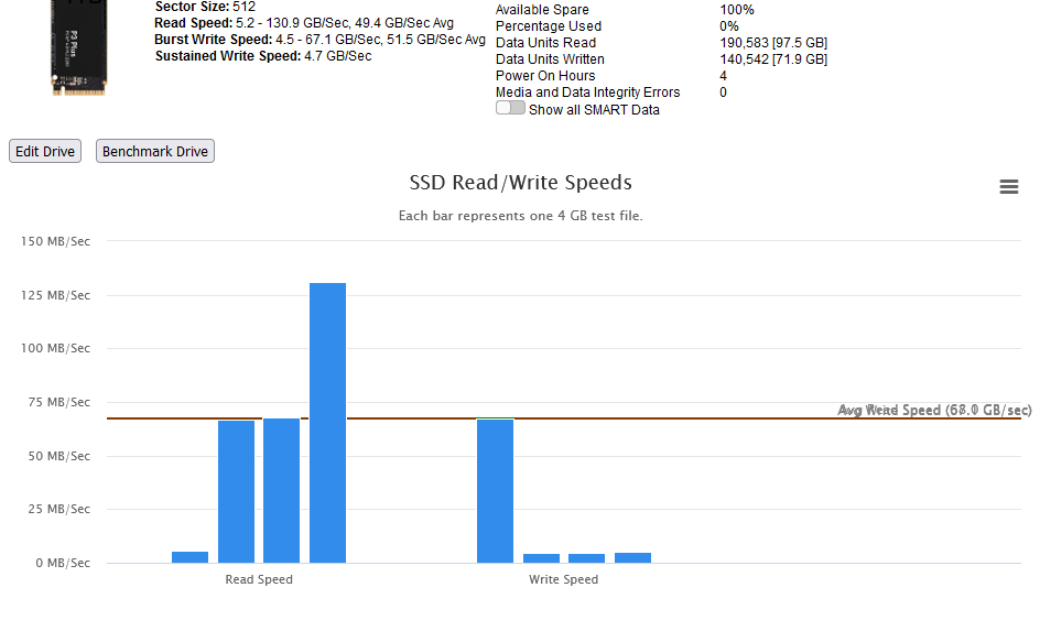

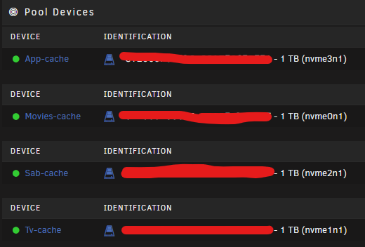

  14. Assembled a new server and got 4 - 1TB NVMEs in a Asus Hyper M.2 card. All cards are mounted as individual cache pools. I added the path for SSDs but get this for the app-cache nvme. I can benchmark the other 3. Identified mount point /mnt/UNRAID/app-cache does not have 5GB available space. Also..the graph values and speeds don't make sense.
