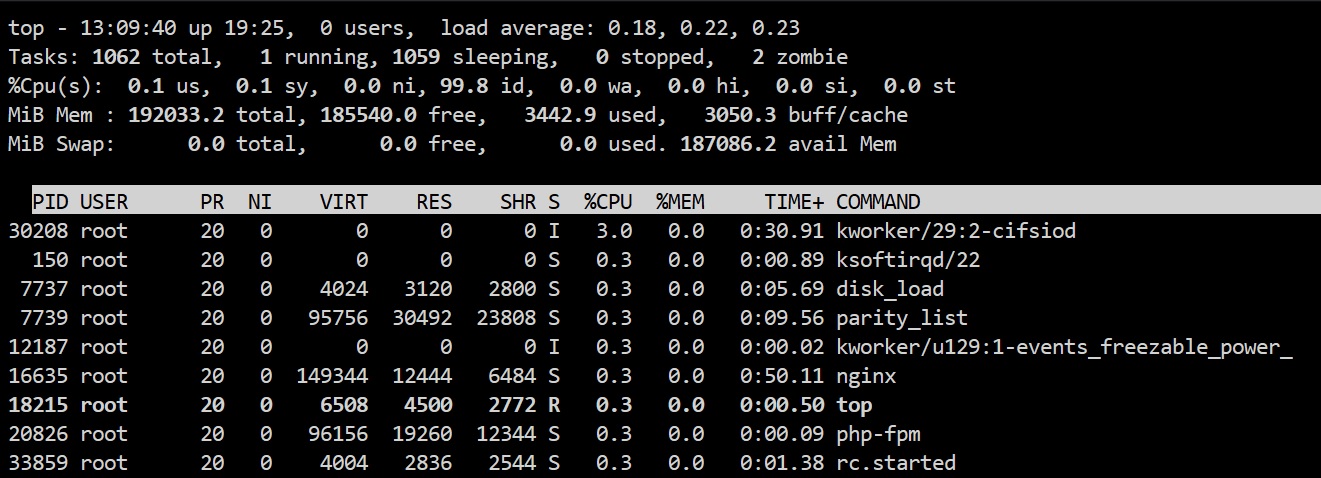

  2. I noticed an odd issue with SMB remote shares after my upgrade from 6.12.4 to 6.12.8. I was seeing a 30 to 40 watt higher power usage on my servers if I mounted an SMB share using the computer name for example //Tower/Backup. If I mounted as the IP address ( //192.168.1.1/Backup ) I do not see the increase in power usage. It does not matter if I manually mounted the share or by a script, the same thing happens. After about 10 mins a process named kworker/##-#-cifsiod starts using CPU. While the CPU load is not very high it does drop my battery backup runtime by a good 5 to 7 mins between both servers. I don't believe this is specifically a UD issue probably more of a 6.12.4 to 6.12.6/8 issue. I was running UD 2024.02.17 on both 6.12.4 and 6.12.8. This issue did not appear in 6.12.4 but does show up in 6.12.8. Upgrading to UD 2024.03.03 has the same results. The work around is easy, update my scripts using the SMB share name to the IP address. I usually left the SMB share mounted all the time between the servers but I am probably going to change my scripts to mount the share only when needed. I use the shares to run some backups between the two servers, the connection is not needed all the time. I read through the last 12 pages in the forum and did not see anyone else post about this, my apologizes if it is a duplicate. I wanted to post in case anyone else is seeing the same thing.

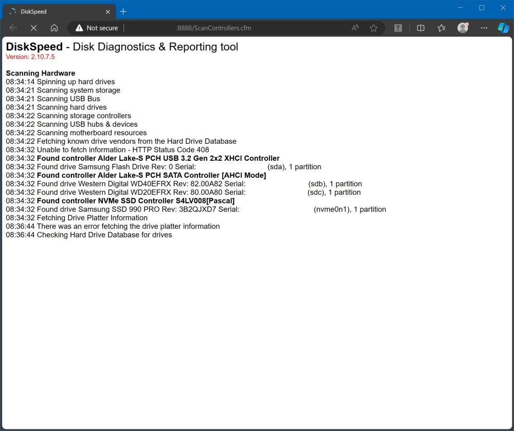

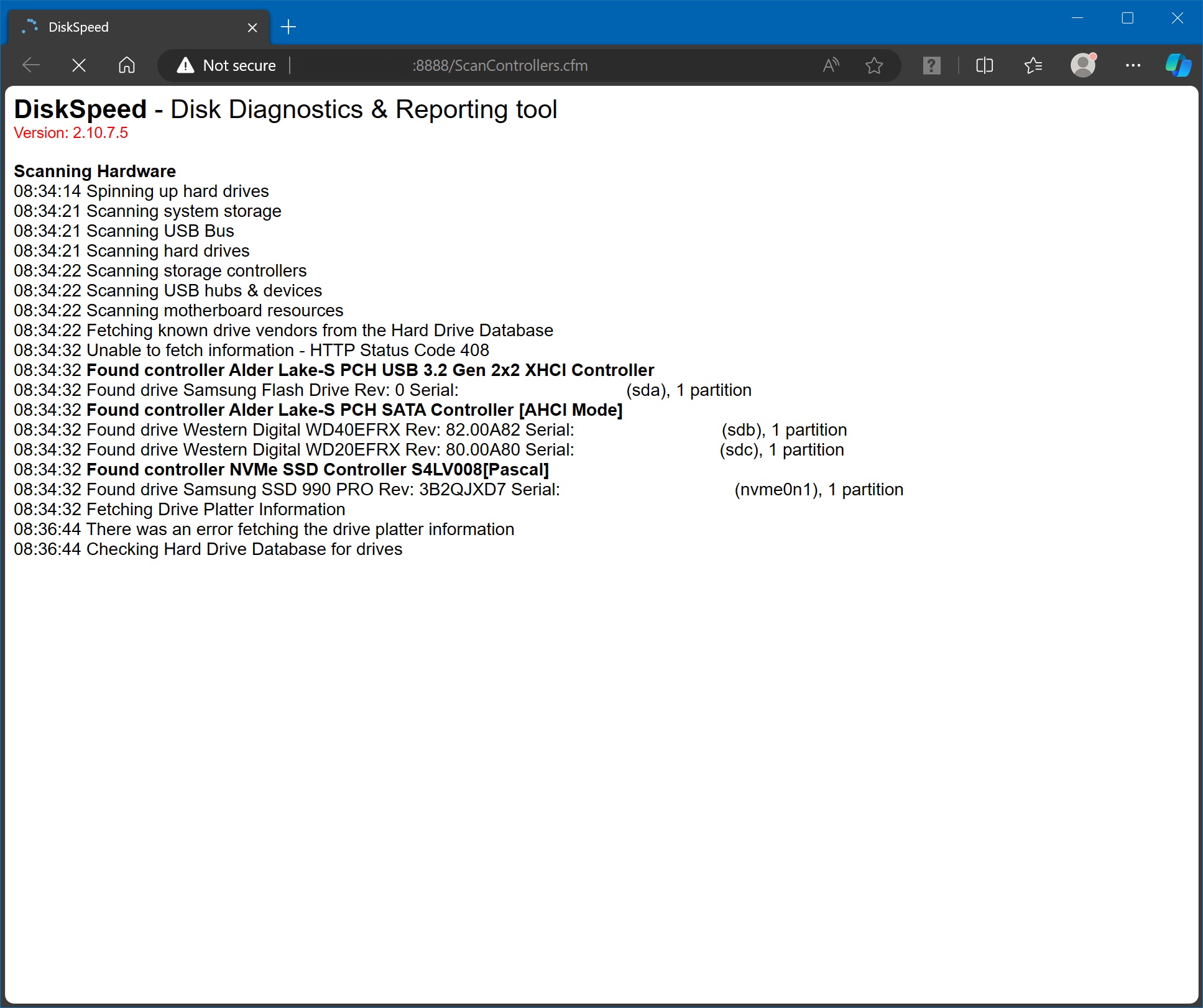

  5. Good morning, I updated to 2.10.7.5 and unfortunately I still have the blank screen issue on my one server. My other server with the HBA card works fine. I did have an odd issue on both servers though experiencing a two minute time out error Fetching Drive Platter Information. I guess my server with the issue falls under the cloned drive scenario you mention above since I have one data drive and one parity drive? This was a new build and when I added the drives I did a new config to add them.

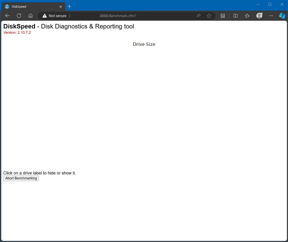

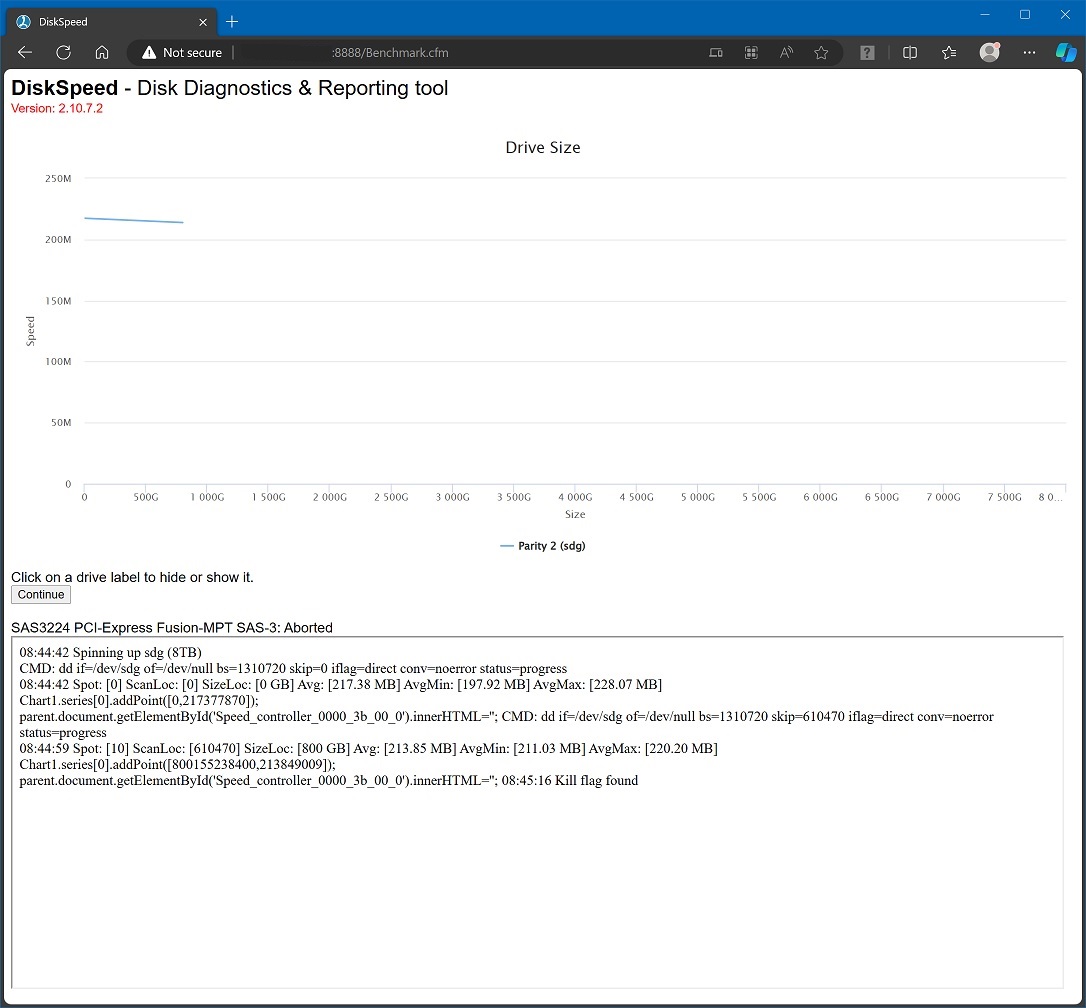

  7. I must not be looking in the right place because I can not find code similar to what you listed. When I run inspect the only difference between the working server and the server not working is this error: Benchmark.cfm:166 Uncaught TypeError: Cannot read properties of null (reading 'style') at CheckForFinished (Benchmark.cfm:166:42) at Benchmark.cfm:173:1 CheckForFinished @ Benchmark.cfm:166 (anonymous) @ Benchmark.cfm:173 On the working server I can click on the area behind the period and get the iframe window to show: On the server not working clicking in the same area does nothing: If I view the source code on the working server it looks like this: </script> <form action="index.cfm" method="get"><input type="submit" value="Continue" style="display:none" id="continuebutton"></form> <table border="0" cellpadding="0" cellspacing="0"> <tr> <td valign="middle"> <div id="controller_0000_3b_00_0">SAS3224 PCI-Express Fusion-MPT SAS-3: Starting...</div> </td> <td>&nbsp;&nbsp;</td> <td id="Progress_controller_0000_3b_00_0_td"> <table border="0" cellpadding="0" cellspacing="0"> <tr> <td><progress id="Progress_controller_0000_3b_00_0" value="0" max="100"></progress></td> <td>&nbsp;</td> <td><div id="Progress_controller_0000_3b_00_0_Per">0%</div></td> <td>&nbsp;</td> <td><div id="Speed_controller_0000_3b_00_0">&nbsp;</div></td> </tr> </table> </td> </tr> </table> <iframe src="BenchmarkDriveController.cfm?Controller=0000%3A3b%3A00%2E0&Drives=sdg&Per=10&scanid=1699015482305&Seconds=15&Slots=sdg-0&DisableSpeedGap=1&SSDSpot=1&&MaxBytes=8001563222016&MinSSDSpaceFree=5&DetectSSDBuffer=0&TestFileSizeOverride=0&WaitBeforeRead=5&SeriesList1=Parity%202%20%28sdg%29&SeriesList2=Parity%202%20%28sdg%29" width="1200" height="400" style="display:none" id="controller_0000_3b_00_0_debug"></iframe> <script language="Javascript"> var Debugging=0; function ShowDebug() { if (Debugging == 0) { Debugging=1; document.getElementById('controller_0000_3b_00_0_debug').style.display='block'; } else { Debugging=0; document.getElementById('controller_0000_3b_00_0_debug').style.display='none'; } } </script> On the server not working the source code looks like this: </script> <form action="index.cfm" method="get"><input type="submit" value="Continue" style="display:none" id="continuebutton"></form> <script language="Javascript"> var Debugging=0; function ShowDebug() { if (Debugging == 0) { Debugging=1; } else { Debugging=0; } } </script> I know this isn't exactly what you asked for but I hope it helps. Let me know if you need more.
  8. Afternoon, I have the same issue as others who have reported a blank screen when running a benchmark on a drive. I can benchmark NVME drives normally and the controller normally. It is just the SATA drives connected to the onboard SATA controller that will not benchmark. The motherboard is an Asus Pro WS W680M-ACE SE. The controller shows as: Alder Lake-S PCH SATA Controller [AHCI Mode] ASUSTeK Computer Inc. (Intel Corporation) SATA controller Type: Onboard Controller The benchmark never times out and I don't get an error. Clicking on Abort Benchmark buttton does nothing. I tried running ShowDebug in both Chrome and Firefox but can't get the iframe error to show. I am running version 2.10.7.2 on Unraid 6.12.4. I have another server running 2.10.7.2 on Unraid 6.12.4 but the SATA drives are connected to an HBA card. That server everything benchmarks fine NVME, Controller, and SATA drives. Let me know if you need me to provide more information.
