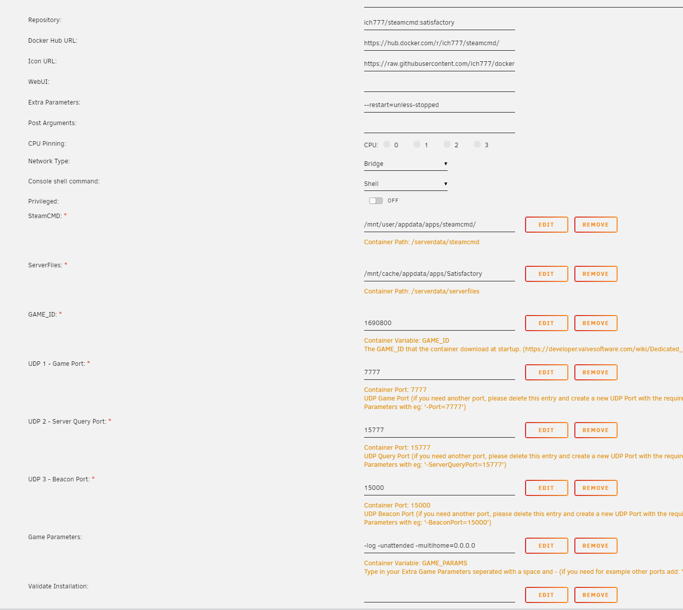

  9. Ah sorry, yes when I start it, it did update SteamCMD and the satisfactory in general. What I was wondering is for the docker itself, it shows as unlinked so say if you change something in the docker I guess it doesn't update to your changes?

  11. Question: Is this right? seems the update for the docker is unlinked which makes me think something in my config is off

  16. So I am not entirely sure what was going on. I must've restarted the container like 20 times. Sometimes it looked as if it was updated steamcmd, other times not (I am not sure if the update was failing or something). In any case, I simply enabled the validation, ran it once until it loaded right, then disabled validation. Not running experimental as far as I know (I see no flags for it).
  17. So for Satisfactory I am getting a version mismatch. I have tried re-starting the docker repeatedly, several times it looked as if it was updating SteamCMD but it doesn't do that anymore. Still my game version is 177909 while server is 176027. I have no idea how to fix or force an update. Edit: Nevermind, I edited the parameters of the docker and set the validate to true. That seems to have forced the change.
