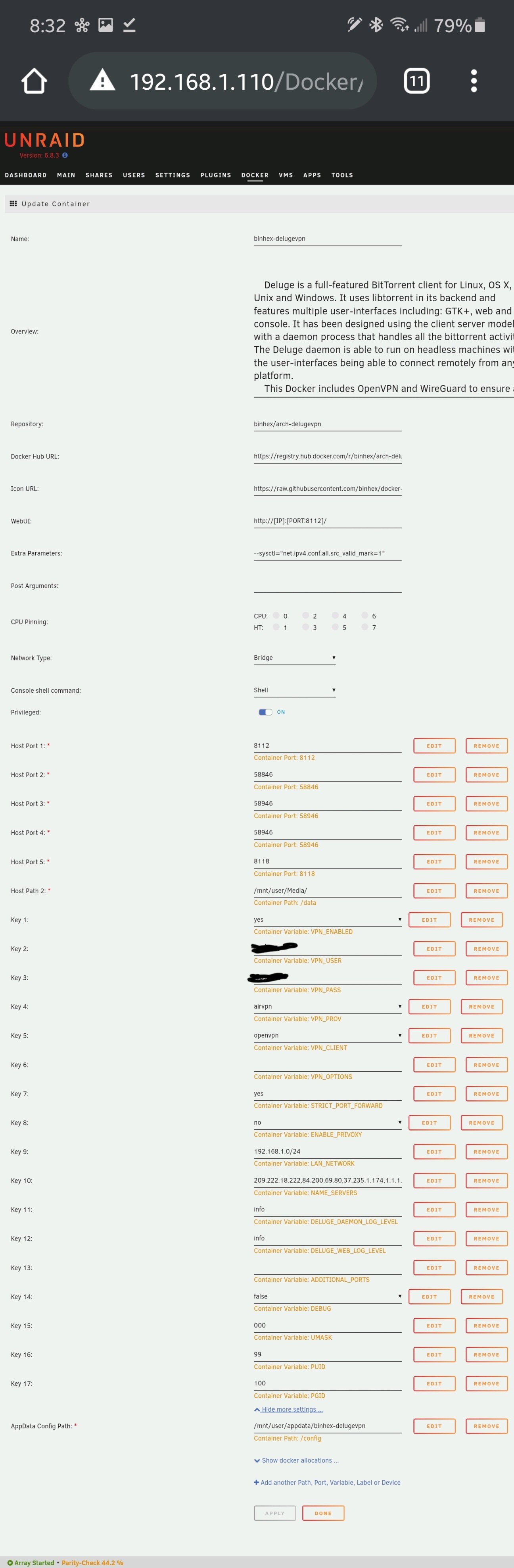

I just setup the CA Backup/Restore for 1st time. Left all my Docker apps unchecked but binhex-krusader & DiskSpeed didn't get backed up, they are in a Folder done by Docker Folder plugin. How they look in my Docker tab. 2nd question, does CA Backup/Restore back everything in the appdata share if I don't exclude any? Even if that Docker is not currently unstalled? i.e. binhex-delugevpn isn't installed but I have a folder for if I installed again.

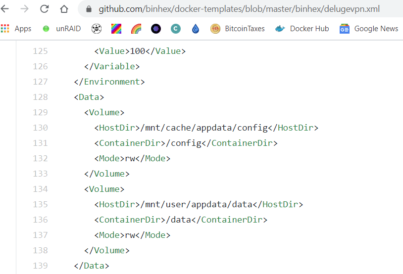

@binhex should "<HostDir>/mnt/user/appdata/data</HostDir>" be something different in your delugevpn docker-template? On my end I changed the HostDir that maps to ContainerDir. I didn't want my downloads to end up in my appdata folder which on cache only. Didn't Limetech change the /mnt/cache/appdata to /mnt/user/appdata, they treat appdata like a share and as longs as appdata share is set to prefer cache, your appdata stays on the cache pool?

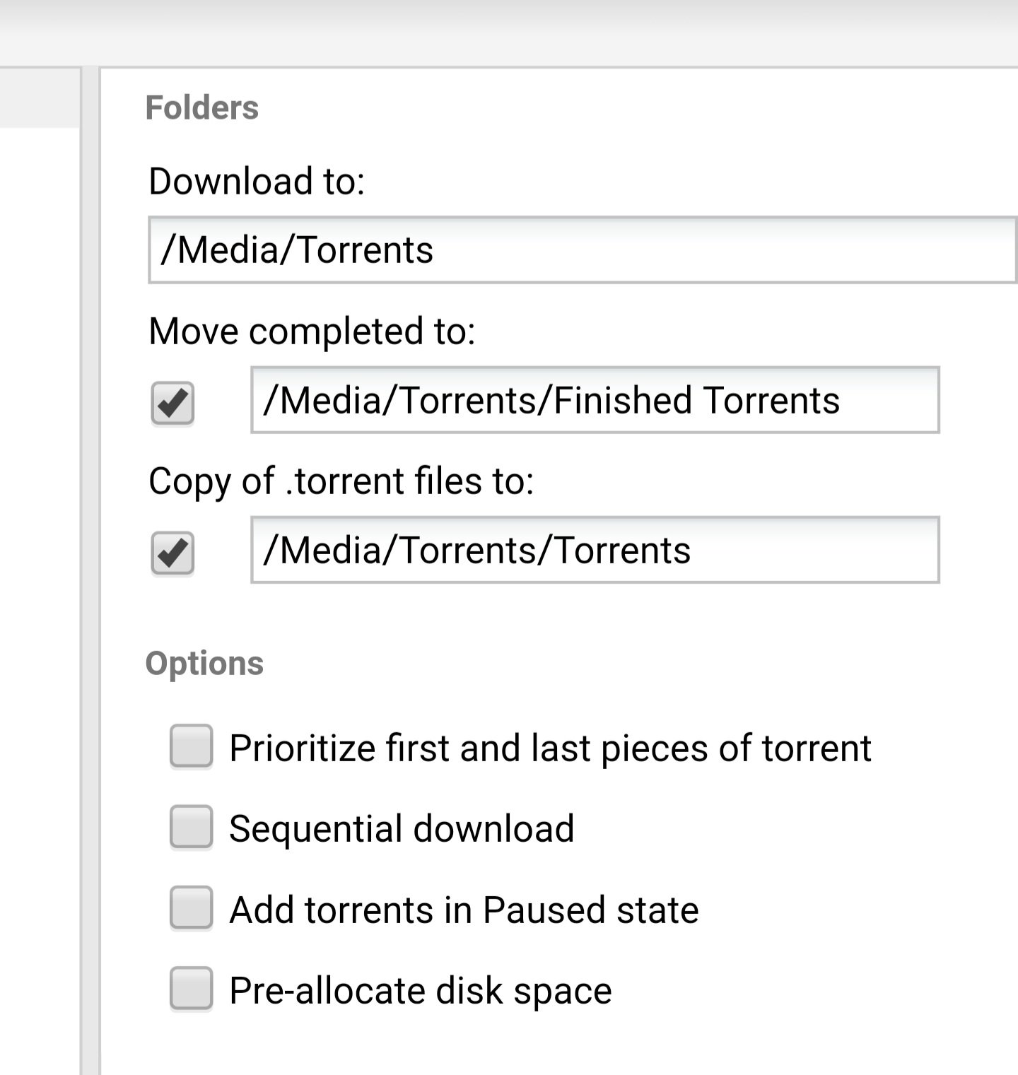

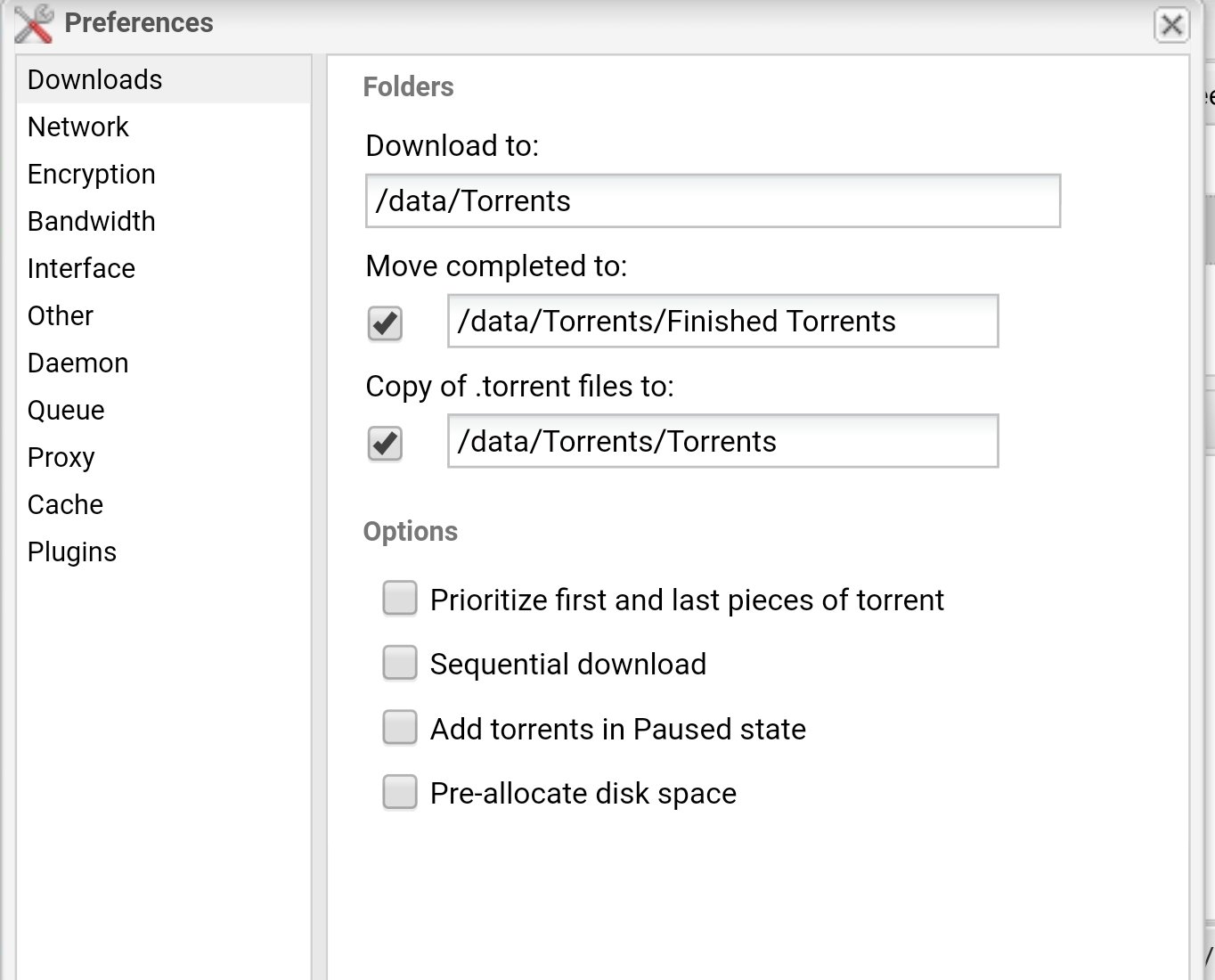

Ok changed that and it works now but had restart DelugeVPN because somehow the Media was still in the move completed when clicking the Torrent and looking at bottom options. Funny how I was stuck on 'Media', that is because on my personal DelugeVPN-flexget version the container mapping was /Media that way could never get it wrong. Now to get my DelugeVPN-flexget Docker working again. Something in my github code is wrong, it builds fine just something not correct, only thing that works is flexget by console. I'll have to compare your code with mine. If I went a different route and just made a Flexget only Docker how would Flexget communicate with Deluge? To send the Torrent with the move_done location? Per SpaceInvader video you can have one Docker use another Dockers internet to use that Dockers VPN. Would have the issue of the Flexget ports for website but that doesn't really work anyways.
[Support] binhex - DelugeVPN

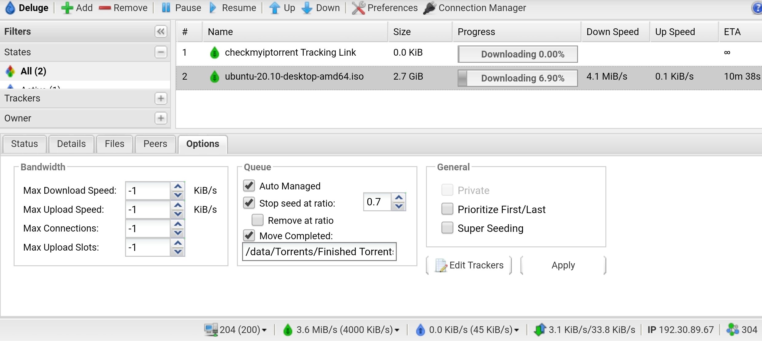

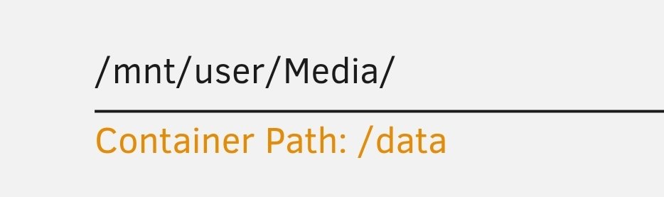

Ok one question in Deluge do include 'Media' as the root directory? This is my mapping in the Docker edit screen: Actually I think I answered my own question. In Deluge where I have 'Media' it should be 'data. I think when I change to 'data in Deluge download settings it should work. I think it started downloading then couldn't find 'Media' so it had nowhere to save and stopped downloading.
