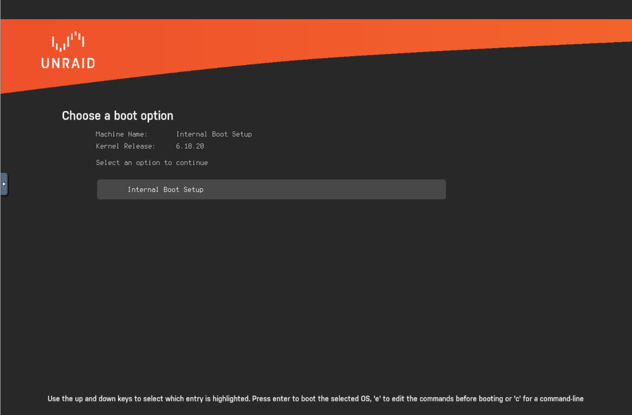

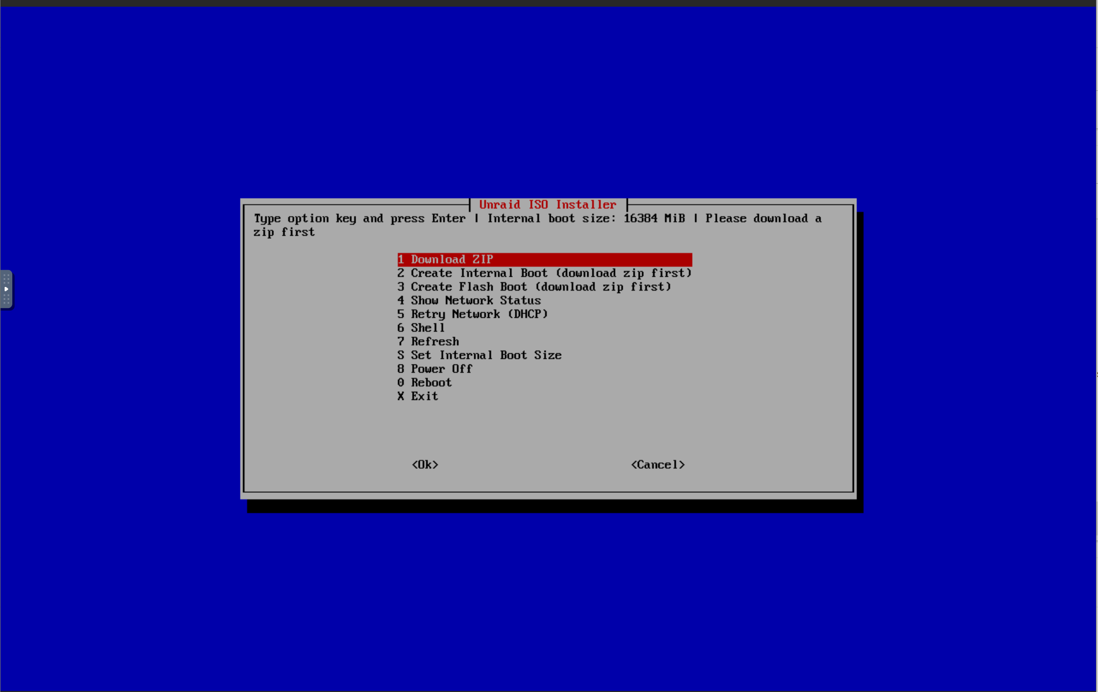

Hi All, with bringing Internal boot to 7.3 I have been working on a new test(beta) installer which allows you to create a single drive internal boot disk from a bootable usb or iso. NOTE this is for clean new installs not for upgrades. The installer also will allow you to create an Unraid USB Flash drive from the device you have just booted from. The files are available from here: iso: https://drive.google.com/file/d/1WDfQ2maaS4RKpffOsc-8pO9tcEi5VwpA/view?usp=sharing img: https://drive.google.com/file/d/1jrvumnD8wit_NCkUMZfzKWYTaYRtnDyP/view?usp=sharing To use the img you will need to create a bootable usb. You can use rufus but you need to select dd mode or if running from linux sudo dd if=builds/install-user-minimal.img of=/dev/sdX bs=4M status=progress conv=fsync where sdx is the usb Both don't have any zip files stored in them so you need to download the zip first. Then you can create an Internal boot or flash. The may be a version that has a zip inbedded also. So if you have a spare test environment and you want to try it out please do and provide feedback. It has so rough edges but is functional. You will get the same grub boot page before the menu. You can test with a VM using the ISO as a CD.
