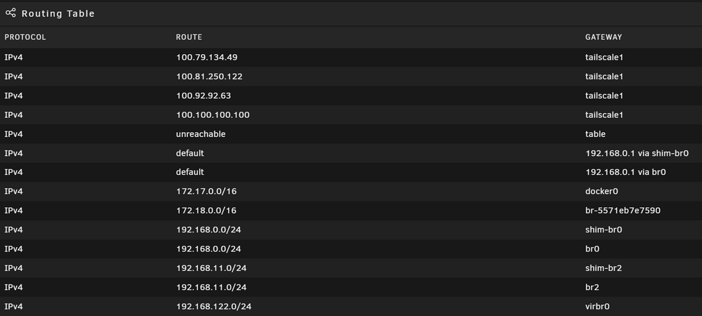

Thanks! - Its not that I want to use macvlan ๐ Seems like I have to!? I am missing the understanding on what solution I need for my setup? I have a proxynet defined for my Dockers. Proxynet I also need/use bridge + host when running two Plex servers side by side I have read the below posts but the right solution eludes me.... I also use the Nginxproxy and the Authilia as a gateway to access my services (with ipvlan I cant fetch new certificates) Right now I only have two LAN connection (I am in the middle of an upgrade so this could change). All my Network HW is Unifi... Update just changed it back to ipvlan again (It breaks some dockers, but so far no crash of the server, didnt get errors about macvlan before the crash thow?). https://docs.unraid.net/unraid-os/release-notes/6.12.4/#fix-for-macvlan-call-traces

Update my server crashed at 22:43 yesterday and again right now. I have enabled syslog. I did try to change the macvlan but that made many things not work. Nginx proxymanager couldnt fetch certificates, and my proxynet didnt work 100% So changed it back (I didnt have crash for last 2 months before so this might have caused this?
