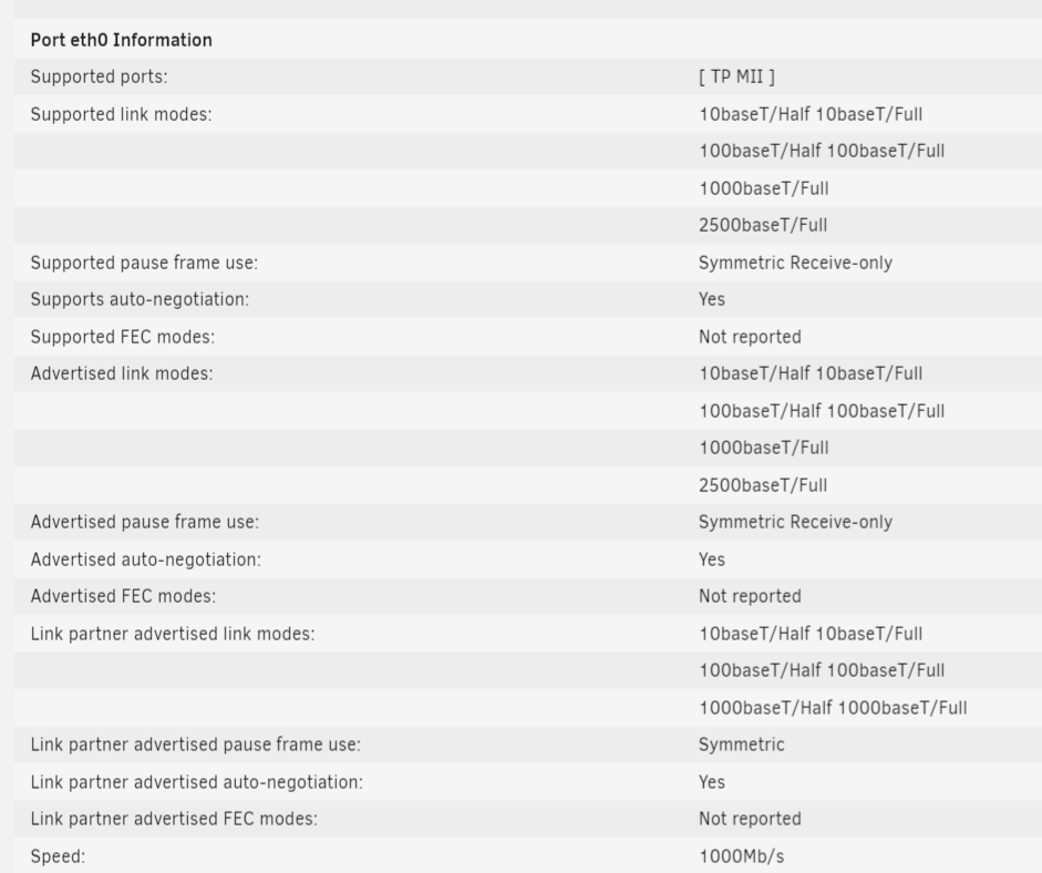

Testing on a dev release now has support for 2.5Gb NIC on my MSI Z690 PRO
root@computenode:~# lspci | grep 06:00.0
06:00.0 Ethernet controller: Intel Corporation Ethernet Controller I225-V (rev 03)
root@computenode:~# cat /var/log/syslog | grep igc
Dec 23 10:24:23 computenode kernel: igc 0000:06:00.0: enabling device (0000 -> 0002)
Dec 23 10:24:23 computenode kernel: igc 0000:06:00.0: PCIe PTM not supported by PCIe bus/controller
Dec 23 10:24:23 computenode kernel: igc 0000:06:00.0 (unnamed net_device) (uninitialized): PHC added
Dec 23 10:24:23 computenode kernel: igc 0000:06:00.0: 4.000 Gb/s available PCIe bandwidth (5.0 GT/s PCIe x1 link)
Dec 23 10:24:23 computenode kernel: igc 0000:06:00.0 eth0: MAC:
Dec 23 10:24:23 computenode kernel: igc 0000:06:00.0 eth0: PHC removed
Dec 23 10:24:24 computenode kernel: igc 0000:06:00.0: PCIe PTM not supported by PCIe bus/controller
Dec 23 10:24:24 computenode kernel: igc 0000:06:00.0 (unnamed net_device) (uninitialized): PHC added
Dec 23 10:24:24 computenode kernel: igc 0000:06:00.0: 4.000 Gb/s available PCIe bandwidth (5.0 GT/s PCIe x1 link)
Dec 23 10:24:24 computenode kernel: igc 0000:06:00.0 eth0: MAC:
Dec 23 10:24:35 computenode kernel: igc 0000:06:00.0 eth0: NIC Link is Up 1000 Mbps Full Duplex, Flow Control: RX
root@computenode:~#
