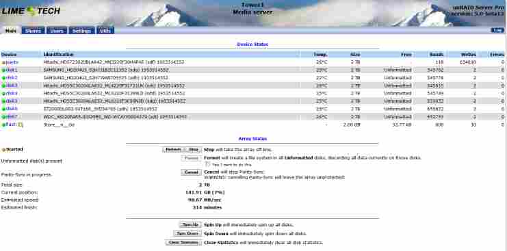

This is b13. Building a new array. Seven 2TB data drives, one 2TB parity drive. Total size on the main screen is goofy. Shouldn't 2TB be 14TB? :
Beautiful, isn't it? :/
Total size is 4th reading from the bottom. It's the only narrow value.
Totally cosmetic vs. real problems and for all I know it'll fix itself when the check is complete.
you need to check the box to format the drives and it should start a sync then the size will be right when it finishes.
You're performing a parity sync. That "Total Size" refers to the size of your parity drive only.
Indeed.  Those four consecutive lines are the performance statistics relating to the current operation.  The scan always has to cover the size of the parity drive, even if none of the data drives are as big as the parity.
