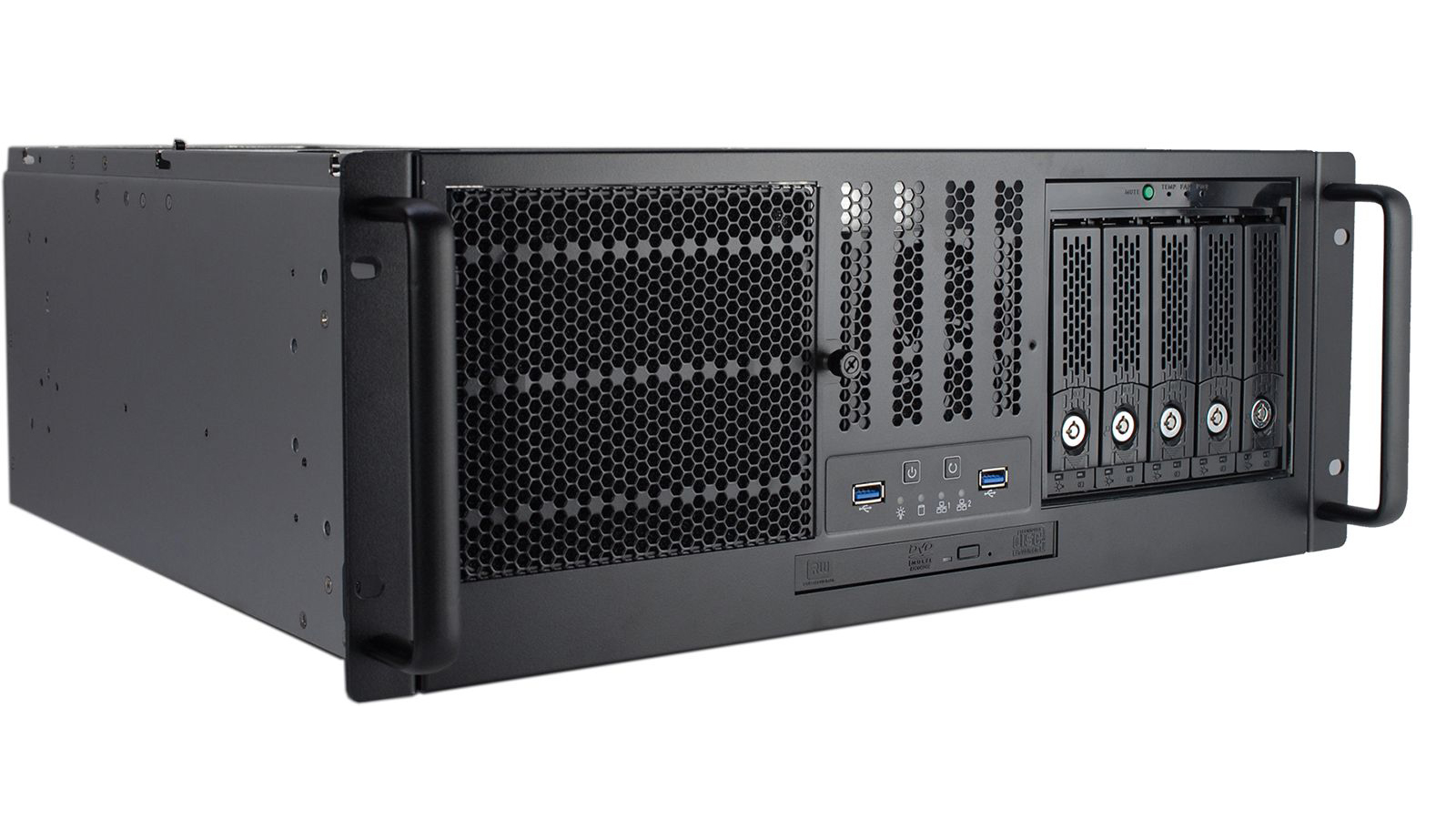

Thought I would share this case for anyone interested. Recently updated my build and noticed how hard it is to find a case these days that can hold a bunch of drives and also be of reasonable size to fit in my tv stand along with all my other AV equipment. Just looking at the picture briefly it looks like this chassis can hold around 15 hot swap drives and its only a little over 17 in deep which means it can pretty much fit where you want it. I've only seen pictures so I'm not sure how sturdy it is, but doing a quick look at the specs and options this seems to be an almost perfect case for a home server. Anyways, figured I would share and I hope to hear about any experiences from anyone who may own this case.
https://www.yycase.com/s/2/product-522361/4U-17-5”-Compact-Industrial-Computer-Chassis-YY-R445.html
Not sure how 15 hot swappable drives could fit in there - at least not 3.5" drives.
They don't state if the drives are hot swappable on the various configurations shown on their site, but from the pics you posted i see room for 10x3.5" drives plus maybe some 2.5" in the center .
