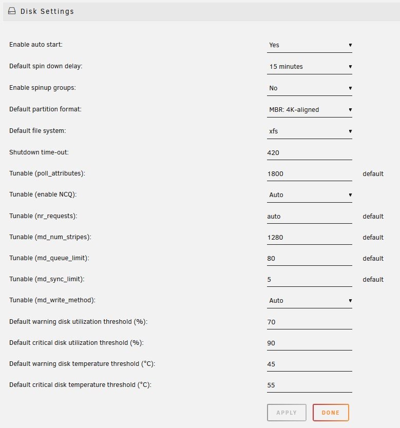

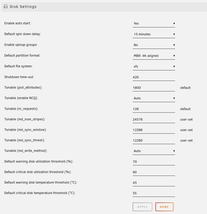

I have just tried 6.8.0-rc1 to compare its parity checks to both 6.7.2 and the Tunables script since my array is very straightforward and the result is interesting and shows there is still room for improvement.
The first thing I did before upgrading from 6.7.2 was reset all the Disk Settings tunables back to default (including nr-requests which defaults to auto now).
My array is 2x WD Red 8Tb dual parity and 6x WD Red 8Tb data with 2x 512Gb SSD for cache.
6.7.2 default - 17h15 to 17h30
6.7.2 tunables - 15h30
6.8.0-rc1 default - 16h45
I have added a screenshot of the 6.7.2 Tunables and also 6.8.0-rc1 default values for comparison and I think there is still scope for improvement. I suspect that on my server we could find up to an hour in there that could be tuned out.
That's disappointing.  But your tuned values are sky-high, probably among the highest I have ever seen shared here.  I would say that you have a special needs controller.  Definitely share this with Limetech.
Very interesting, thanks for sharing.  It took me a long time and a lot of effort to come up with a testing strategy for the v6.0-v6.7 tunables, and these changes with 6.8 pretty much throw all that out the window.
