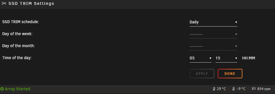

The dynamix ssd trim plugin causes the following to show up in the syslog when it runs. Two intel 545s (512gb) ssds are connected to a 9305-16i.
Feb  6 00:00:30 kernel: mpt3sas_cm0: log_info(0x31120b10): originator(PL), code(0x12), sub_code(0x0b10)
Feb  6 00:00:31 kernel: mpt3sas_cm0: log_info(0x31110e03): originator(PL), code(0x11), sub_code(0x0e03)
Feb  6 00:00:31 kernel: sd 1:0:13:0: [sdo] tag#4557 UNKNOWN(0x2003) Result: hostbyte=0x0b driverbyte=0x00 cmd_age=0s
Feb  6 00:00:31 kernel: sd 1:0:13:0: [sdo] tag#4557 CDB: opcode=0x85 85 06 2c 00 da 00 00 00 00 00 4f 00 c2 00 b0 00
Feb  6 00:00:32 kernel: sd 1:0:13:0: Power-on or device reset occurred
Feb  6 00:00:32 kernel: mpt3sas_cm0: log_info(0x31120b10): originator(PL), code(0x12), sub_code(0x0b10)
Feb  6 00:00:32 kernel: mpt3sas_cm0: log_info(0x31110e03): originator(PL), code(0x11), sub_code(0x0e03)
Feb  6 00:00:32 kernel: sd 1:0:0:0: [sdb] tag#4603 UNKNOWN(0x2003) Result: hostbyte=0x0b driverbyte=0x00 cmd_age=0s
Feb  6 00:00:32 kernel: sd 1:0:0:0: [sdb] tag#4603 CDB: opcode=0x85 85 06 2c 00 da 00 00 00 00 00 4f 00 c2 00 b0 00
Feb  6 00:00:33 kernel: mpt3sas_cm0: log_info(0x31110e03): originator(PL), code(0x11), sub_code(0x0e03)
Feb  6 00:00:33 kernel: sd 1:0:0:0: Power-on or device reset occurred
Executing 'fstrim -v /mnt/cache' or 'fstrim -a -v' manually or via userscripts works without any problems, so I guess I'll just do it that way.

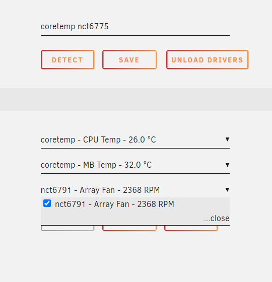

I've got everything set up as i want it with autofan and it works well for me on my Supermicro X9SCM-F for what it matters i also have the following plugins:
IPMI (configured with fan control off) and
SYSTEM TEMP (which sees my sensors and controllers)
However, Everytime i have to reboot, i have to manually change out and put back the 'PWM FAN' value in the plugin to force the plugin talk to the controller and manage the speed.
My BIOS fan controller is set to 'FULL' as i've read that the bios dosn't fight for control of PWM control if it's set like this. If i just reboot unraid and login, the array fans (that i manage with autofan) will be running at 100% until i do the disable/renable, detect process.
Is it likely that the plugin needs to be forced to refresh it's values prior to starting after a fresh reboot on the X9 platform so that it fights for control of PWM from the BIOS? If so, could this be added?
Secondly, Am i right in thinking the plugin dosnt display the highest disk temp in the unraid footnote? My autofan plugin simply displays:
CPU (temp)/ Mainboard (temp)/ Array Fan (%) but the footnote dosnt tell me what the disk temp is! As this plugin adjusts fans based on disk temp would it not make sense to display the disk temp?
I'd like to get to the bottom of what i need to do to avoid the re-enable/redetect every reboot before the plugin takes control. Ive tried uninstalling and reinstalling and manually clearing out all the old .cfg files for the plugin. But nothing has worked.
Cheers for the hardwork this plugin was def needed. Hope someone can shed some light. :(

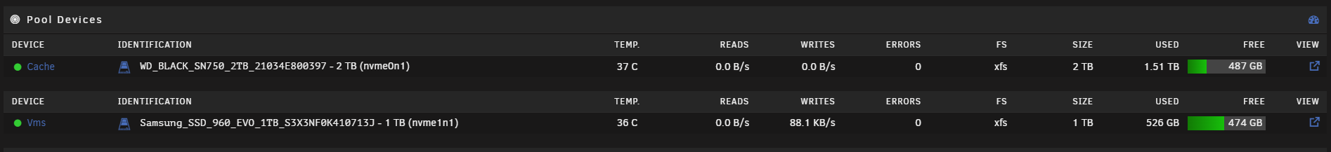

16 minutes ago, wibble said:
Does it do all cache drives/pools or only /mnt/cache?
all cache drives/pools, from the syslog ...
Feb 15 05:22:09 AlsServer root: /etc/libvirt: 51.8 MiB (54353920 bytes) trimmed on /dev/loop2
Feb 15 05:22:09 AlsServer root: /mnt/vms: 447.5 GiB (480543584256 bytes) trimmed on /dev/nvme1n1p1
Feb 15 05:22:09 AlsServer root: /mnt/cache: 467.4 GiB (501819392000 bytes) trimmed on /dev/nvme0n1p1
setting
nvme devices
  • Like 2
Can anyone help? Can i add a line to my unraid config to issue the command "PWM FAN = 40" on startup? That would at least be a workaround....

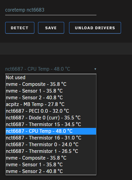

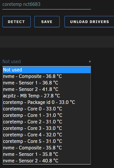

So I am still trying to figure this out.
I detect, save and load coretemp nct6683 driver, but no fans are detected and not all temps are available. cpu and some others are missing
Then I unload the driver, go to terminal an type modprobe nct6683 force=1. Go back to system temp and now all temps are avaliable. The missing temps are now listed with NCT6687 in front of them.
After restart the setting are gone.
So I added this to the go file. From my understanding it is supposed to force unraid to load more sensors etc on boot.
echo "options nct6683 force=1" >> /etc/modprobe.d/sensors.conf
By looking in the sensors.conf after reboot I see all the stuff that is missing listed there
chip "nct6687-isa-0a20"
ignore "fan1"
ignore "fan2"
ignore "fan3"
ignore "fan4"
label "temp4" "CPU Temp"
chip "acpitz-acpi-0"
label "temp1" "MB Temp"
So how can I make this available after boot? What am I doing wrong?

On 4/2/2022 at 6:26 PM, BeardElk said:
So i just changed motherboard from a gigabyte z590 to a msi z590 and now i cant get any info on fanspeed etc.
On my gigabyte board I had to include "modprobe it87 force_id=0x8628" in my go file for my fans to show up, but i got no clue on what I´m doing and I´ve tried googling to find some kind of help but nothing.
If anyone could help me with this I would be forever grateful!
I´ve run sensors-detect and the only thing that gave me was "HWMON_MODULES="coretemp nct6683" "
The problem has something to do with that my MSI board uses nct6687d which is supposedly added to nct6683, but something with patches and something else fucks something up.
It should be working but is not and I´m not 100% on the rest.
I´ve tried modprobe-ing every possible thing I could think of but nothing works, both with (force_id=0xa20) and without.
If anyone got any ideas im all ears!
