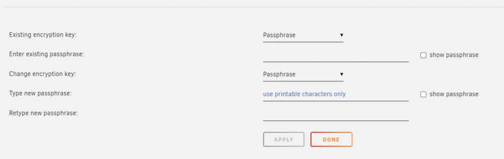

I tried to install the plugin, but receive this error.....
plugin: installing: https://raw.githubusercontent.com/bergware/dynamix/master/unRAIDv6/dynamix.encryption.key.plg
plugin: downloading https://raw.githubusercontent.com/bergware/dynamix/master/unRAIDv6/dynamix.encryption.key.plg
plugin: downloading: https://raw.githubusercontent.com/bergware/dynamix/master/unRAIDv6/dynamix.encryption.key.plg ... failed (Invalid URL / Server error response)
plugin: https://raw.githubusercontent.com/bergware/dynamix/master/unRAIDv6/dynamix.encryption.key.plg download failure (Invalid URL / Server error response)
Other plugins are updating, so i think it's not on my side.....

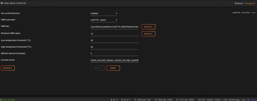

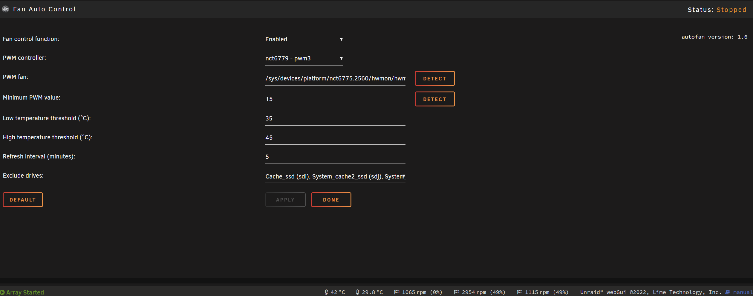

Hello, is there anyway i can troubleshoot Dynamix Fan Auto Control? In the last few months my fan's have been running extra loud compared to what they used to. I have the array powered off, processor and mainboard are showing 31 & 33 degrees, respectively. All the hard drives are under 34 degrees, but the fans are still spinning at medium-high speed.
Settings are screenshotted in the attachment, let me know if there is any other information i can include for diagnostics.

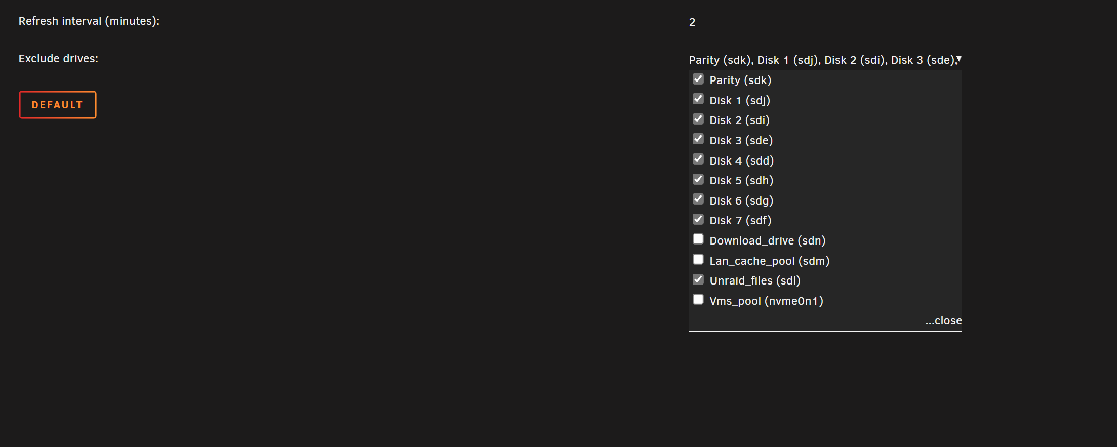

a feature request id like to see is..  not to use  "SDx"  to define hard drives..   but use there UID numbers..   if you pull a UD drive.. and reboot  unraid.    then the SDx  get all jumbled at times in the exclude drives  so a drive you wanted excluded  is now moved a hard drive or 2...  be nice to  have    (array 1 drive)   uid #      not (array 1 drive) sda     as tomorrow sda  could be array 2 drive
but if it could go to each unique id of a hard drive... then it wouldnt bugger up...  same with the "hwmonX"   it changes if you pull a UD drive out and you reboot.. now  a hwmon1   is either hwmon0  or hwmon2       be nice if there was a way to fix it.. that it never changes
The system never uses the sdX designations to identify drives.    In the main array it is by serial number, and If you want it under UD then you CAN already get UD to always use the same identifier for each drive by simply setting the name to use explicitly.
Link to comment
under fan exclude you see its sdk sdj sdl   well they always change if i were to add a drive to the array...  and if you add a UD drive  and reboot well exclude the check marks are off by 1   or 2 or 3 depending how many UD drives you add and do a reboot for whatever reason..
so if i have array 1 to 7 checked off  and you add 2 UD drives and you reboot things.. then   array 1 is checked  2 3 is unchecked 4 5 6  7 could be checked off..   it picks and chooses
what i mean about uid
beside Disk 1  instead of it looking for SDJ   it be nice if it was UID   cuz
so  Disk 1 (sdj)     would be  Disk 1 (UID #)
this way  fans wouldnt bugger up every time a any hard drive   you plug into the server and then you happen to do a reboot causes the fan list bugger up...
so like
excude
Disk 1   UID#
Disk 2  UID#
Disk 3  UID#
this way  it be always linked to the UID number not a SDx number
as i guess the Fan Speed Exclude  only looks at "SDx"  not "UID"
and is there a way to fix that HwmonX issue i notice too?
Link to comment

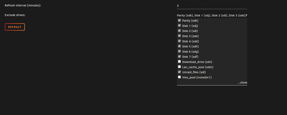

and about the UD  and identifliers.. what i mean
is if i have what you see in above pic...  if i have  2 USB drives plugged in.. and reboot.. it will  then uncheck those check boxes.. same if i add  a drive to the array
but also mostly  the Hardware monitor keeps changing when you remove a UD  from the system.. so if you have 2 UD drives pluged in and HWMON2  is set.. when you pull the 2 drives out and reboot..   HWMON2  changes to HWMON0     and buggers up the fans... and or sometimes the disk1 etc wil sometimes uncheck and re check others..
and say if i add another Disk to the array.. so Disk8  it buggers up the fans checked off cuz its not doing UID  but the SD and the orders change,,  so each time you add an Disk either a cache or a Disk  will missup what you have already set

@mmwilson0  try in your bios  and if it has  like settings for manual and automatic fan controls   try the opposite is set for..  i know i had to do that for my asus x570 boards  i think i have manual
i know the HWMON  keeps changing  if i pull or add an un assigned drive
it start of as
hwmon1   but after a reboot  it could be hwmon0 or 2    so far no one has an answer to my question how to force it to be 1   not toggle itself
so i always have to click the DETECT and then apply...  cuz of the hwmon change each time you reboot if you add remove a unassigned drive
Edited by comet424

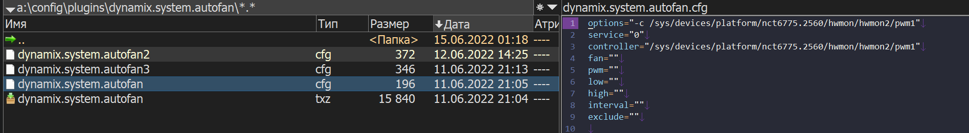

2 hours ago, Masterwishx said:
i Think that after reboot autofan is not started automatic but was enabled on pwm3,pwm4 .
What should be done to start it automaticly after reboot ?
look in the autofan config dir, for multiple config files, delete then all except the one that currently reflects your setup, and remove any numbering from the file name, reboot and it will auto start.
i can not believe this plugin has gotten 0 support for so long! it has alot of issues!
in bios fans should be set to 100% or full speed so auto fan can ramp them up and down 100%.
if they are set to 50% in bios, the auto fan at 100% will only be 50% of the fans output
