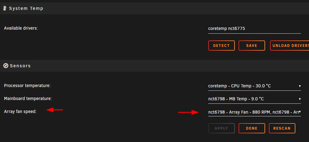

On 1/5/2022 at 2:53 AM, rbojanssen said:
I had to replace my MB and Processor last week and since then the Dynamix System Temperature doesn't show anything. I have the Asus PRIME B550-PLUS with the AMD Ryzen 5 5600G with Radeon Graphics @ 4.2 GHz installed.
When I click detect it shows nct6775 in the available drivers. I then do a rescan but under processor, mainboard and array nothing shows up.
When I type 'sensors' at the cl it says No sensors found!
Any ideas what I can do?
Regards Ronald
try adding this line to your go file:
modprobe k10temp force_id=0xd120
may require a reboot

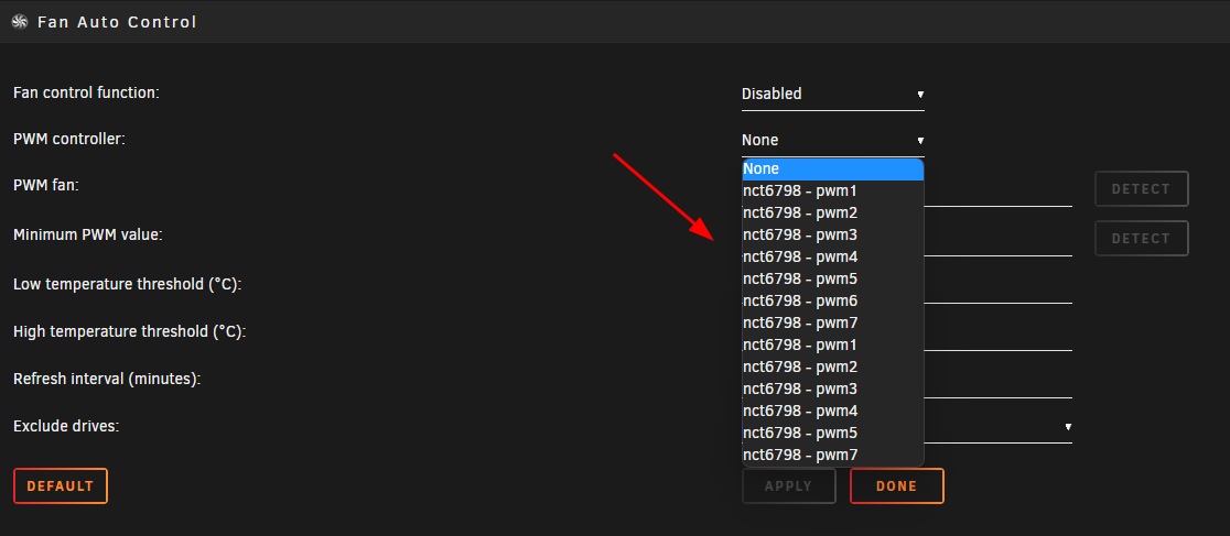

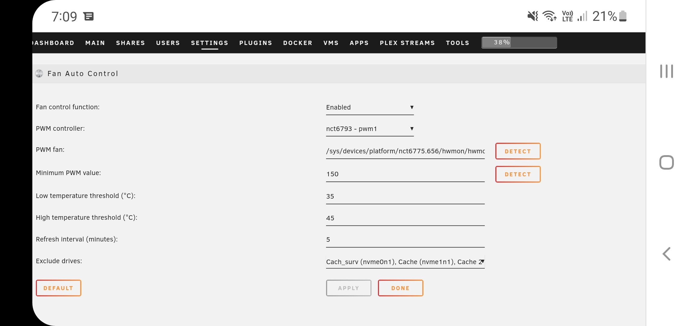

I'm having some trouble getting the Auto fan control to work.
The fans are detected on the main page, but the fan speeds don't ramp up and down with drive temps. I can ramp the fan up and down by setting the minimum PWM value.
Using the settings in the screenshot, the drives hit 51C and the fan was still at the lowest setting at 260rpm. I've now set the minimum to 120 to get the fan to sit at 1200rpm to keep temps under control.
What have I gotten wrong here? Using 6.10RC2

Have some issues with the Auto Fan Control. All it says is "PWM controller None".
I get all sensors for temps etc, but it wont show any of my fans.
Motherboard is a MSI z590 and running unraid 6.10.0.rc2
Can anyone point me in the right direction on how to have pwm controller available in unraid?

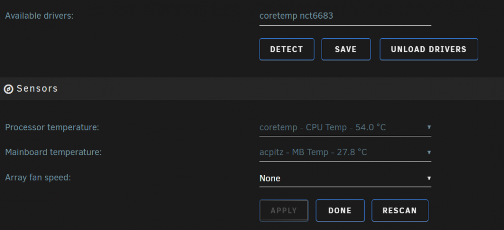

Post the output of sensors detect
sure [emoji4]
0bin - sensor-detect
Ok so the 2 drivers you need to load are nct6683 and coretemp.
By either modprobe via command line or the system temp plugin
They are loaded in the system temp plugin. All temps sensors are available. It is fan controller in the fan auto control plugin that is missing and I am trying to figure out
Edited by ProphetSe7en

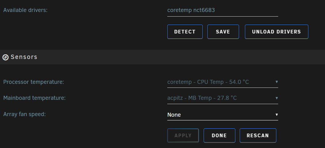

Just to clarify:
anything here to choose from ?
cause i see in your screen "none" ... so i guess they are not detectet (yet)
if they are there then ...
so may start over with all the steps in sensor detect ?
i dont use autofan anymore as it didnt fit my needs, may someone else has an idea ..

Just a thought for a possible future addition to the Auto Fan Control plugin if it has not already been suggested and is even possible to implement. I really like the plugin and it works great but the option to do different thresholds for different drives would be a nice feature to have. My thought process on this is NVME drives in the system are obviously running much warmer than the HDD's, while excluding them does work, it would be nice to be able to just set a higher threshold for the chosen drives so they can also be monitored and have the fan speeds go up should they start to warm up under heavier loads without having the fans run excessively fast if they are kept under the same threshold as the HDD's.
