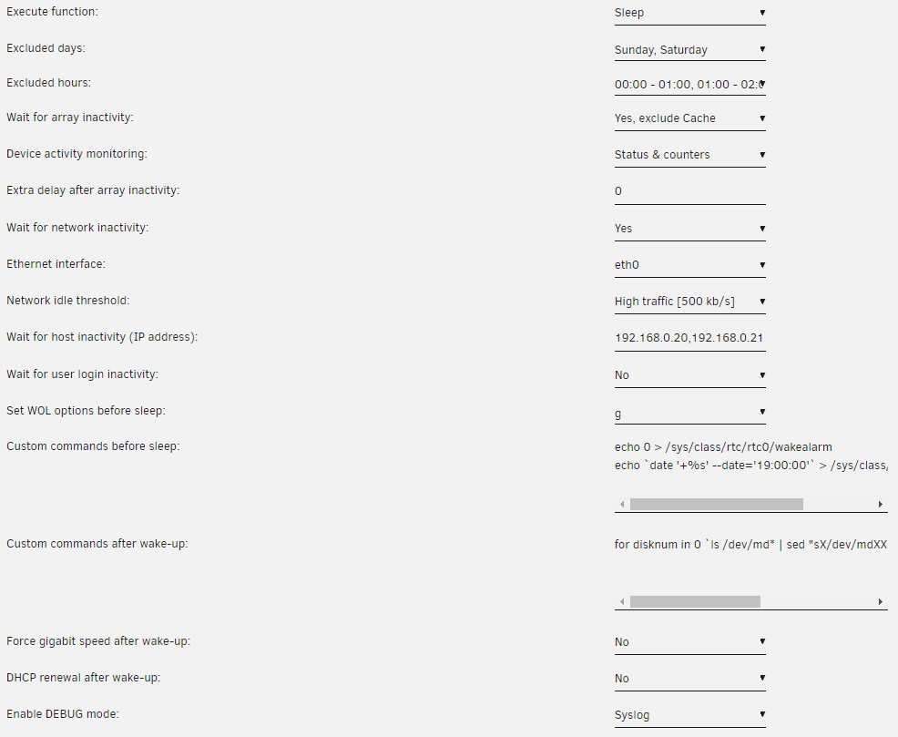

Hi, since i updated to unraid Version 6.9.2, i have a Problem with the S3 Sleep Plugin.
It seemed to shut the system down instead of sleep and never came back up, i mirrored the syslog to flash and now finaly found the time to look into it but i don't really understand why its happening:
The Server was supposed to go sleep at 2:00 and wakeup the same day at 19:00.
To Achive this i set this custom command before sleep:
echo 0 > /sys/class/rtc/rtc0/wakealarm
echo `date '+%s' --date='19:00:00'` > /sys/class/rtc/rtc0/wakealarm
It was working fine for years.
In the syslog i now saw whats happening:
Its going to sleep at night as planned:
Oct  6 02:00:16 unRAID s3_sleep: Disk activity detected. Reset timers.

Here are my Plugin-settings, its Version 3.0.8
Full syslog is also attached. I hope you can help me with this problem, thanks in advance.
syslog

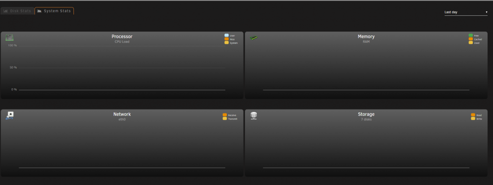

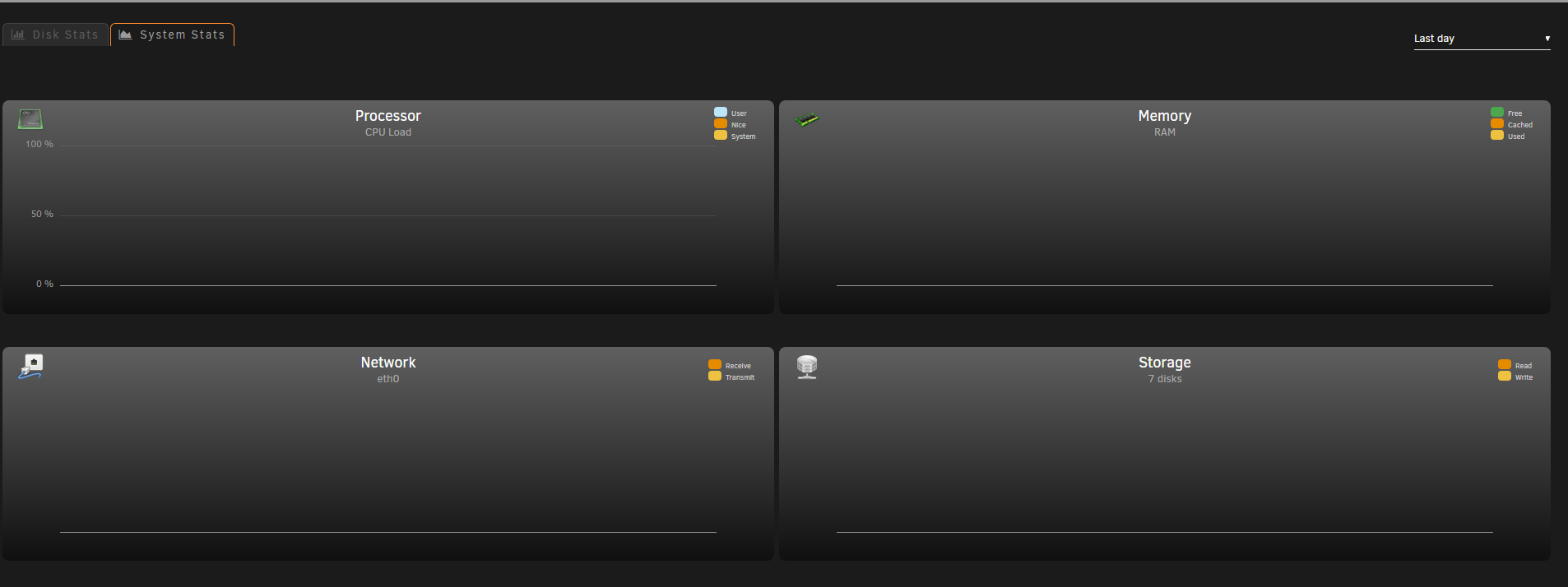

8 minutes ago, sonic6 said:
Stats plugin still not working.
i am on unraid 6.10 RC2
working for me on 6.10rc2. What browser?
chrome and the same on edge
Working for me on chrome. Do you have any adblocker or anything else that might interfere with your browser?
no, nothing i know.
i tried Chrome, Edge, deleting cookies and incognito mode without plugin. everytime the same.
only that in my syslog:
Nov  7 17:31:10 Unraid-1 nginx: 2021/11/07 17:31:10 [error] 17540#17540: *746057 open() "/usr/local/emhttp/plugins/dynamix.system.stats/images/sys.png" failed (2: No such file or directory) while sending to client, client: 192.168.0.6, server: , request: "GET /plugins/dynamix.system.stats/images/sys.png HTTP/1.1", host: "192.168.0.50:50080", referrer: "http://192.168.0.50:50080/Stats"
Edited by sonic6
