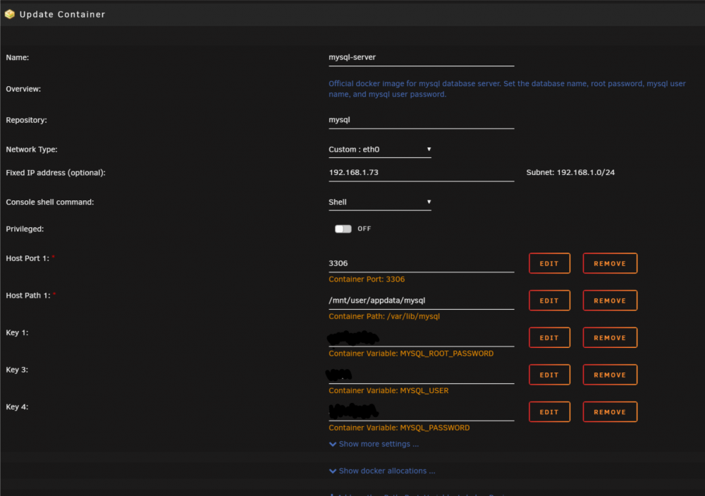

excuse my lack of knowledge as I'm brand new to docker. I'm trying to migrate to docker from dedicated linux vm's. first thing on my list is MySQL as it is the center point for quite a few other services. I downloaded and installed the bungy mysql docker, set the network as custom: eth0 and set the ip. I can ping the IP and get responses, however, I cannot connect via mysql workbench. Given my complete lack of Docker knowledge, I'm stuck. I've searched the web and my google foo is running low. Need some help - thanks in advance.
I'm on unraid 6.7.2.
Set the network type back to the default. Then you should be able to connect to it using the host unraid system's ip address and port 3306
Is there a way to set it to its own IP address? The benefit for me would be not having to change other applications. They all point to this IP address.
Not that I know of. Containers generally run under the host's network stack. They don't work like virtual machines where each machine can have its own ip address.
Docker does have its own IP address, but its not exposed.  You're basically left with two feasible options.  Set your network to bridge mode and then you can expose your port as you seem to have already done.  Then you access your Mysql instance at the IP address of your UnRaid server, example 192.168.100.11:3306, with the port you specified.  This will be useful for you to validate your migration before you pull in your applications if that is your intent.  If you proceed to dockerize your applications then you can use Docker's built-in link container capabilities.  This you would basically enable linking by putting something similar to this on the Extra Parameters section of Unraid: --link postgres:postgresql.  The syntax is basically the flag --link followed by the name of your running instance with a colon separating them and then the name of the instance you wish to be referenced internally within the dockerized container which doesn't really matter.  Once you've done that you can log into the dockarized container and view the linked environment variables to confirm settings by running "printenv" from the console.
Attached is a photo where you can check the link settings have applied.  I use mariadb instead of Mysql, but that doesn't matter.

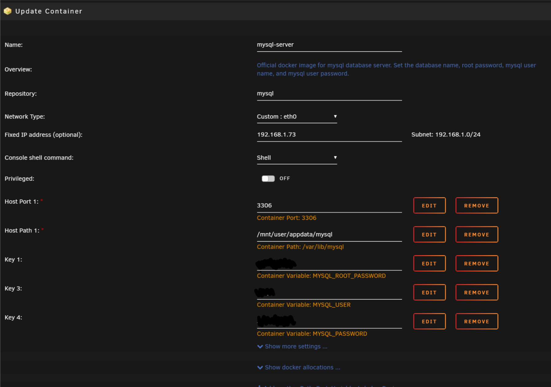

I think that's where I've been hung up...I keep thinking as if it's similar to a VM.
I set it to "host" and exposed the port. Connected right up. Thanks!
The ultimate plan is to dockerize the applications. I'll definitely have to mess with the linking you mention. Totally new to this...hoping to make my life easier in the end. Having dedicated VM's is a pain to keep updated.
