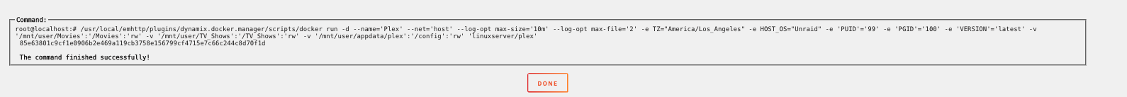

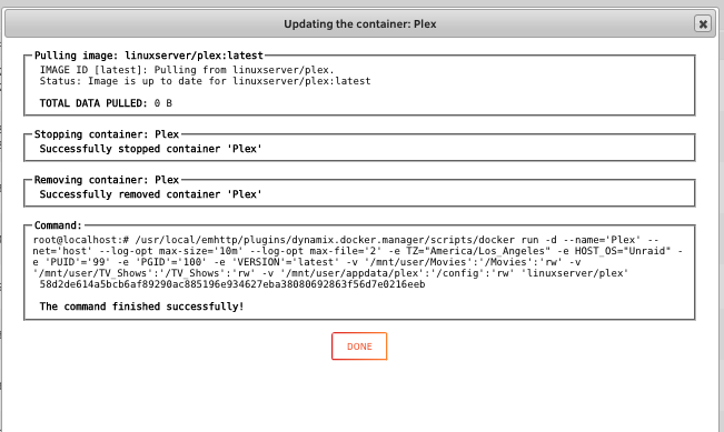

Haven't looked at your diagnostics yet but your docker run doesn't have a host mapping for the /config container volume, which would completely explain why plex doesn't remember anything since you haven't told it where its library is. Did you have an appdata folder for plex?
Link to comment
9 minutes ago, mkyb14 said:
I guess now after googleing docker /config for plex, I was assuming the template used by linuxserver.io had that preconfigured.. are you stating that I need to manually set this as a variable?
It did have it preconfigured. Somehow you managed to lose that setting. You will have to set it yourself.

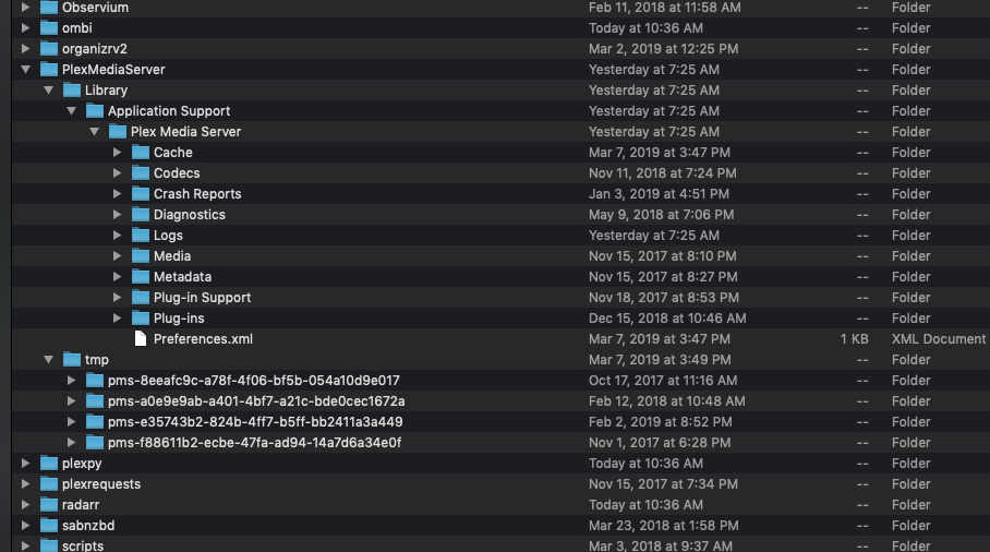

What is that a screenshot from? Assuming it is showing the contents of /mnt/user/appdata then it does look like you have your plex library, so you just need to get that volume mapping added.

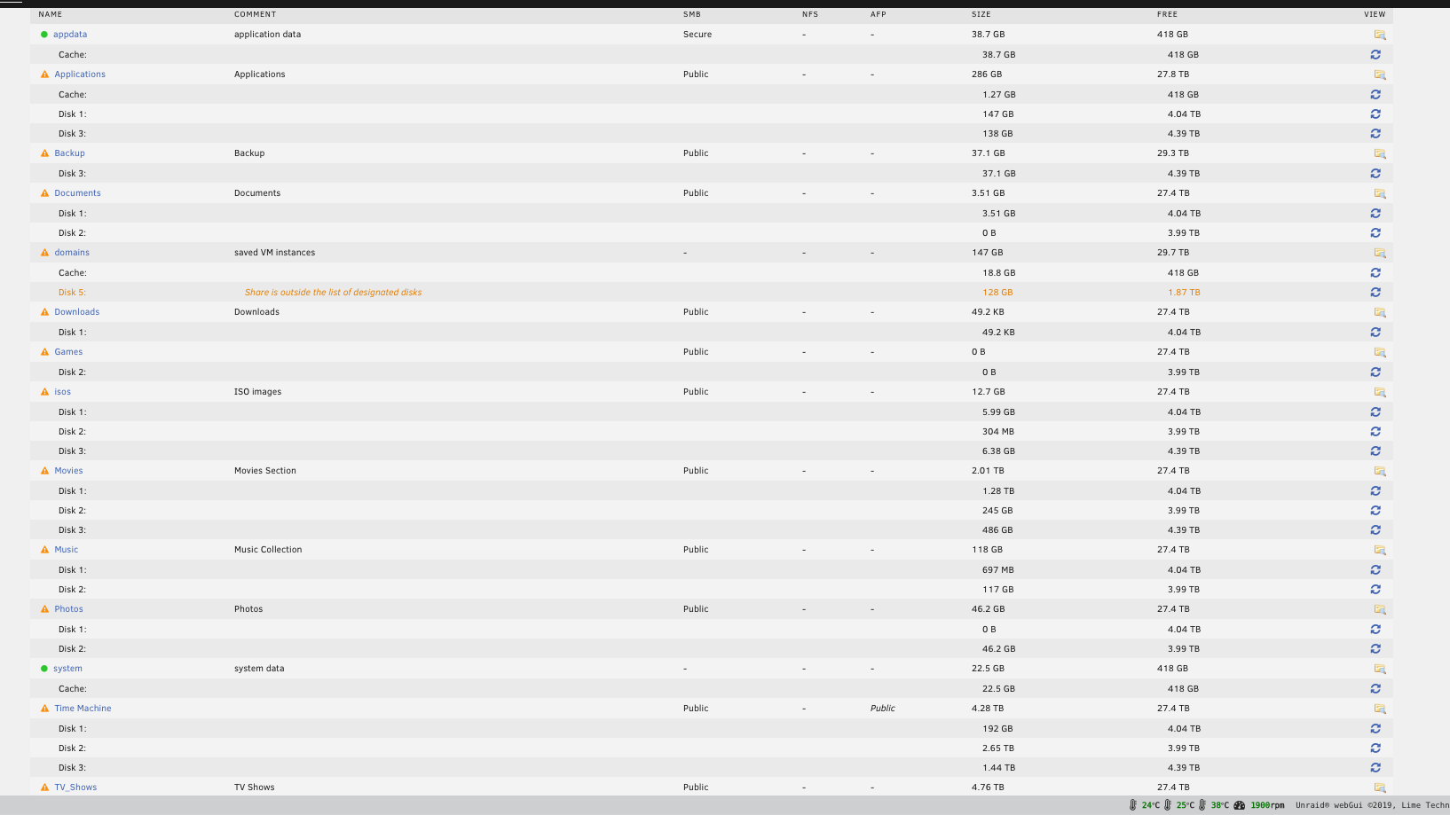

You still haven't got your user shares configured correctly. I'm working on another post about that.

  1. Go to Settings - Docker and disable Dockers.
  2. Go to Settings - VM Manager and disable VMs.
  3. Go to Shares - User Shares.
  4. Click on the appdata share, set it to Use cache disk: Prefer.
  5. Click on the system share, set it to Use cache disk: Prefer.
  6. Click on the isos share, set it to Use cache disk: Yes.
  7. Go to Main - Array Operations and click on Move Now. Wait for it to finish.
  8. Go to Shares - User Shares, click on the Compute All button. Wait for it to finish, then post a screenshot of the results.

I don't know how you did it, but half of the original template is missing from the run command you posted.
Best thing would be to start from scratch. Delete the co trainer and image, delete the saved template in CA and install fresh from CA.
doing this now.  I'll check my CA templates and files... might end of just starting fresh again.  This was a fresh install friday, did the plex update to the docker today and poof.  made all the changes above, waiting for Mover to finish and i'll come back with a screenshot.

For /config you should be able to use the same structure. Install a blank plex from us and compare the appdata folders created and compare it to needos.
For the media folders you need to use the same path inside the container as you did in needos container.

Don't understand exactly how you are getting this wrong, but I switched from needo to this one long ago and it just worked.
It shouldn't actually be necessary to copy any files, unless you just want to make a backup of the plex appdata folder. Just use the same mappings, including pointing this docker to the same appdata you used with needo. In fact, you might even get away with simply changing the repository.

I thought they'd be the same too, but for whatever reason it isn't populating the old data. I figured I must be doing something wrong or missing an obvious step... I'll fiddle some more. Maybe I just need to step away and come back 😓

You are missing the mapping for /audio, and obviously the /config mapping isn't the same, but as long as you copy all the /config from needo to L.io seems like it should find your plex library and go with it.
Did you copy the contents of /mnt/cache/Apps/Docker/apps/plexmediaserver/ to /mnt/user/appdata/plex_lio ?
Did you check to make sure they had the exact same folder structure and contents?
