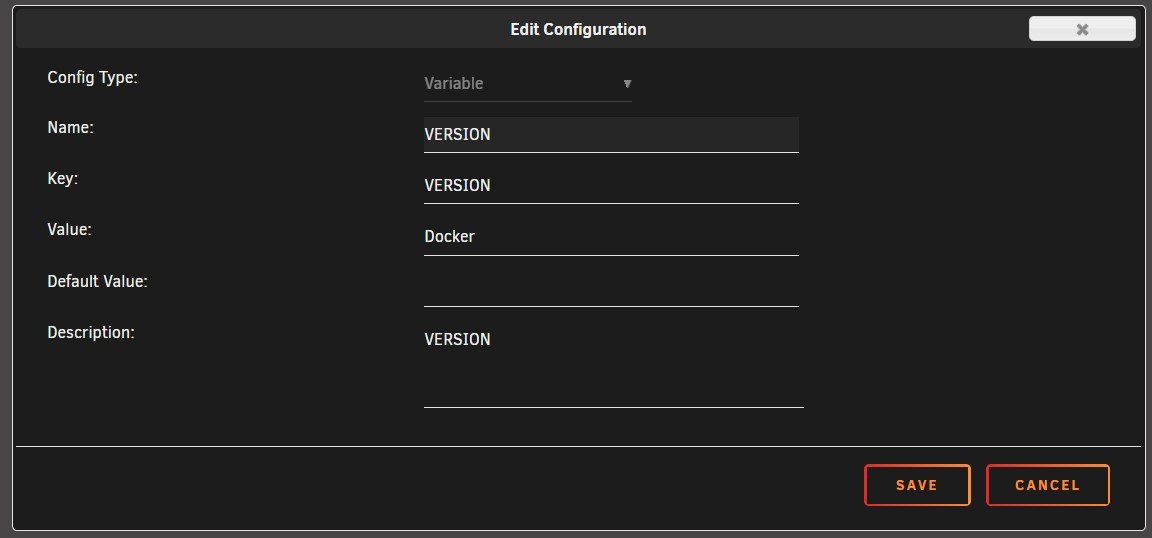

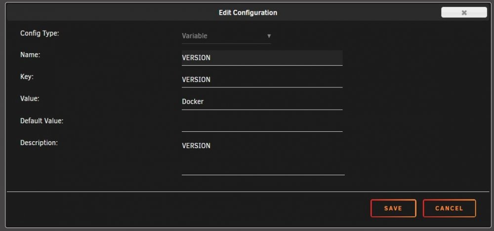

Is this the correct setup for this to keep plex upto date

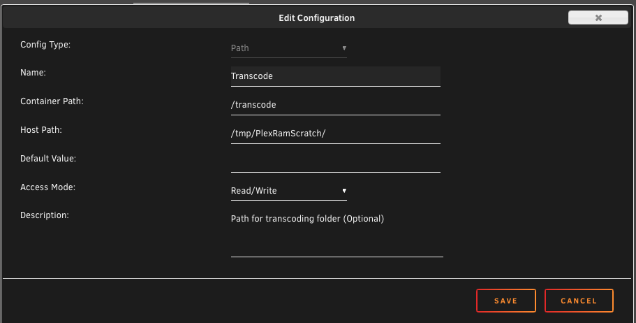

Strange, I've literally just dealt with this about an hour ago (it was sitting at around 40Gig!). I used the unraid terminal to delete the numbered folder, & it's contents, in the Sync+ directory. Wasn't sure if just deleting the Sync+ folder would make a difference, but decided to just keep it and delete everything in it. So far, no issues.
7 hours ago, xxDeadbolt said:
Sync+ directory
You should setup Transcode to go to some share outside appdata if you are going to be doing large Plex syncs.
Under Settings -> Transcoder, the "Transcoder temporary directory" is listed as /var/tmp.
Correct me if I'm wrong, but that's essentially a non-persistent location on what is essentially a "ram disk?"  That is to say, its not anywhere on /boot and its certainly not on my array anywhere.  Which doesn't explain why huge files are showing up inside the plex folder under appdata.
So I changed it to /mnt/user/temp which is a less than ideal location because its slow, however if it starts creating large files again, the array has enough room that it won't make a huge difference if I don't catch it right away.
These files seem like temporary files, should they not be getting deleted by Plex during some maintenance event of some sort?
You haven't told us which of those paths are container paths, which are host paths.
Assuming this is a path specified within the Plex application itself, it sounds like a path that would be inside docker.img unless you have mapped it to the host.
That also sounds like a path that would be inside docker.img unless you have mapped it to the host.
Do you understand mappings?
Not sure if I understand mappings or not.  I think what happens inside a docker image is magic and I don't understand any of it, at all, even a little bit.
/mnt/user/temp is a share exported by my unraid server as "temp" across the network, so I guess that would make it a host path, right?
Only if you mapped it in the docker settings. Example- I use /transcode for transcode location in plex and I have it mapped to /tmp/PlexRamScratch/ which is a folder in unraid's ram.
You would need a similar mapping.
So /tmp is RAM, then, and I am free to put stuff there that I don't need to survive a reboot?  Stupid question, I know.  But before I accidentally fill up my 8GB USB unraid thumb drive I want to be certain.  Mine has a lot of stuff in it:
