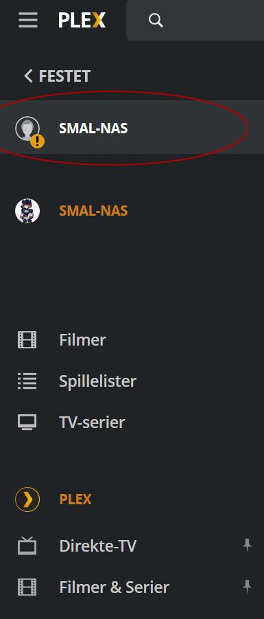

I had a problem after a power outage, my Plex docker would not start then it disappeared.
I tried to redownload the Plex docker. But then it started as a fresh plex docker.
So I tried CA Appdata restore. Everything seemingly worked, but it seems Plex cant reach the “old plex server and library” only the new instance from when I redownloaded the docker.
Adding a picture of what I am seeing.
Edited by chFresh
IIRC correctly, that's a regular problem with Plex.  Look on their support forum for Reclaim Server
ty, i reclaimed the server.
but the media library saying it's empty.
that wired because restoring from ca seemingly goes w out error
every user and settings is correct. but no library
Edited by chFresh
