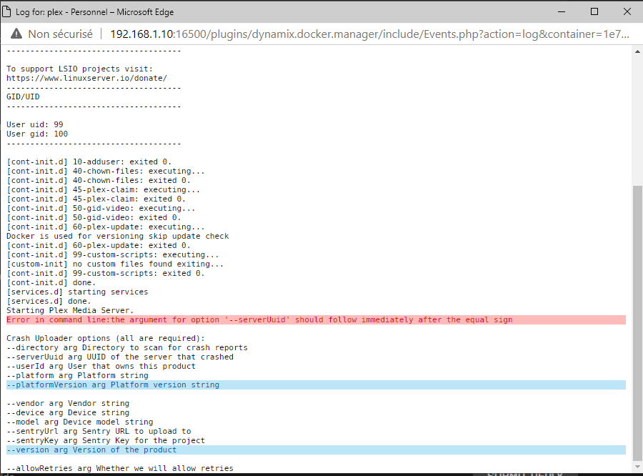

After an hour going crazy wondering why I couldn't see any menu to add my libraries on my own server, I noticed that Plex Media Server can't start.image.png.f715561a2b8ef4be4796fd9acb8a95ae.png
It is a new installation. I will try with an older version
EDIT: OK now Plex Media Server started. I logged in again, but same thing.... can't see any admin settings or anything to add libraries.... am I stupid or what? When I go to "My media" it tells me to install plex media server. Few years ago it was so simple. Maybe I'm missing something very obvious
EDIT2 : I installed plexinc/pms-docker instead and it worked out of box. I was greeted with a configuration page and was able to add libraries.
Edited by wblondel
Sometimes it is better to use the "original" delivered software xD
Its still sad, that the linuxserver.io version of plex-docker dont work. But I usually also try to use the "official" version. Most of the time less pain.
Maybe this will be fixed with an updated docker-image.
Link to comment

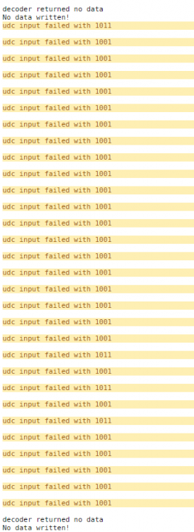

Since updating to the latest version of Unraid 6.9.2 I have had a few issues with Plex.
First it came up with a absolute ton of the below error, but since restarting the docker I have not see it since.
Sqlite3: Sleeping for 200ms to retry busy DB
And now for the second time I have the below. Now the only google result I found was someone saying it was a corrupt media file. But unless I go digging through all the logs for a time stamp and then cross reference it I wont easily find what one. But has anyone got any ideas if it is that or something else before I go digging?
Link to comment

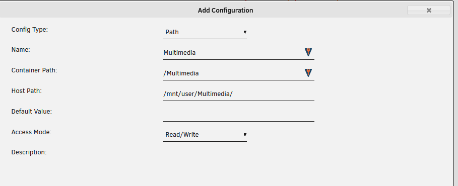

Hi all,
i would like to move my Plex installation from my QNAP (native /no docker) to my new unRAID server.  According to the guide from plex (https://support.plex.tv/articles/201370363-move-an-install-to-another-system/) it seems quite easy.
Before i had 2 folders
\plex -> with the plex setings
\Multimedia with subfoldes for moviews/tv/.. which i added as library in plex
Now i wanted to install the container and have a few questions:
- By default the config path is mapped to /mnt/user/appdata/plex which is fine. Can I just copy the 3 folders above into this folder?
- The template wants to mount various folders for movies/tv/music/. As i only have one Multimedia sahre with subfolders, can I just leave these paths blank and instead create a new patch like this?
After that i can readd the path to the library as i would have to do anyway
Link to comment
I use this linuxserverio plex docker. I named my plex appdata folder plexms, but that isn't really relevant, you could name it plex and that would be OK.
But, here is the folder tree below that:
So it doesn't look like what you are suggesting will work exactly as you have it, at least for the appdata folders. Note that there is no Info or tmp folders, maybe you created those paths somehow such as for the transcode folder. And the Plex Media Server folder is down a couple of levels. The Multimedia mapping looks like it should work.
Maybe just create the plex docker and then after it has created the appdata folders, stop it and put your Plex Media Server folder where it belongs.
If everything is working, you shouldn't need to add the library since the whole point of the migration is so appdata will still know where everything is, which is the folder mapped as Multimedia.
Anyone any ideas on this? I still get this very often.

I'm trying to upgrade to this new beta Plex docker version that resolves HW transcode for Intel 10th gen CPUs.  I have a plex pass...how can I get to the Plex server v1.23.x?  I tried the "latest" tag and that gave me 1.22.x.  The Docker page says that if I am logged in it will install the latest plex pass release, but I can't see where I am supposed to log in on Unraid.
Link to comment
