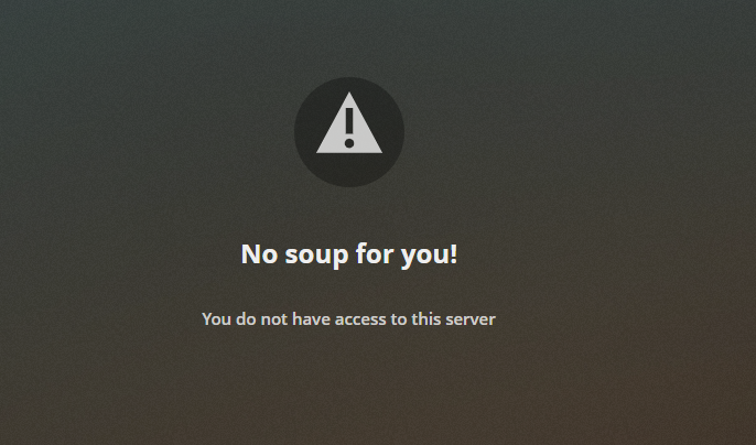

Hi.  Trying this container out.  Why doesn't it see media on my Unraid Share?  It seems media server not installed.  Tried signing out and in, still the same.  This is also the case for my installation of official Plex container.
Would be better if you described what you are seeing more in detail.
What is the exact error message you are getting and when. Are you connecting from a computer on the same subnet as the Plex container?
Also post your docker run command.
There's no way to add my Media share.
I also asked you a question.
Have you tried using the Plex claim?
I am connecting from outside the network. I manage this unraid server.  I connected via OpenVpn.  Also tried accessing the server via it's public IP:32400, with same result.
I don't know where to click to do the claim.  I can't find it.  The server don't show any Claim notifications.   I just run the docker app via gui, not familiar with docker run command.
As documented by Squid in the Docker FAQ forum:
How to get the docker run command
From a post in the Plex support forums:
I finally got it to work. None of the “support” articles were of much help, but how I ended up resolving it:
    1. Connect a monitor, keyboard and mouse to the server (which is normally headless), and clear the browser of history and cache,
    2. disconnect the server from the internet
    3. Accessing the GUI from localhost:32400/web/
    4. From there I was finally able to see the server
    5. econnect the server to the internet
    6. before logging in (I tried that and it went right back to “no soup for you”), click the “claim server” button; I was then prompted to login.
    7. the server was claimed and I’m now able to access server settings.
In the end, if my unraid server was able to access the Plex sign-in servers during this process, it would not work. They must have some machine identifier somewhere that is preventing you from just logging in as a fresh server.
Thank you!  that gives me a new problem though.  The server is remote, and I don't have access to it now.  But thanks for the instructions.  I will find a way to fix this.

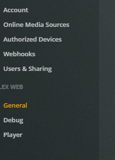

Did you try to claim the server using the token? The correct env variable to use and where to get the token is in the readme.
You're right!  I was challenged by the instructions by Hoopster, as I don't have physical access to the unit.  This morning, I downloaded the official app once again, and this time, the field there that talks about claiming something makes more sense.  True enough, after putting in the token, it worked!
Thank you saarg.
Good!  Glad you got it worked out.  Your "No Soup for You" post and follow up post made it sound like you were unable to enter the token and were stuck at that message so I found a post about that situation in the Plex forums.
Personally, I had no idea if that would be a solution as it is nothing I ever needed to do.  Nevertheless, thanks to Saarg, you found a way to enter the token and are up an running so that is what counts.
Thanks also Hoopster!  I had a backup solution if what I tried really didn't pan out :D. Go to the physical server, and do what the post suggested :D
