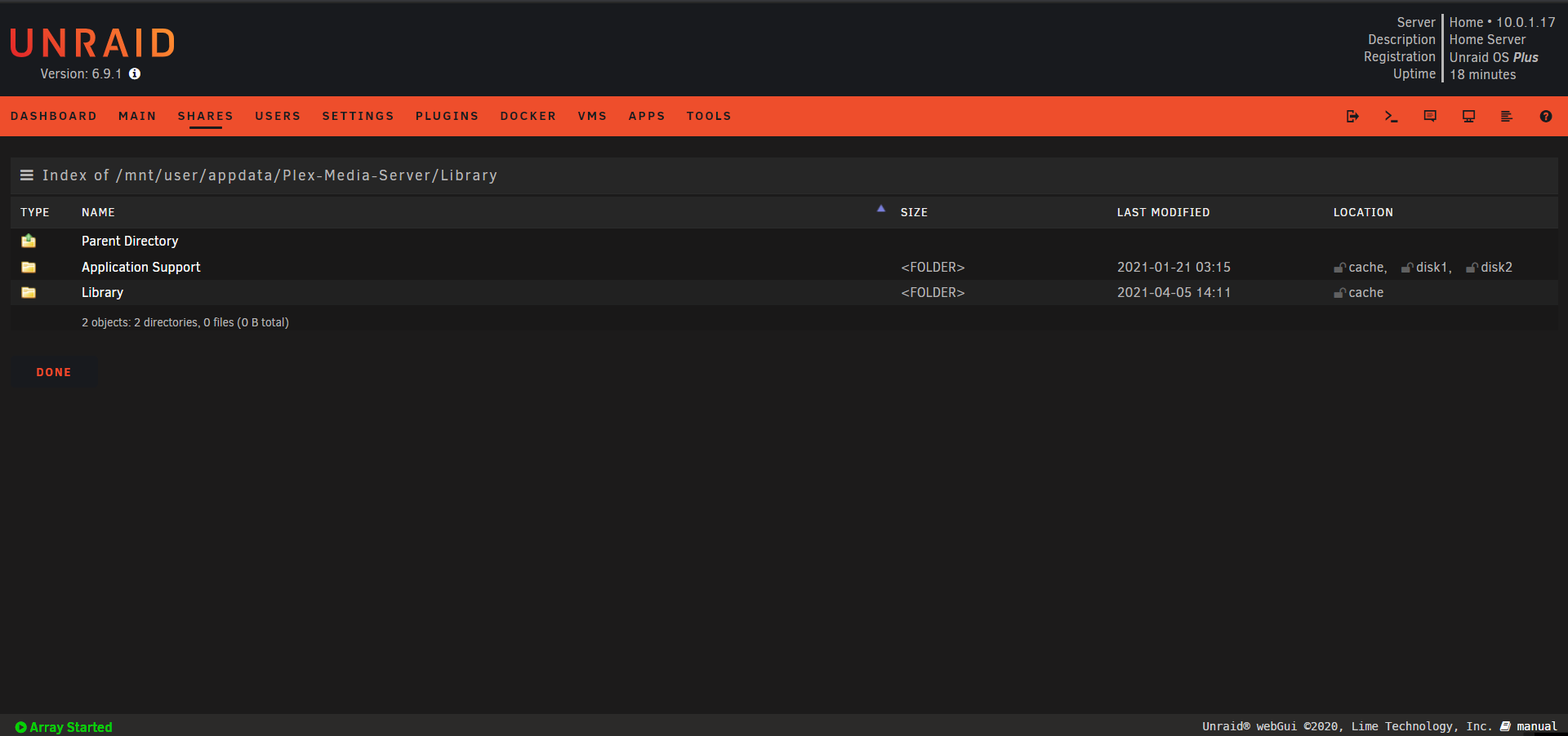

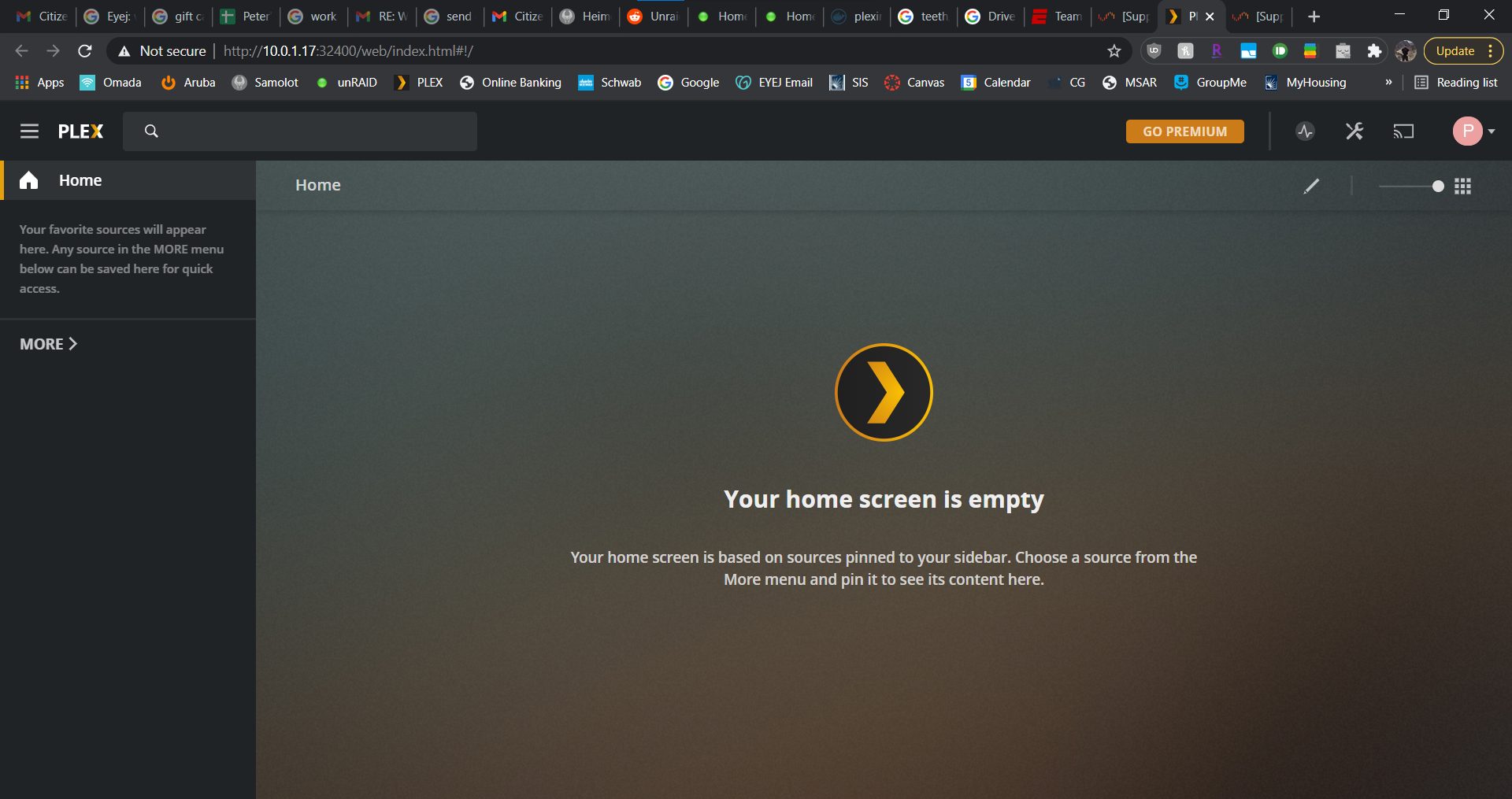

So this is probably a silly issue, but I changed the config path from /mnt/user/appdata/Plex-Media-Server to /mnt/cache/appdata/Plex-Media-Server. However, I realized that I had installed and set up Plex before I got my cache drive, so some of the appdata files for Plex are still on my array rather than the cache drive. So, I changed the path back to /mnt/user/appdata/Plex-Media-Server, restarted the container and my server. However, I'm given a blank page on my home screen, so it's obviously not picking up on the original appdata. All the original data is still there, so what should I do to fix it? In the 2nd picture you can see the folder with the original data, and it looks like a second folder got created when I made the change.
When reading files on user shares when there are duplicates on other disks, the "lowest" disks are accessed, and cache is lower than any array disk. So if Plex created files on cache then it is seeing those instead.

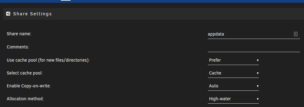

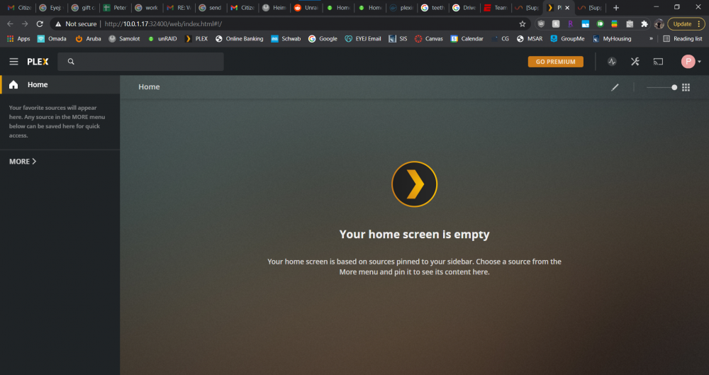

Got it, to try and fix the issue I set my appdata user share to "prefer," invoked the mover (which transferred the majority of the Plex files from my array to the cache drive), and then I used krusader to transfer the few files that were left. Howevever, even after I did this and changed the path back to /mnt/user, I'm still running into the same issue.
52 minutes ago, AlphaOmegaKappa said:
same issue
Post diagnostics and docker run for plex
