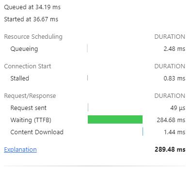

I'm using plex on docker for the first time and I'm not having the same performance (very nitpicky, more below) as before when I used Plex Server directly from my windows server.
More information that might be revelant about the servers:
- Both Servers are using a NVMe SSD for the metadata (docker server has a faster NVMe SSD (enterprise vs consumer))
- Regarding the CPUs, docker server has 2xE5-2680 v4, windows server has a i7 4790k
- Both servers have the same content to be displayed on the libraries.
- Both servers are on the same network, connected to the same switch.
I measure the response time it takes on the unraid docker instance to load completely all images in one library with Chrome network tools and this is the response time from my old plex server loading one library (in red is the analytics events that are blocked by adblocker, ignore those):
Now the same library but accessing my plex docker instance instead:
More details on the 287ms request, we can see the webpage is waiting for the response from the server:
Why is this much difference between servers (10x more, but sometimes it spikes even higher) I know I'm being nitpicky here, but I wonder if there's anything else I can do to match the performance I had before.
I tried to use bridge mode on the docker plex server but it didn't make any difference.
EDIT: I found out this post by @mgutt so I tried it out the direct access tweak, changed my appdata config folder path on plex docker config (/mnt/user/appdata/plex) to (/mnt/cache/appdata/plex) and now the performance matches my old server! I'll leave this post here in case anyone finds the same "issue"

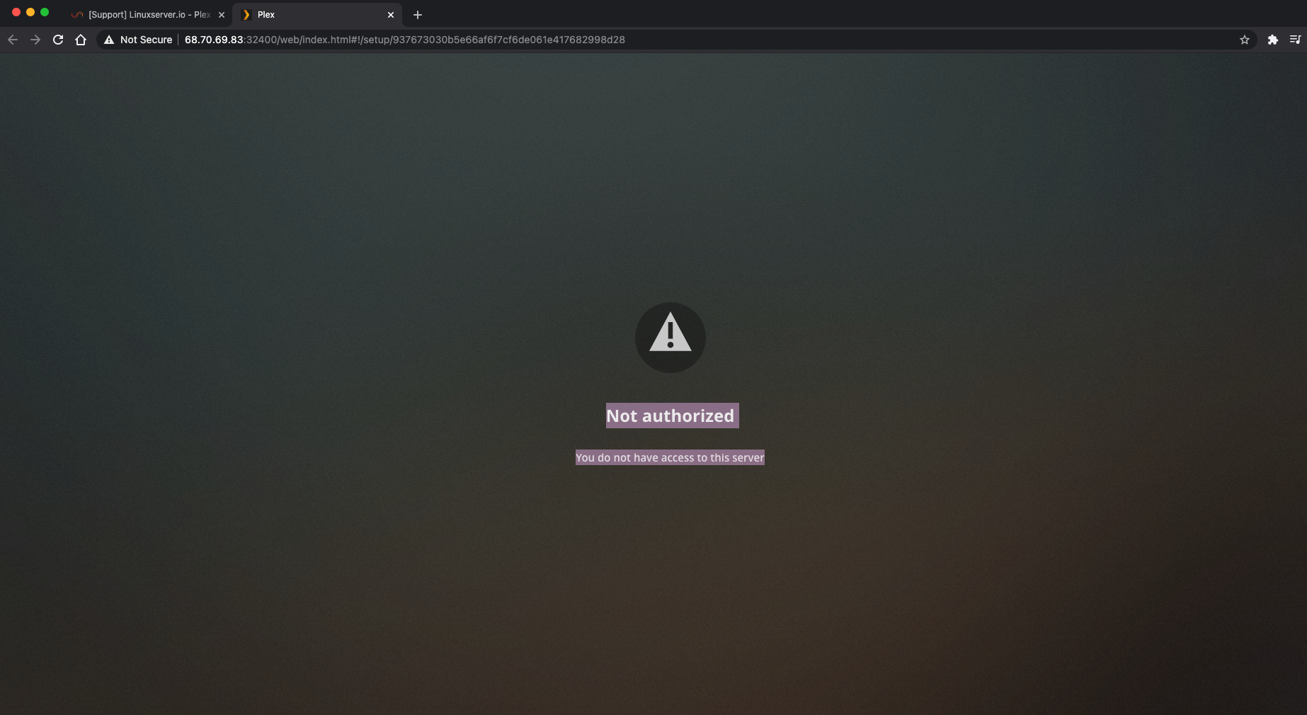

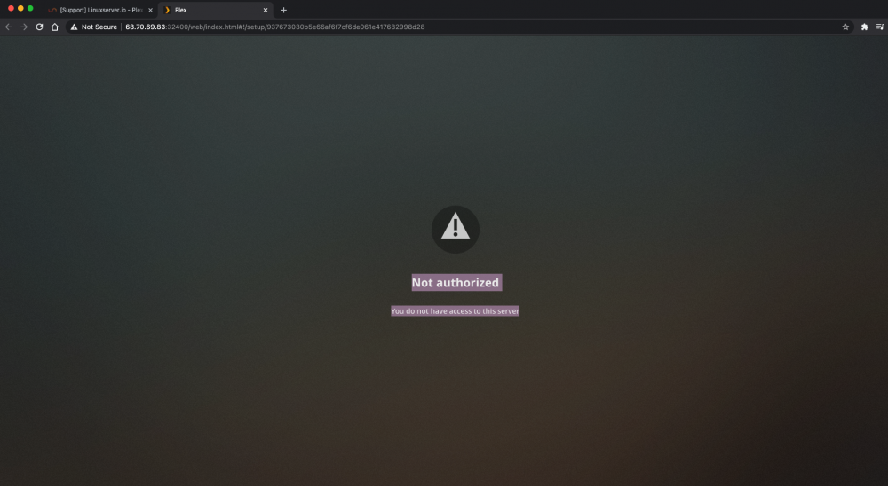

I recently changed my routers IP from 192.168.1.1 to a random IP and started running into this odd error. I've reinstalled a couple of times and after each time, I land on a page with the following error:
"Not authorized
You do not have access to this server"
I attached a screenshot here.
I'm a total UnRaid noob and am sure I'm missing something here, but I just do know what.
Has anyone seen this before?

1 hour ago, happyfuntime said:
I recently changed my routers IP from 192.168.1.1 to a random IP.......
Are you using DHCP for your plex with remote acces or internally only? Don't recommend DHCP because of portforwarding. Plex really needs 32400 (if not manually changed)
I'm trying to access internally. My router is set to DHCP, but I reserved the server's IP and opened port 32400 to no avail. I'm still seeing the error.
EDIT: I pulled up the logs and see this error repeating about a billion times:
ErrorWarningSystemArrayLogin
Starting Plex Media Server.
Error: Unable to set up server: listen: Address in use (N5boost10wrapexceptINS_6system12system_errorEEE)
Edited by happyfuntime
6 hours ago, happyfuntime said:
to a random IP
How random? Only certain ranges are allowed for private LAN.
I set the router's IP to 68.70.69.1 and my server is in the range. I changed the network type at those aforementioned errors went away. I've already spent about 12 hours researching this and am going to reinstall from scratch.
Do you own that IP? Looks like that IP is owned by an internet service in Kansas.
and that IP you used is not in the allowed ranges:
https://en.wikipedia.org/wiki/Private_network
Change your router's IP back to 192.168.1.1 and DHCP range back to 192.168.1.[100-255].  This will solve your problems.  You can't just pick any random internal IP for your router.
Once you're back online, check the Wikipedia article posted by @trurl, specifically the section on Private IPv4 Addresses.  This has details on the ranges you CAN use for your internal network:  https://en.wikipedia.org/wiki/Private_network.
So, you're totally right. I did that just moments ago and BOOM. It works!
Thanks so much for your help!

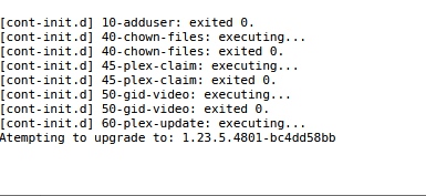

  • I've tried the "public" and "latest" versions but I get this error in logs:
    • # Upgrade attempt failed, this could be because either #
      # plex update site is down, local network issues, or #
      # you were trying to get a version that simply doesn't #
      # exist, check over the VERSION variable thoroughly & #
      # correct it or try again later. #

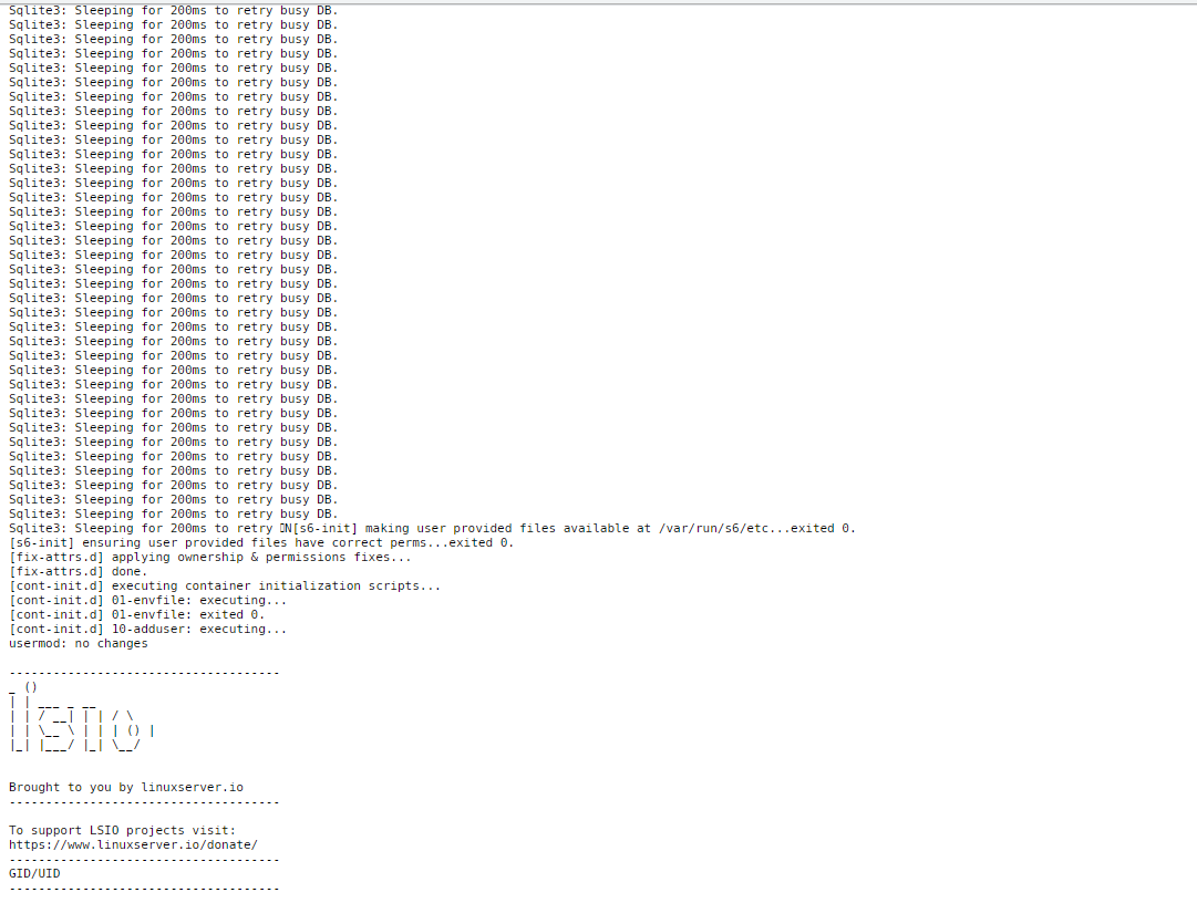

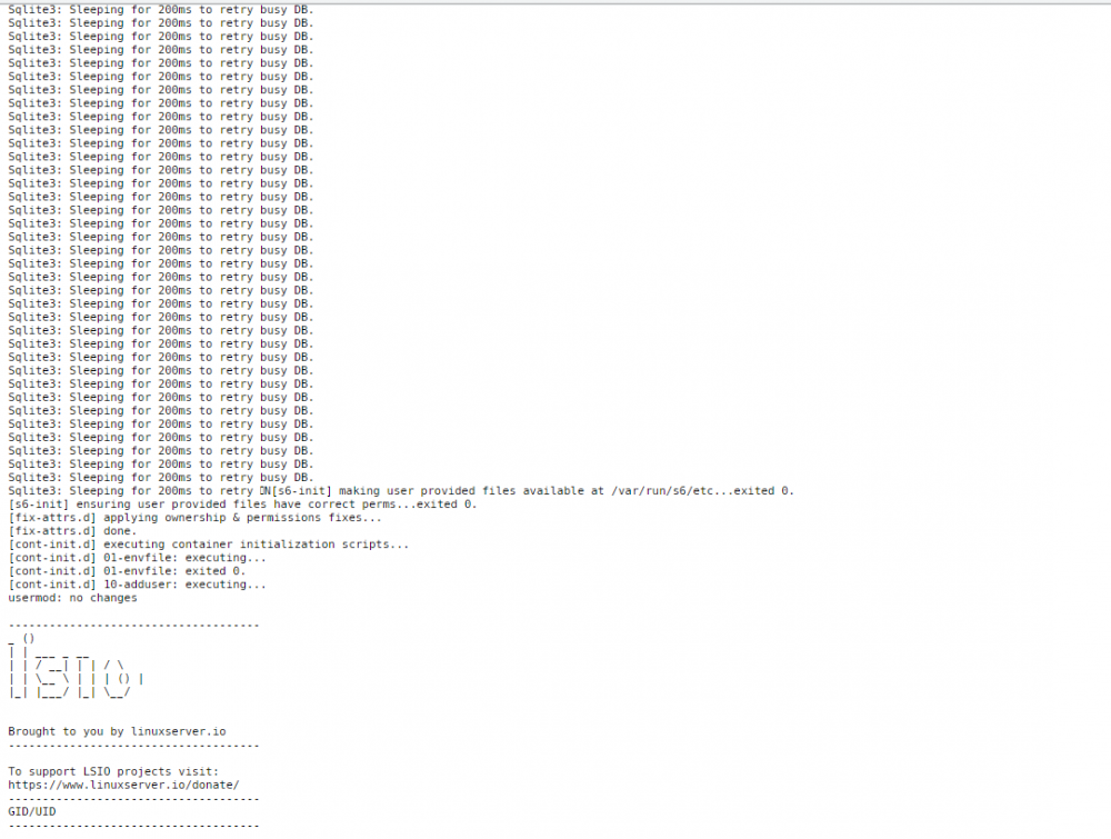

Any ideas on the below?
I have googled a bit and it is suggested sqlite3 is not fit for large libraries, I am pretty sure mine is small in comparison to others. I also saw not much help or resolution on this. I have yet to try the increase default cache size suggestion but my configs/cache is running on a parity raid 1tb M.2 SSD setup so speed is not the issue.
This happened a while ago but has been fine for a couple months, now I have had it twice in 2 days. I have optimised the db and turned of automatic library scan.
Any other suggestions or an actual fix?
My whole Unraid setup is only 6months old so I would like to think it is not an aging issue heh.

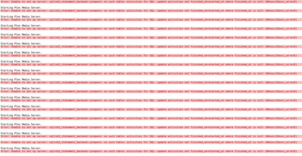

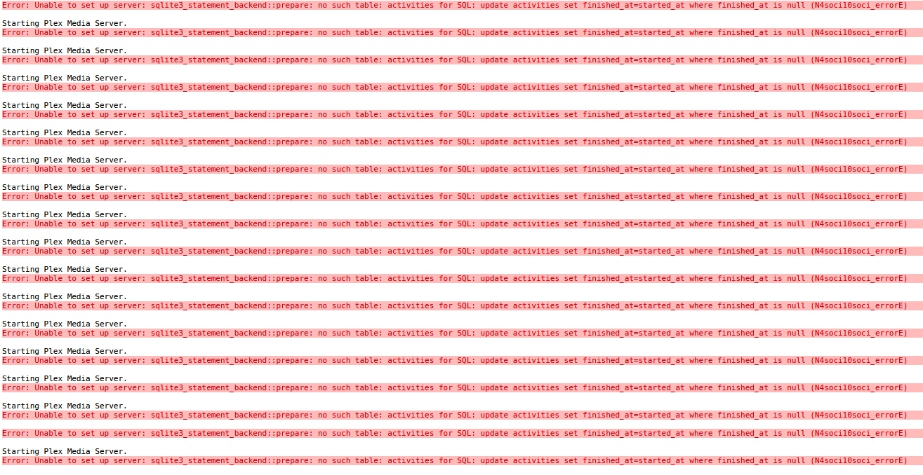

Im getting SQL errors in the plex log (attached image) Have tried rolling back to a backup I took 2 days ago, and Plex was working perfectly after that up until a few hours ago. We had this exact same issue about a month ago and changing the plex docker from this linux server one to the official plex one fixed it, but its happening again.
Im finding it hard to believe its really a database issue as im rolling back to a database that worked perfectly fine, but im all out of ideas.
Any assistance would be much appreciated.
Edited by Gracey400
@Gracey400 I am getting the same error. Sat down to watch some plex and my server was offline. Seems like it has appeared with the latest update. My docker container is saying it was "created" 1 day ago.
Maybe a problem with your system beyond just this container. Is everything else working?
I tried the binhex container and copied my config across and I get the same error so it seems like it is not an issue with the latest linuxserver.io update. Either my system is having issues or my database is corrupt.
I downgraded my linuxserver docker to amd64-version-1.23.3.4707-ebb5fe9f3 (previous version) and it is now working perfectly...
